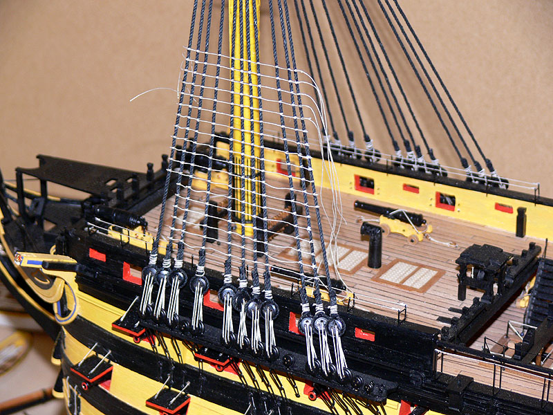

hi steve,take a look at jokita's build of the vic.http://www.jotika-ltd.com/KitPics/LRG/Victory_Const95_lrg.jpg

Hi Stevie.
Try this view, it looks like a single eye bolt fore and aft with a block and tackle between the eye bolts on the front and back of the carriage to the deck bolts tied off like the knightshead tackles on the bow. The criss cross rope over the top of the barrel seems to go through the recoil tackle rings on the carriage.
#5 Posted : 18 December 2013 22:05:04
Thankyou Robin, the blocks on there look very neat, maybe the kit supplied ones were 2mm. Im thinking I may go for this look but minus the blocks as I only have 4mm. It will still look a lot better than nothing at allBigGrin
