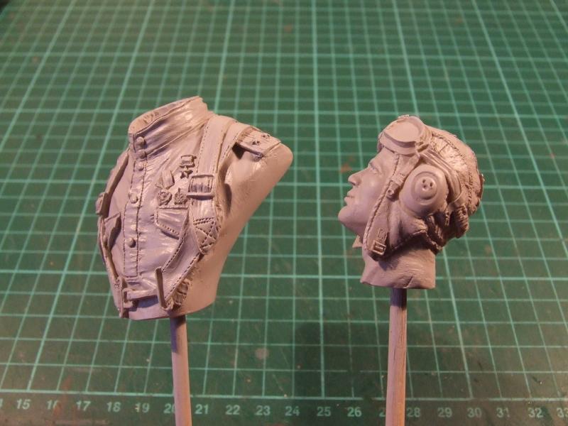

As this is only a two piece kit, there will be very little assembly other than a little clean-up after removal of the casting blocks and as such this will be more of a progress report on the painting process than anything else. You can see the quality of the resin castings in the photos below.

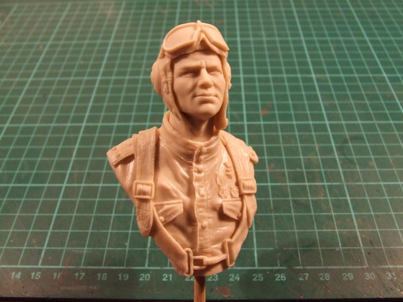

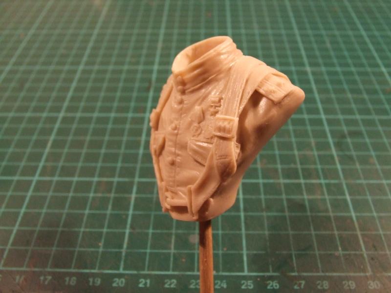

I haven’t had much modelling time this last week or so, as I’ve been very busy with other things, but finally managed to make a start on preparing this bust for the painting process. First job was to remove the casting blocks from each part and then I spent several hours cleaning up any errant flash and imperfections from the moulding process and I also deepened a few recesses behind things like the parachute harness straps and the pockets and shoulder-boards using the fine tip of a #10A scalpel blade just to give these areas a little more definition. When I was happy with the detail clean up, I reshaped the lower part of the rear of the main torso and drilled a hole in the underside of each part.

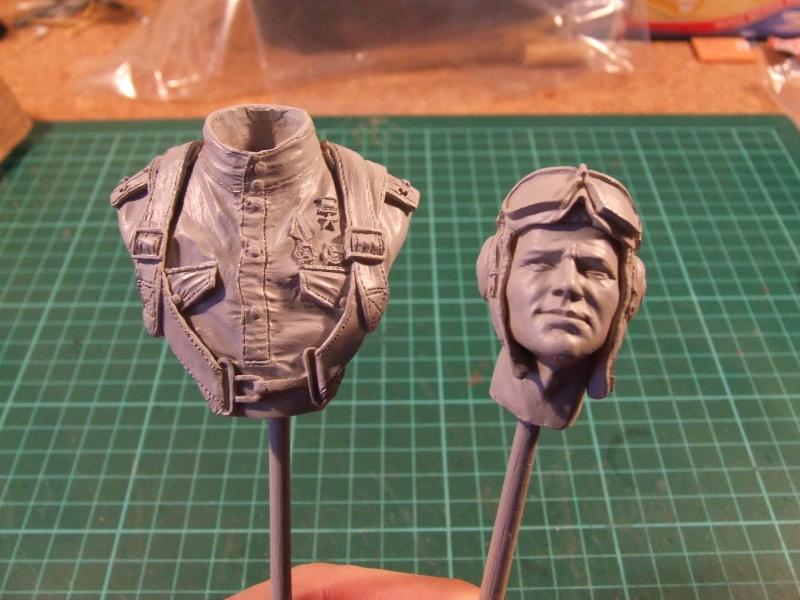

Photos 1-3 show the two kit parts before removal of the casting blocks (quite a prominent seam down the back of both parts!), then after clean-up and having had a hole drilled on the underside to facilitate the fitting of a handle.
It is easier to paint things like figures and busts if you don’t have to handle the parts with your fingers so I made two ‘control sticks’ out of the ends of some of my old artist's ‘hog’ paintbrush handles. These sit in the palm of your hand nicely and are long enough to be able to rest the ball of your hand on the bench whilst painting finer details and will ultimately help prevent any shaking? I won’t be gluing the two parts of the bust together until painting is completed as it makes things much easier when trying to get down inside the collar and when painting the various skin tones around the neck? You can see my two ‘control sticks’ in photos 4-8 below, and a quick shot of how the bust looks when the head is united with the torso can be seen in photo 9.

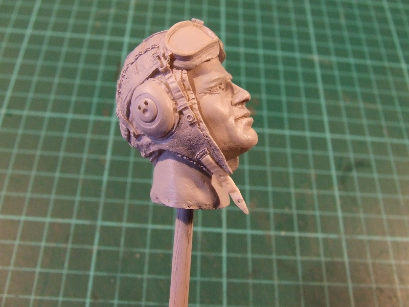

It was at this point that I noticed there was no ‘chin strap’ for the right (left as you look at it) side of his flying helmet, which seemed odd as there is a buckle on the opposite side? I checked the photos of this bust on Mitches’ website and it clearly shows a strap! After phoning Mitch (real name Ross Mitchell) he said that this should indeed be a three piece kit with separate strap included. I am now waiting for the missing strap to arrive!! You can clearly see the missing strap in the black and white photo #10 below.
Next job was to give the parts a final check over before a quick wash in soapy water and then left to dry naturally in a warm place. They were then given several thin coats of Tamiya ‘Light Grey’ Fine Surface Primer. A lot of figure painters suggest that white primer is best, as it gives a nice bright background to the paint but I prefer a light grey as it is a ‘mid-tone’ and also accentuates the high and low points of the detail including any shadows which helps in the painting process when you are laying down the shadows and highlights of the base colours? The last 3 photos below show the parts after priming. Note the accentuated detail that comes from using a grey primer instead of white? Much better definition.

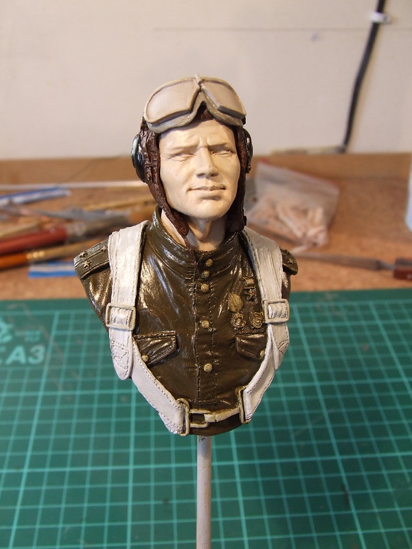

I haven’t had much modelling time this last week or so, as I’ve been very busy with other things, but I've finally managed to make a start on laying down the base colours for this bust. The missing chin strap for the flying helmet arrived and was duly cleaned up and glued in place with 5 minute epoxy and allowed to dry for 24 hours. It can be seen added to the head in photo #1 below. All of the base colours have been done using Winsor & Newton ‘Alkyd’ oils and at the moment things are looking very shiny, but once I have finished all of the toning and blending, I will bring all of that glossiness back down with a coat of matt varnish. The parachute harness looks very white in the photos but I have actually painted it with a very pale grey tint though the camera can’t seem to pick this up. They were very white in reality, much paler than say the British or American equivalents, but I’ll be adding some subtle shading and detail washes to them as I go and hopefully the camera will pick it up more then. All of the metallic parts such as buttons, medals and buckles on this figure will be done at the final stage, as will the lenses of the goggles, as I need to paint in some suggestions of reflections which will then be clear coated to hopefully give the illusion of glass where there isn't any!! The face has just had a thin base coat of a very pale skin tone for now, which needs to be on first before I start adding darker tones at the next stage – I’ll explain why in more detail next time. All of the colours used so far have been custom mixed by myself. All of the base colours have been painted in and it's all a bit shiny at the moment as I said earlier, but that's just the nature of oil paints, I’ll sort that out later in the build with some matt or satin varnish.
I'm quite pleased with the way the leather flying helmet has turned out so far though not finished yet, but it does look like brown leather already and was achieved by brushing on a fairly thin coat of the brown paint and then just lightly dragging another brush which was slightly dampened with thinner across the surface to remove some of the paint from the high spots and leave the undercoat showing through to give a worn leather look? I've added a few shots below of the whole bust with the head just loosely balanced in place – it won’t be glued on permanently until all of the painting is completed.
