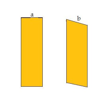

Mornin all. Can anyone tell me if this is a bad idea.
After shaping and bending the planks to the desired effect. Is it a bad idea to shave off up to 45degrees on the backside of the plank. top and bottom to make the join seamless. So instead of of rectangular shaped plank( looking down the length) its now a parallelogram. Laying on top of each other would make it 'lock' into position. Maybe buying new planks that were 1mm wider to compensate for the loss of material on the floor. Or is this just far too much work to bother with.

piot,have a look at my victory build,and have a look at my joints,is that what you mean?all the strakes on my build have 45degree joins,when these are sanded down,they become almost invisible.

Excellent example and illustration Chris!!!! nicely done! BigGrin
It does seem like over-engineering in the areas where the planks lay flat anyway.
