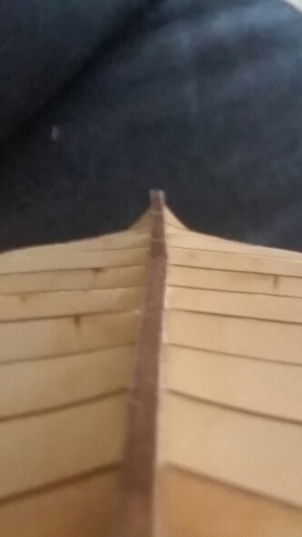

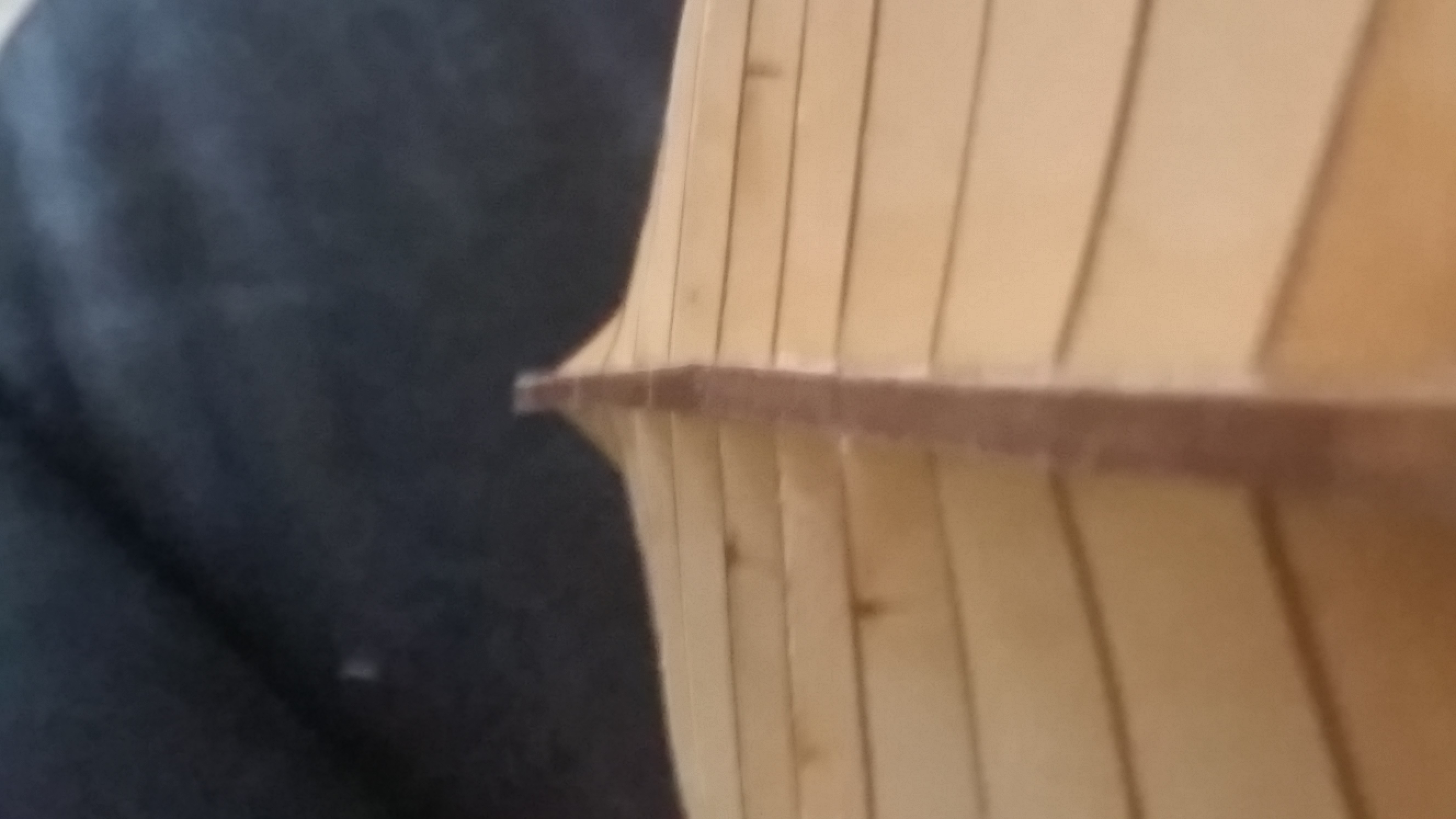

Just decided I'd try start fairing and realised I have a kink in the false keelMad
Everything is obviously glued solid so what choices do I have please? Crying

Hi Alan.
There aren't too many options on this but, what you can do is use balsa infills between the ribs to get the correct gaps each side, which would twist the keel back.
Chris BigGrin
#3 Posted : 25 April 2016 19:06:56
Hi Alan, you can try putting the keel in a dry dock/jig. Use of a jig may allow the keel to be held straight and true until the first few rows of planking have been applied on both sides. If the jig does straighten her up then do not take her out of the jig until some rows of planks have been fitted.
I would not attempt to build this kit without the use of a jig, it is really important the keel is straight and true otherwise you could run into problems further into your build.
Hope this helps and if you need to come back to us then please do. Also, if you can resize your pics to 600x480 pixels then they will show up on your diary rather than members have to download them.
Hope this helps and good luck with her...
