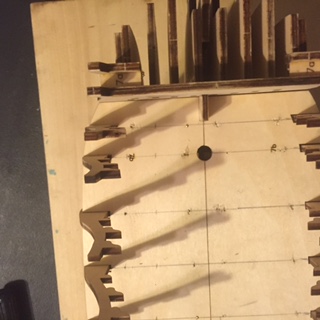

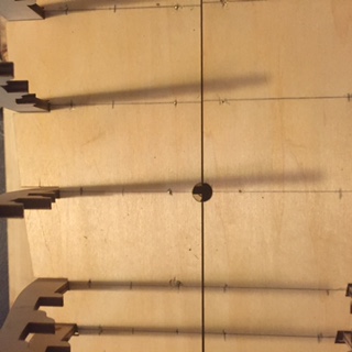

ronald305 attached the following image(s):
ronald305
#7 Posted : 08 May 2016 17:51:00
Joined: 08/02/2015
Posts: 426
Points: 1,259
Location: Louisiana
ronald305 wrote:
these are photos of the deck with the mast hole straight what you think Alan
Ronald

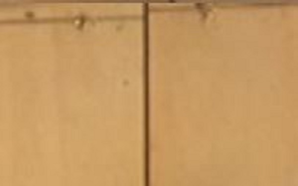

#10 Posted : 09 May 2016 18:47:31

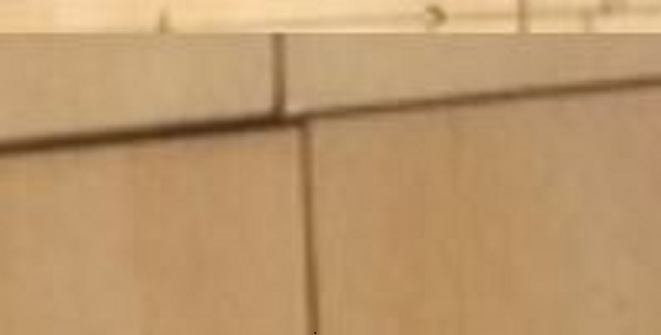

Hi Ronald, I’ve been having a much closer look at your pics and actually zoomed in on them. To be honest I think you may still have an alignment problem. The first pic shows the join between the 4 deck sections to be off by quite a lot. These 4 section need to meet exactly on the centre of the keel, and the deck sections need to meet in the middle of the forward and stern bulkheads.
The second pic appears to show the keel running down the right side of the mast hole instead of down the middle.

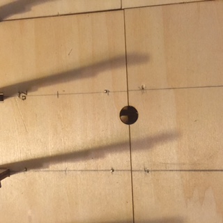

The third pic again shows the 4 deck sections are not matching up correctly

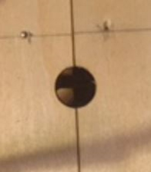

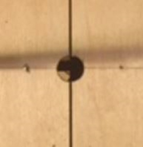

The final pic also appears to show the keel running down the right side of the mast hole rather than in the middle.
You need to look at this and confirm for yourself that all 4 deck sections meet exactly in the middle of the keel. If they do and you haven’t had to force anything then the mast holes should line up exactly.
If the deck sections don’t line up as described then this is a good indication of alignment problems with the keel not being and straight and possibly the ribs not being fitted fully square on all planes.
Take a look at the 5th picture down on the official build, you will see how all 4 deck sections line up exactly where they join and run down the middle from bow to stern.
It may just be the photo angles that are making it appear that the keel is running down the right side of the holes, only you can determine whether they are true or not. Would advise you take another close look to be sure as this really is one of the most critical parts of the build. I know this is not what you want to hear but I can only advise on what I see.
