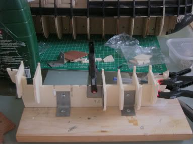

ok sorted it out and made a start.plans are a little vague but i am sure i will get there..anyway i have put her in a jig and installed the ribs

next is the decks and the start of the first planking she is double planked so any mistakes can be sorted

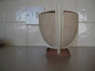

hi jack first impressions are not that good but i am determined to get this one spot on..the ribs are not cut properly so i had some packing and shaping to do to get both sides the same

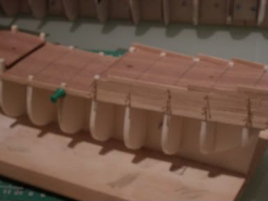

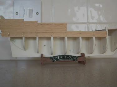

i have built the stand and added more first planks

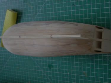

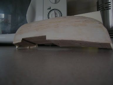

i decided to add balsa fillers to the bow
cheers benny

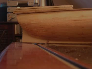

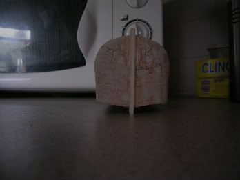

now the first planking..this is a mamoli build and i am pleased to say.thank god its double planked,what a nightmare.. as you can see i added darker planks and also extra planks from my other builds leftovers, the planks supplied did about 2 thirds and i used every piece apart from a few inch long off cuts..not good,anyway in the end all i was interested in was getting it planked,not pretty but its even both sides..i have covered it in 2 part filler and sanded it down and i now have a very good base for final planking totally even and sound ,this wont be painted or stained just oiled

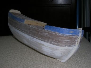

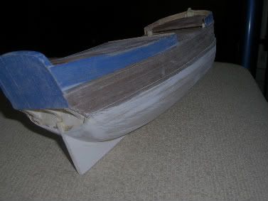

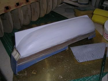

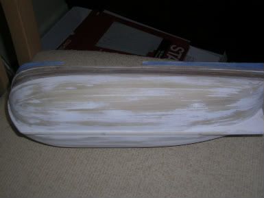

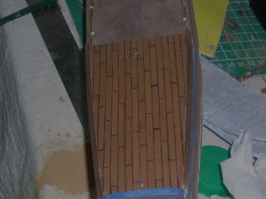

i have now second planked the hull and as i am now painting i have filled with 2 part filler and given it a good sand down and filled again with fine filler, with that sanded i have given it a coat of white paint to show up any imperfections that need sorting

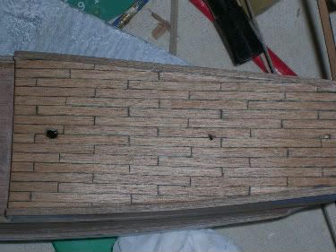

i have planked the top deck using the 3 plank stagger and gave it a coat of oil
