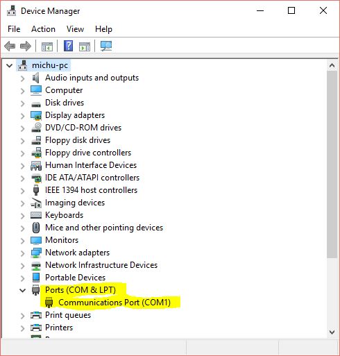

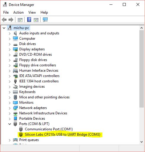

mjhendren wrote:
Sounds good. Thanks for your help. I'm waiting on a replacement part as well, so don't stress about it. :)
No worries, we will crack it. First, make sure you got and installed the driver from this link: http://download.cnet.com....html?hlndr=1&dlm=0 - don't connect the cable just yet while you're doing this.
Then open your Device Manager and the ports list should look like on the first image below.
After connecting the cable, a new device should show up named Silicon Labs CP210x USB to UART Bridge (COM3) - see second picture below.
Let me know if you can get to this stage.
Cheers,
Michu
