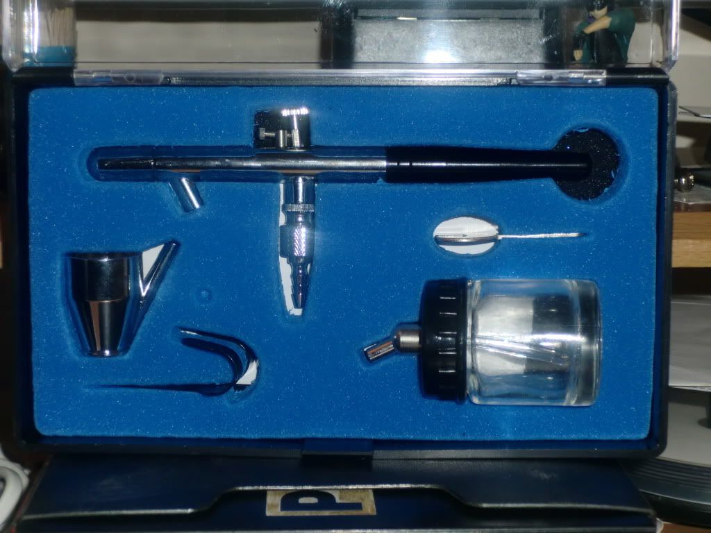

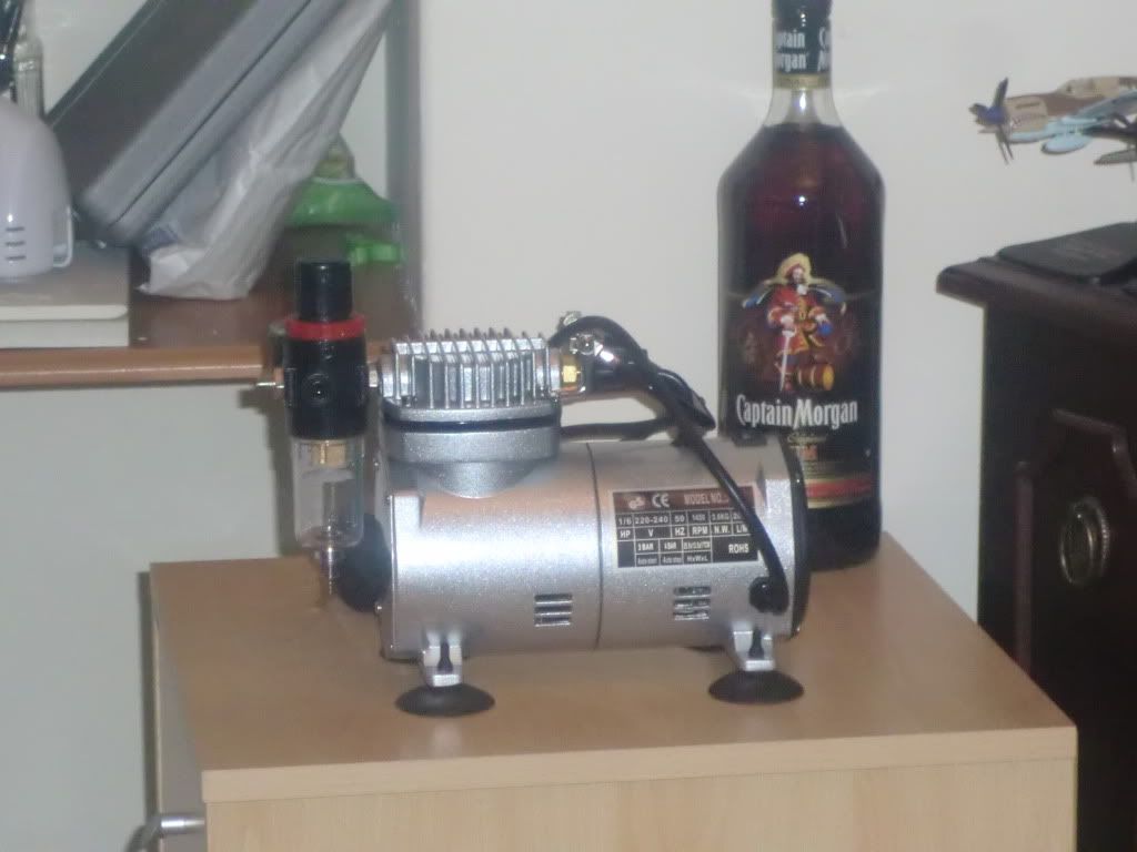

#1 Posted : 11 January 2011 18:20:58
Aren't fathers sleekit!!!!
I was discussing with him about buying an airbrush kit for my model and he said to wait til after christmas and he would help buy it.
What was delivered this afternoon?

#2 Posted : 11 January 2011 18:52:16
I have the same kit!! And it gives a great finish too!!!BigGrin BigGrin
