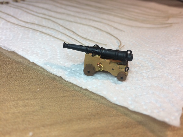

Preparing the guns:

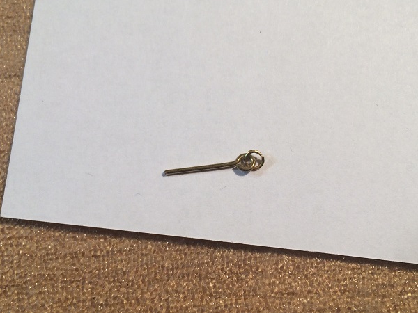

Drill an additional hole for the breeching rope guide (0,7mm)
Then connect an 3mm brass ring with a 2mm eyebolt and glue it into the hole you just drilled.

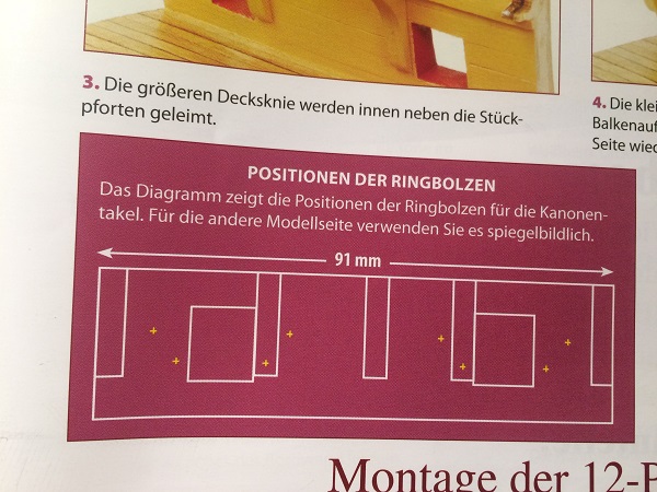

Preparing the hull:
Regarding the positioning of the holes i went with the instructions of the cross-section:
The upper ones about 11mm from the bottom of the gun port and 6mm to the side, the lower ones 5mm and 4mm respectively. I used a 0,8 drill.

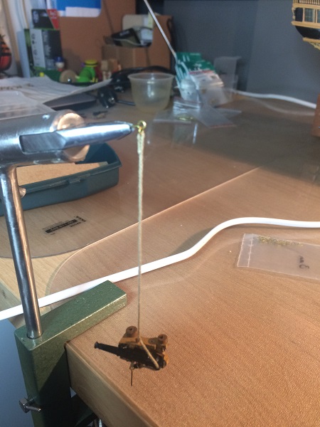

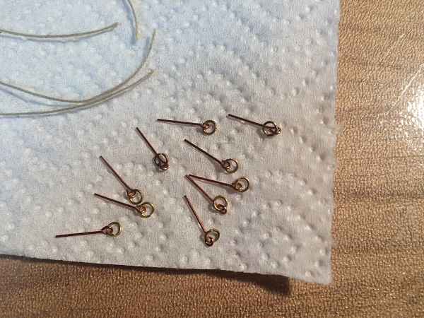

Making the breeching ropes:
For the breeching ropes i used good quality 0,75mm thread.
First i attached a 3mm brass ring to a 3mm eyebolt and clamped it into my mini-vice (fishermen use these for making their flies - i bought mine on ebay).
I cut 13cm of thread, threaded it through the brass ring, made a little loop and secured it with super glue.
With the small diameter black thread i made a binding.
Then you have to thread the free end of the breeching rope through the brass ring you previously attached to the gun - then through the little ring on the top of the gun - and finally through the brass ring on the other side.
Then again clamp a 3mm eyebolt in the vice, attach a brass ring and repeat the aforementioned procedure with the second end of the rope.

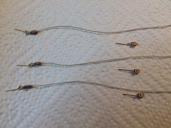

Making the tackles:
First clean all holes of the blocks with a 0,9mm drill.
Put a 2mm eyebolt into the vice. Then cut about 16cm of the 0,25 thread and put it through the eyebolt with an excess lenght of about 4 cm on the other side - then secure it with two knots and a little bit of super glue.
Knot a single-block to the eyebolt - again secure it with super glue and cut the excess length.
For the other end of the tackle (which will be attached to the hull) i used 0,1mm thread.
This time put a 3mm eyebolt into the vice - then knot a double-block to the eyebolt.
Now take the thread attached to the single-block and stiffen the end with some super glue. Then thread the end through the hole of the double-block, which will be nearer to the cannon - next it goes through the hole of the single block - then through the outside hole of the double-block.

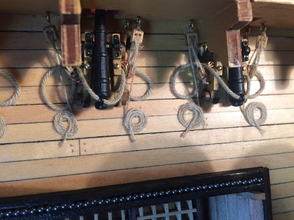

Location: Austria
Adding rope coils:
I don`t know if there were coils in a combat Situation but as you can see in my build log i did not add coils on one side but did so on the other side - and i must admit it looks a lot tidier with the coils.
I just put a stripe of double sided tape on my desk and carefully formed the coils. I covered them with diluted wood glue.
When dry i attached them to the deck putting the cutted thread from the tackles under the coil.
So that`s the end of this tutorial - i hope you enjoyed it!
