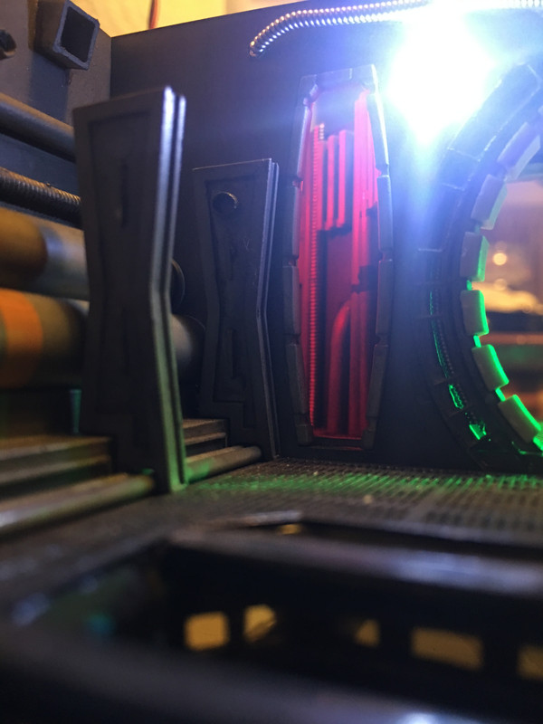

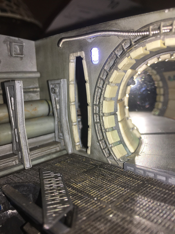

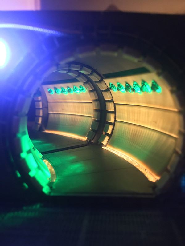

Been working on my corridors in the little me time I’ve had over Christmas, before I add the leds for the wall lights there are a couple of adjustments needed:
1. A little bit of light leakage around the straight corridor’s instrumentation wall to be sorted.
2. After adding the mirrors on the end of the corridors which are approx 4mm thick you can see the led strips under the flooring (must admit I hadn’t considered this, but you live and learn) so will need to blank off the the area under the floor at the mirror end.
A few pics of current progress with ithe corridor being powered from the floor1 output of my board:

Solved my light leak problems using a little bit of black foam sheet I had from hobbycraft for god only knows what, thin malleable and easy to form to correct size and shape saved a lot of cutting and filling:
The tiniest sliver of foam indistinguishable from a build up of dirt in the crevice between the console wall and cushions prevents any light leak
Foam cut to the shape of the underfloor space squeezed in at ends of corridors:

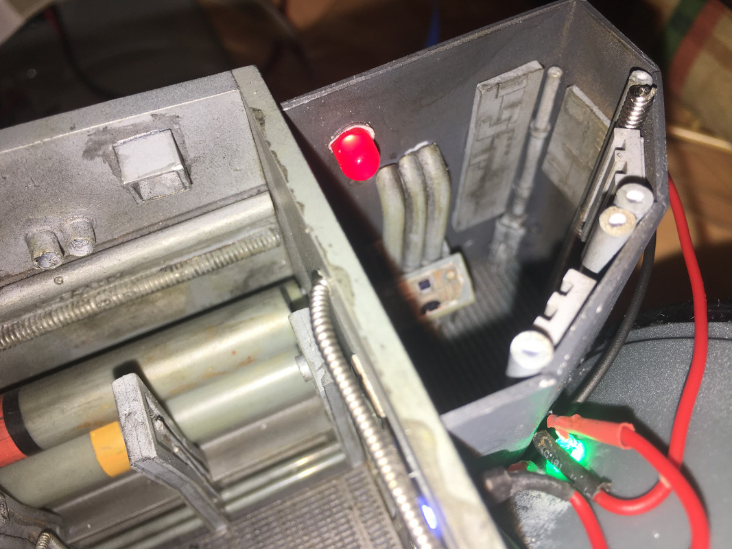

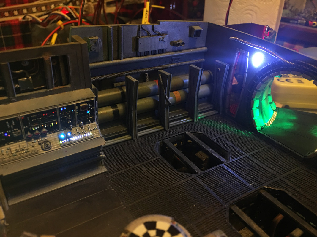

Built my static and flashing LED looms and connected them up to the hold so far, these same lines will provide static and flashing for both the turrets and cockpit too. Powered by 4 of the 12V outputs from my custom controller board the 3 differing flash rates and the static illuminate when applying cockpit power (as they power the cockpit lights), the dejarik table illuminates on activating hold lighting on the remote along with the corridor lighting, and the yet to be wired up bed light, inspection pit lighting and computer room lights.
Pretty happy with the effect so far but may tweak the flash rates in the code for a bit of a faster rate from one of the lines. Need to tidy up the corridor lighting as a bit of bleed through some of the covers and need to touch up the dejarik table as had to put more transparent paint on the fibres as was too white and with my twitches most of it ended up on the tables sides lol.
Here’s a quick video of the hold lighting so far:

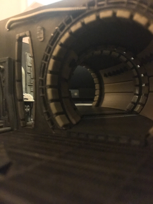

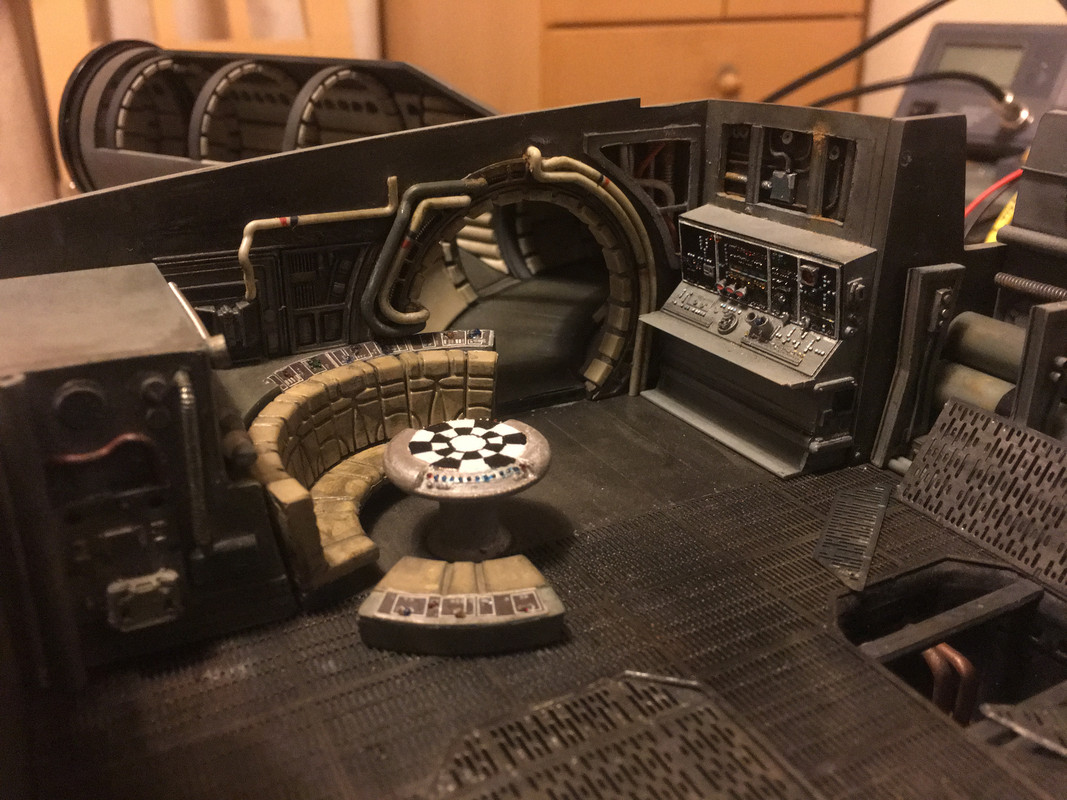

The hold is now approx 95% complete, I had been waiting on a back issue to arrive as I was missing a corridor arch. With that in my possession I set about the port corridor and also the communications room off to its side and the wall light between the two.

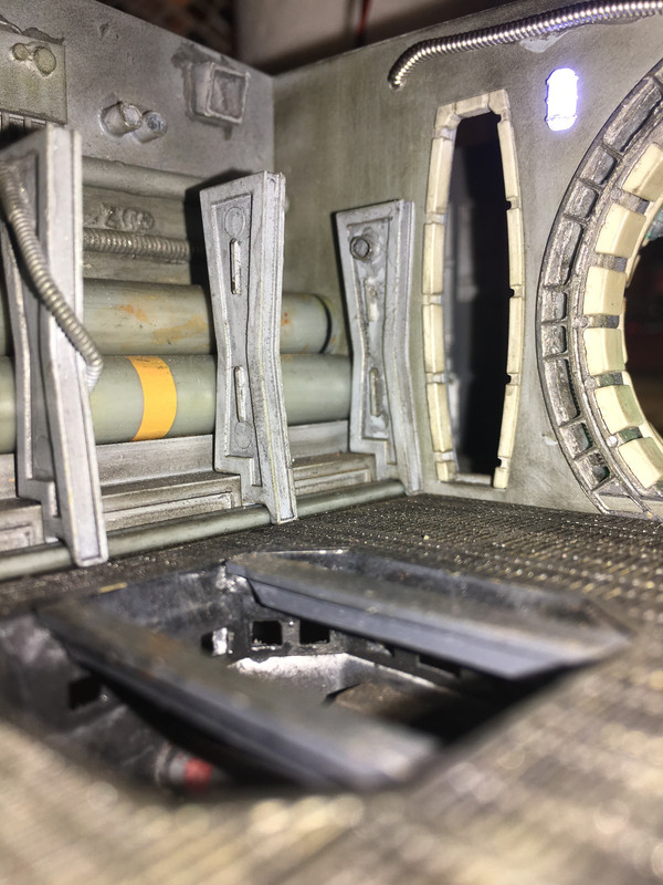

Port Corridor:
Port Corridor Lit:
Comms Room (forgot to take pics during construction):

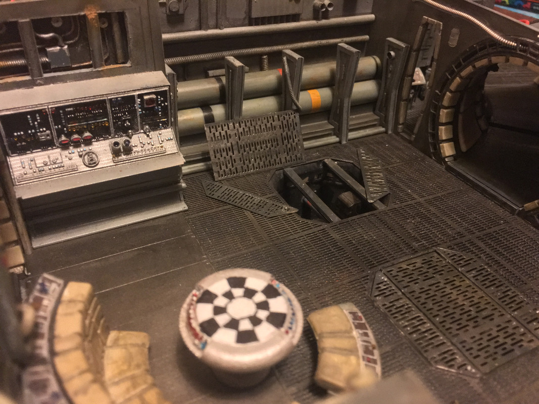

There are a number of touch ups required, the corridor lights are showing a few leaks through the light shades, which were a complete beggar to fit, somebody a damn site more talented than me really needs to make 3D printed corridor cushions with accurate lights built in!
I still have the bed light to wire up, the holds console chair to paint, various cargo pieces and I’m still debating whether to do the forward hull wall pipe and pillars but for now I’m going to put the hold to rest for a little while and start work on the lower hull so I can actually start placing the hold and it’s lighting lines etc.
Various hold pics:

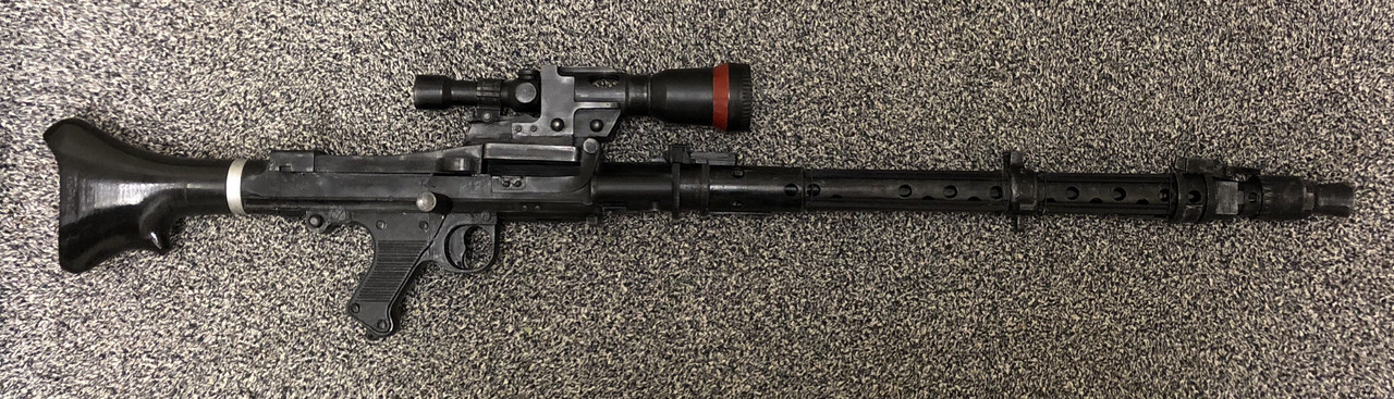

Also designed and 3D printed my Biker Scout DLT-19X Sniper Rifle, I did this so I had something to use as a walking stick if I began to tire during a troop (which is happening more and more often). Again this included full electronics and I decided to try and make a HUD type scope, the reason.... just because really lol. This again was the first DLT-19X with special effects cleared with the UK Garrion 501st Legion:
https://youtu.be/YbB-xKhYxKk

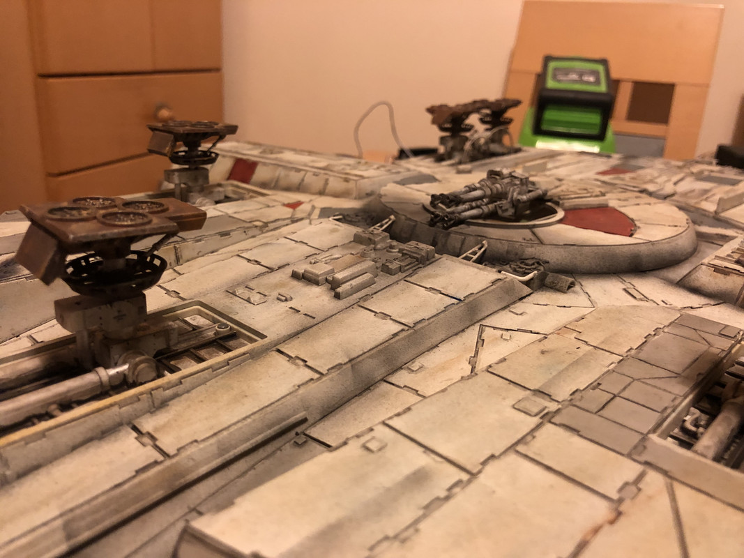

#77 Posted : 15 January 2019 20:11:32
Joined: 15/03/2017
Posts: 46
Points: 138
Location: Outer reaches of the galaxy .... West Midlands

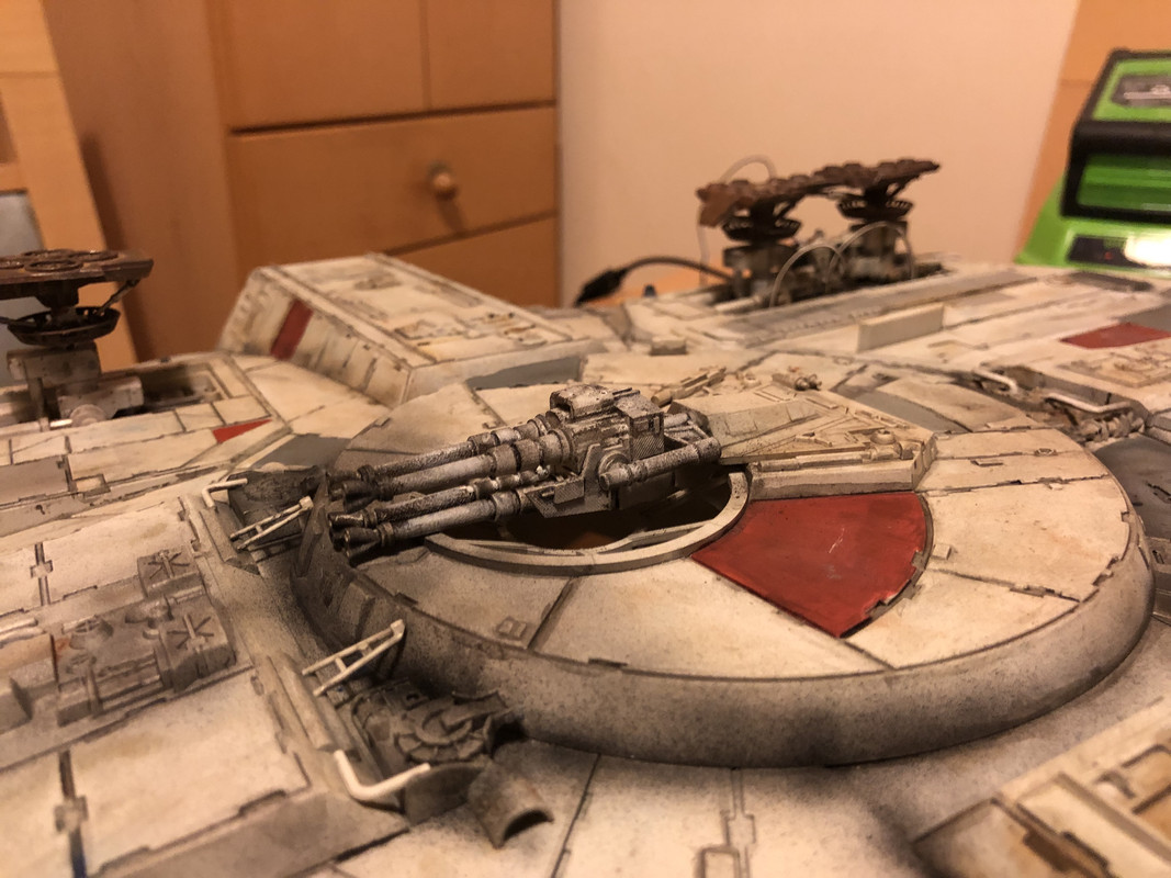

Worked on the undercarriage and the lower cannons pleased it seems to be taking shape, but it really needs some undercarriage doors before I move on to fitting the internals. I plan to install fibre optics into the top cannon only as both firing at same time would look odd.

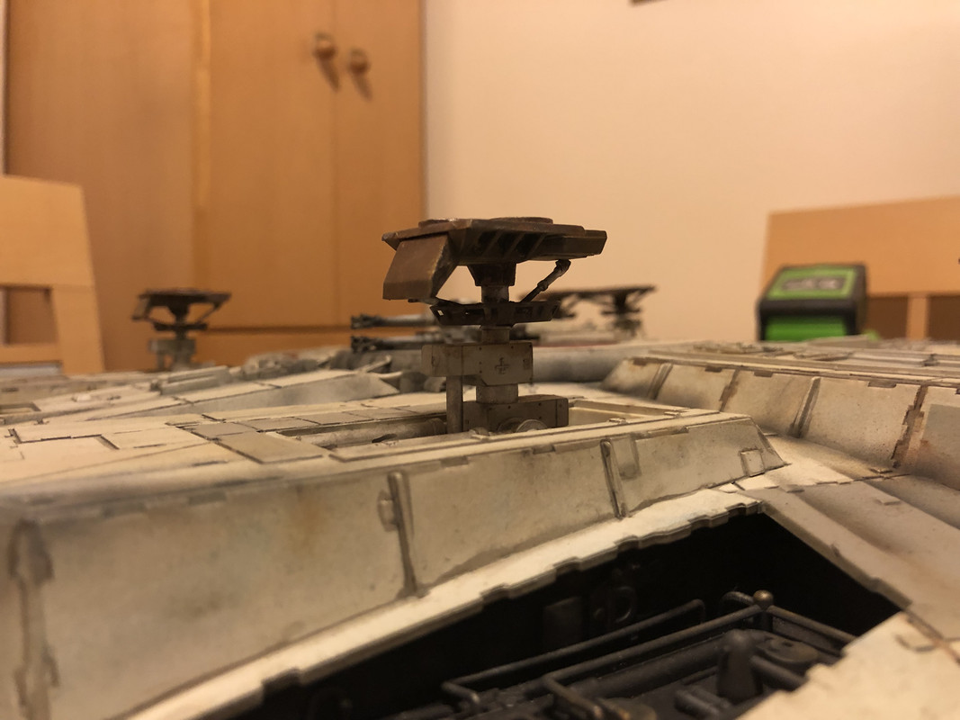

#80 Posted : 20 January 2019 21:56:01
Joined: 15/03/2017
Posts: 46
Points: 138
Undercarriage doors arrived this week, bought from Shapeways through 308Bits who I’ve purchased most of my 3D printed parts from, including the hollow rear legs for passing the power wires through.
Doors painted, panel lined, oil brushed and a bit of weathering powders applied. Glued into place, they make the lower hull look more realistic and love how they illuminate with the landing lights.
I tried to friction fit the lower cannon, but it still droops (very slowly though) with gravity, think I’ll end up blueing it in place, otherwise the ends of the cannon end up touching the floor (or more accurately the table at present Flapper )
