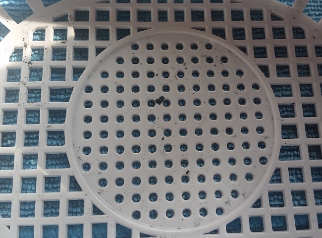

First, I removed the inner tray of the ultrasonic cleaner and this is the residue left on it.

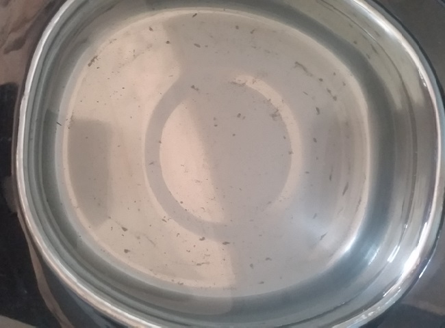

Second, with everything removed from the ultrasonic cleaner the residue is amazing. The inside surface of the ultrasonic cleaner is in as new condition so every black mark is residue from my airbrush. Add that to what was left on the internal tray and you can see what has "NOT" been cleaned out before.

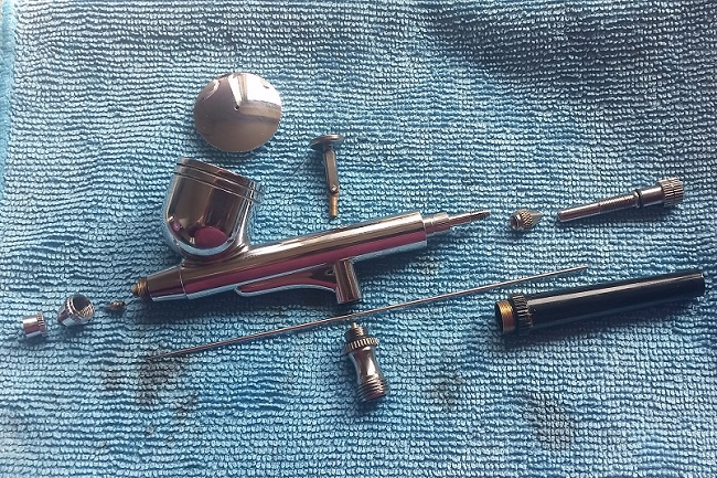

Third, my airbrush now really clean prior to reassembly.
