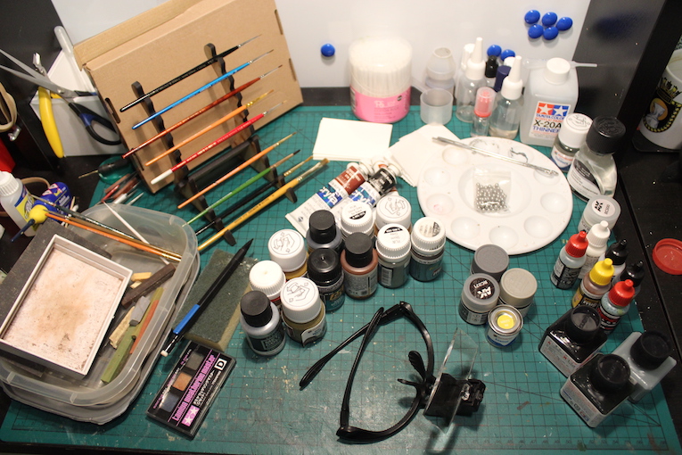

Now at the point of weathering the Hannomag I need to consider the story of the vehicle. The kit has for distant parts which all have a different story and so a different level of weathering.
The A4/V2 rocket needs almost no weathering as they are used not long after building.
the launch stand I imagine is regularly repainted after a few uses so some weathering of the flame deflector and not much else
the trailer used several times but won't be an old piece of equipment some parts see a lot of contact with people other parts nothing, some weathering required
The Hanomag SS100, that could have been in service for some time perhaps being reassigned from the front line or an artillery unit, it could be an aged asset and it sees lots of contact with people, so needs the most weathering.
I dont always know where the weathering is going to take me so I set up to have all possibilities to hand so I have what I need as my thoughts unfold during the process.
I thought it was worth sharing what I pulled together for this task
First a collection of brushes in different sizes for washes, chipping, clear coating and dryprushing.
Assorted thinners, enamel and acrylic turpentine for tube oil paint the small bottle has white spirit for manipulating washes the large dropper bottle distilled water for thinning ready thinned paint and a puppet for ensuring no contamination.
I keep a selection of empty bottles to hand so I can keep a particular paint or was mix if I run out of time before finishing, the large open bottle is filled with water and used for dip cleaning brushes to ensure they don't clog while in use, the scoop will have white spirit in it for the same purpose but for oil based paint.
pallet used for decanting and mixing paint, I keep a bag of mixing balls and always ad one to new paint when first opened, much better than a paint stirrer. I use the paint stirrers if I have any heavy settlements to shift the wide end is great for scraping pastels. the cotton buds for controlling runs etc. the white cards are used for checking paint shading for effectiveness the tissues is used for quick brush drying, removing paint from brushes for dry brushing and emergency mop up!!LOL
I have pulled together a selection of tube paint that I may need, as well as other paints that agin I may need or I know I have to use such as the black and yellow for the convoy triangle.
I have two options for matt varnish I will test both and decide which gives the finish I prefer for this job.
I have the full range of Tamiya panel line accent, these have applicator brushes in the lid, effectively a pre mixed wash they do save time.
I am a big fan of the Vallejo metal color range, the chrome is great for mirrors etc and the burnt iron makes for a good worn metal finish.
I have an ever growing collection of washes and filters, I selected the likely candidates.
I have a small selection of pastels and weathering powder, the sponge and worn brushes are only used for applying powder never for paint.
The humble pencil is great for metabolising detail such as worn footplates.
so we are ready to add some depth to the final model.
