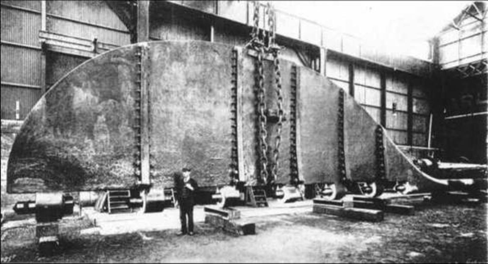

Next I have turned my attention to the rudder, the kit part is correct in shape and size but the ribs are not and when considering primary evidence the rounded off edge does not look right either.
The kit part appears to copy the rudder after fabrication but prior to fitting and importantly prior to the ribs being sealed in cement.
see pictures below
https://vignette.wikia.n...atest?cb=20160224090515
these pictures show the rudder fitted
http://onebigphoto.com/t...er-and-propellers-1912/
https://www.pinterest.co...pin/168322104796625590/
https://commons.wikimedi..._TITANIC_in_drydock.png
I decided it was best to totally scratch build the rudder. Fortunately I have some very thick white plastic card the happened to be spot on for width. The shape was traced, cut out, filed and sanded down to shape. The finished rudder was placed on the hahn plans to mark out the positions of the ribs. it shows that the kit have oneposition slightly wrong.
The ribs are made from plastic strip sanded to shape. whats important is to note the thick end of the rib at the stern post, this is shaped to form a stop.
Pictures of Hahn plans shown by kind permission.

the rudder is nearly done. the other 9 ribs are all compared to the first to ensure they are as close to it as possible.
The alignment is checked against the lines on the cutting matt. to make all the ribs took about 3 hours. the eyes the form the email part of the hinges were made up on the kit part then snipped of, these are perfectly usable as is the stern post which was also made up then snipped of prior to being fitted to the new rudder.
I did look at using bras rod for the rudder post but it meant further modification and filling where as the fit part will just need some filler and and sanding to the correct shape. pretty happy with the first bit of scratch on this build
