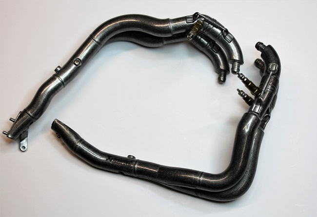

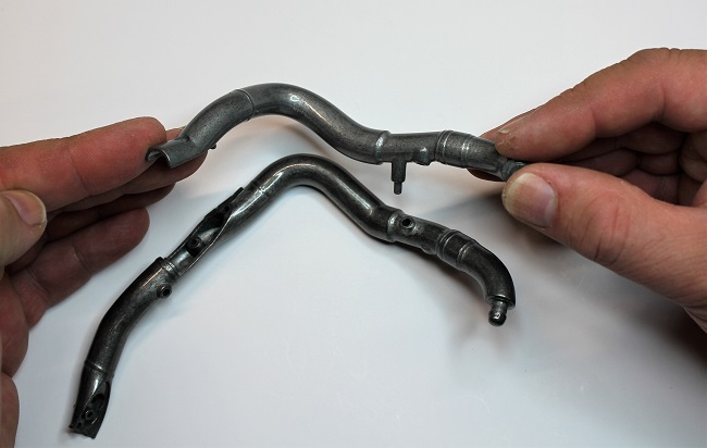

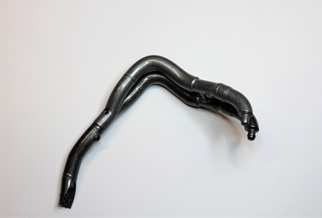

Pack 4 contains parts for stages 13-16
Stage 13
Contents: Exhaust manifold C, Exhaust manifold D, Type B screws
Take exhaust manifolds C and D, and locate the areas where they join, Insert the posts into the holes to join the two manifolds before tightening a screw
into the aligned hole of manifold C to secure them together.
Stage complete, carefully store any remaining parts in a stage labelled bag.

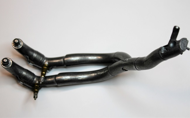

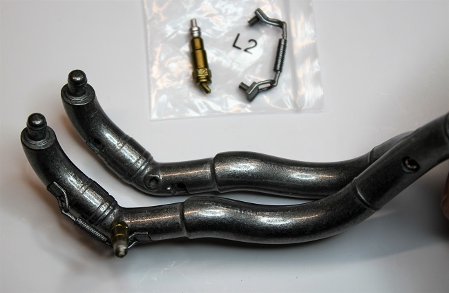

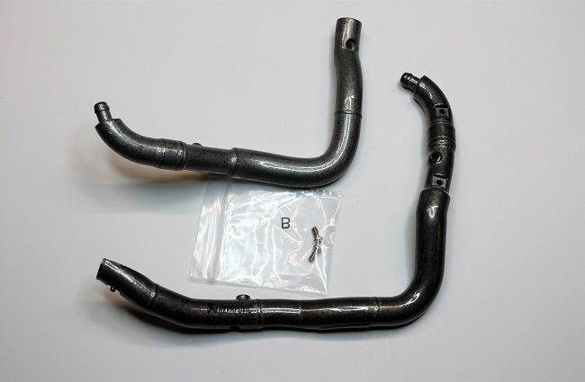

#2 Posted : 03 August 2018 23:23:29

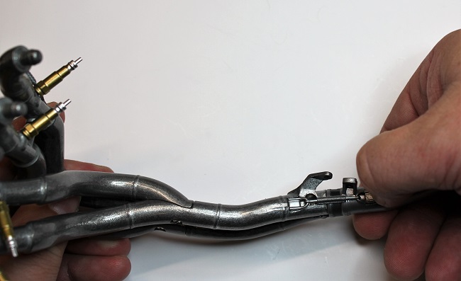

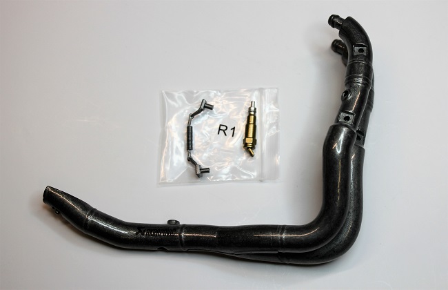

Stage 14
Contents: Lambda probe and L1 tension springs, Exhaust pipe, Lambda probe and L2 tension springs, Lambda probe and R1 tension springs, Type B screws, Tension springs, Lambda probe and R2 tension springs

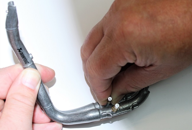

Prepare the left manifolds (A and B), assembled in Stage 12, and Lambda probe and tension springs L1 and L2.Take tension spring L1 and insert the two pins into the two holes in manifold B. You don’t need to use glue, just carefully push the pins fully into the holes.Now insert lambda probe L1 into the hole in manifold B. Push the probe lightly until it’s flush with the manifold. Repeat this to fit the L2 tension spring and lambda probe to the indicated holes in manifold A.
Prepare the right manifolds (C and D), assembled in Stage 13, as well as Lambda probe and tension springs R1 and R2.Push the pins of tension spring R1 into the corresponding holes in manifold D, before inserting the end of lambda probe R1 into manifold D next to the tension spring.Now fit the R2 tension spring and lambda probe into the holes in manifold C.

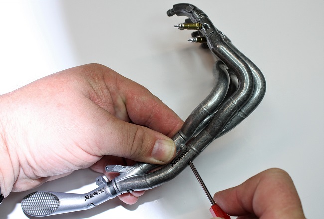

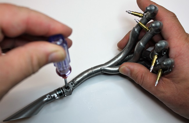

#3 Posted : 03 August 2018 23:27:55
Stage 15
Contents: Head cover, Cover plate, Type B screws

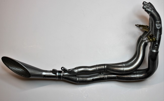

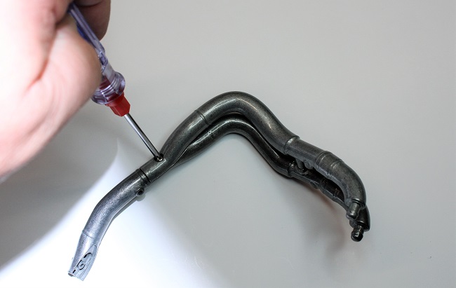

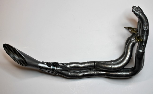

Take the right manifolds (C and D), and insert the end into the exhaust pipe. Push the left manifolds (A and B) into the exhaust pipe, on top of the right manifolds.Tighten a screw into the hole to secure the manifolds together.Turn the assembly over and having aligned the inner holes of the manifolds, insert a screw into the hole and tighten it to join the manifolds together. Place one of the tension springs over the join between the manifolds and the exhaust pipe before fitting the second tension spring onto the other side of the assembly.

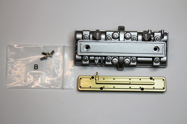

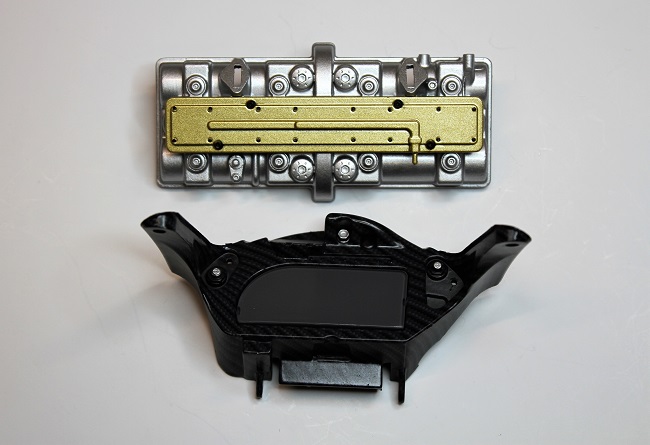

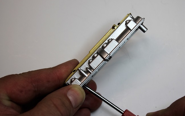

#4 Posted : 03 August 2018 23:32:20
Stage 16
Contents: Instrument panel, Instrument screen, Lights panel
You will need the head cover, cover plate and the type B screws from Stage 15.Place the cover plate onto the head cover, in the position shown. Turn the cover over, and tighten two type B screws into the holes.Turn the instrument panel over, and press the lights into position on the panel before turning the instrument panel back over again, and pushing the instrument screen into its space in the panel.
