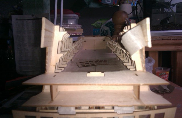

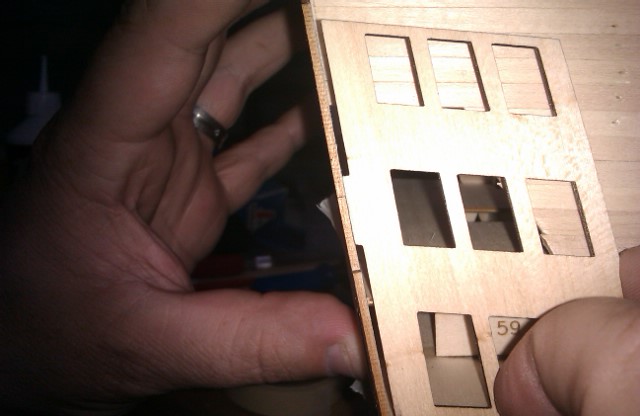

hi everyone im having a slight problem with fitting the galley obe side fits ok but the other (see pic) is quite a way out any sugestions on what ive done wrong & how to solve it

hi cal,can you put up a pic looking directly head on so you see the full length of the decks,I suspect a twist in the keel,
or the galley rear re-inforcements are not correctly located,so a pic of the raer as well would help.

hi again cal,looks ok,I think you have the gally piece is upside down,from the top of the gally side the slot is roughly 29mm.to the slot,and 34mm.from the bottom to the slot,as the gally side piece is tapered I find it hard to understand that you have such a discrepancy.
also check that the upper deck will be flush with the gally floor by laying a piece of planking along the deck supports.

cal I've just spotted the the gally deck has a twist in it,it is lower on the right,that would put the gally side out of alignment.
