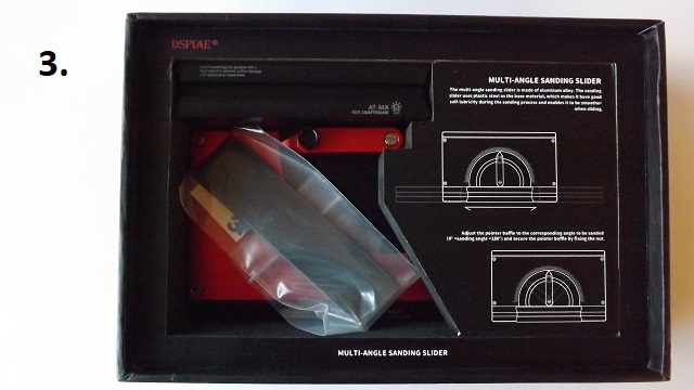

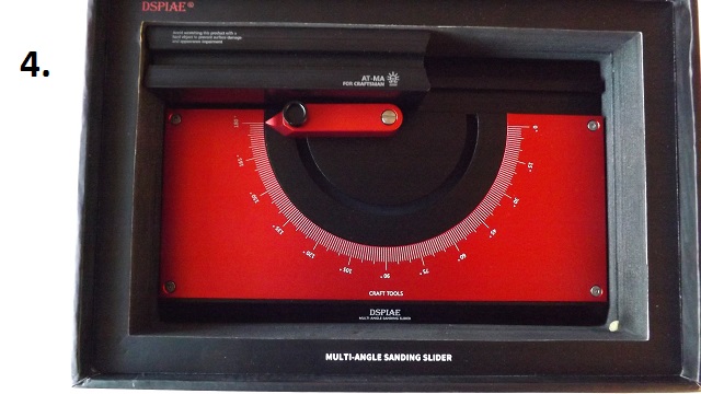

As with other DSPIAE modelling tools they are extremely well packed and presented. The outer boxes would almost convince you they are made of wood rather than card.
Having removed the lid, we get a foam layer with some instructions.
Under that we get another foam insert holding everything nice and secure again with some further usage instructions.
Removing that insert we then get to see the device for the first time.

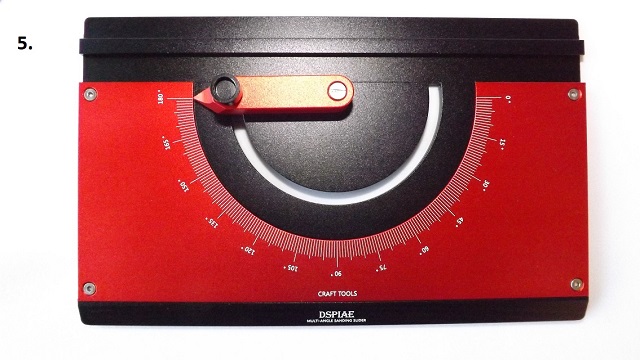

PICTURES 5 & 6
The device has an engraved scale (180 degrees) and a locking thumb screw allows the arm to swing between any of these scale increments.

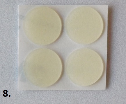

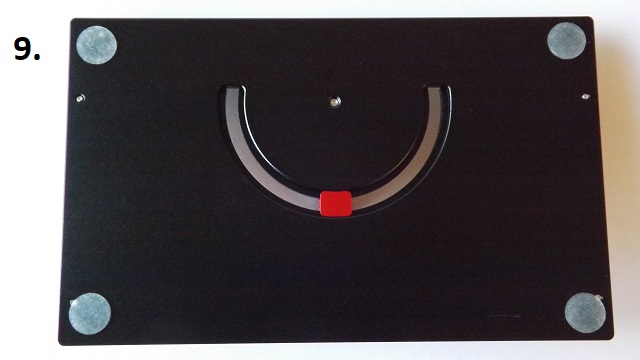

We get 4 self-adhesive non sip feet in the pack and these are affixed to each corner of the unit’s base.

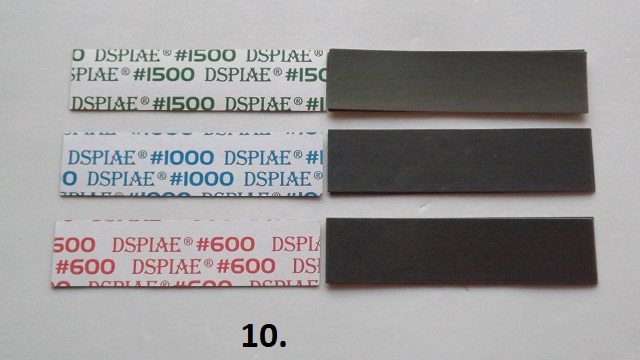

PICTURES 10 through 12

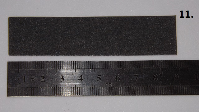

In the set we get a sample selection of sandpaper (its more of a wet and dry type paper) in 3 grades.
The paper is self-adhesive.
Overall DSPIAE have 10 grades of paper available, each available in packs of 30 strips.
180
280
400
600
800
1000
1200
1500
2000
2500
The paper sticks firmly to the slide and if required you could use 2 grit grades – 1 either side of the slide.

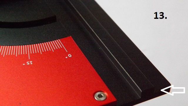

PICTURE 13
Here we can see the rail that the slide channel runs on.

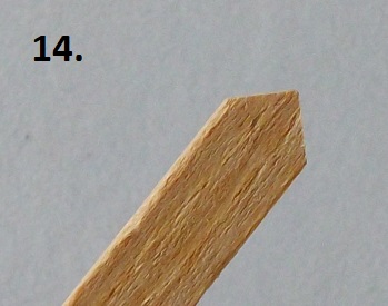

PICTURE 14
Just a quick test on a scrap plank and pleased to report it works very well indeed.
These sorts of tools would come under the “Nice to Have” category as its not going to be something that would stop you modelling if unavailable. But when you do have one of those awkward, small sanding jobs to do the tool should prove its use.
