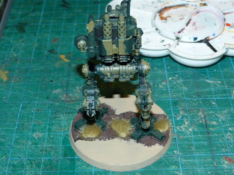

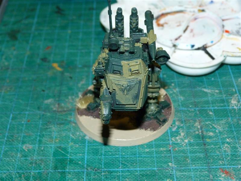

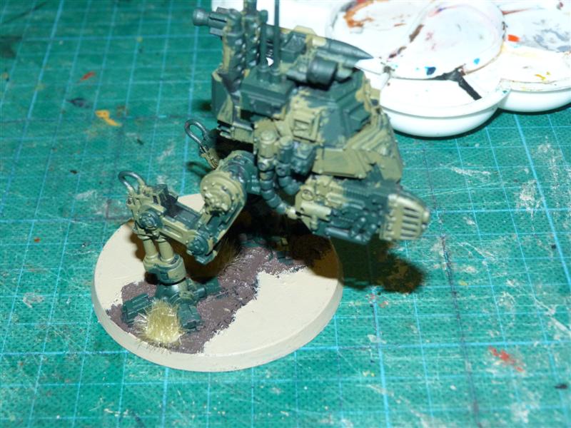

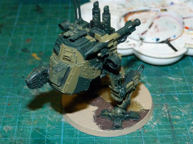

#8 Posted : 06 April 2020 15:48:02
Joined: 20/01/2011
Posts: 608
Points: 1,753
Location: Canberra, Australia
While not an actual figure, (of a person), you can see what the painting is like. This was brush painted from primer to where it is now. Still amazed they managed to create something that looks like the 2 legged walker from Star Wars. Vehicle is called an armoured Sentinal. :)
