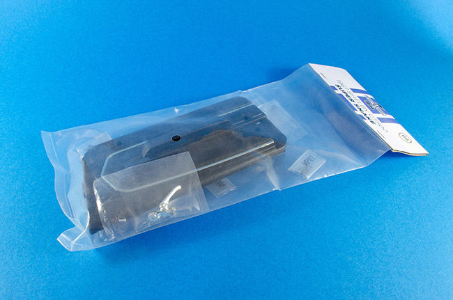

PACK 1
I've only recently started building 1:8 cars as part-works, and I have to say that this model is gorgeous. The parts are seriously high quality with everything fitting perfectly so far, and the paint finish is immaculate. The colour info sheet is excellent and the inclusion of a polishing cloth is a nice touch does help at the end of a session when you pop things away until the next pack....and especially for taking photos for a build log.

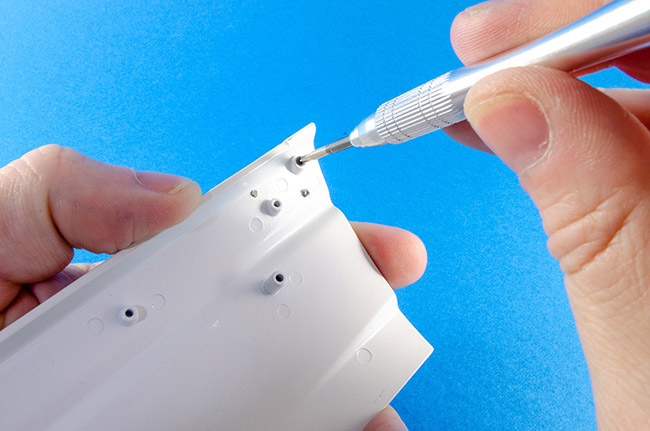

Things start nice and easy with the front fascia and bottom grille
The photo-etch grill is nice and sturdy and fits into the interior of the fascia, secured by a couple of screws. There is a little side-side movement so make sure the alignment looks even and then tighten up those screws.
Next up is the bumper. This fits with the pips on the upper side and the recess on the lower side. Pop this into place and secure with the supplied screws.

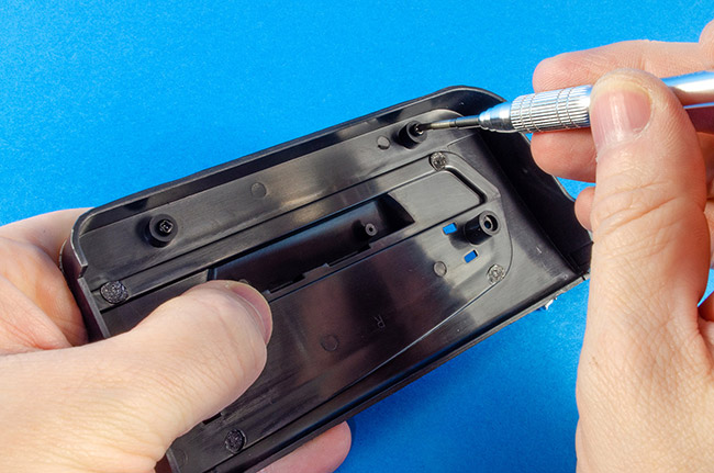

The headlight units are pre-made, and marked as 'L' and 'R' on the rear side. Take each in turn and slot into position from the front of the fascia.
Flip the fascia over and secure with screws. Make sure these are nice and tight.

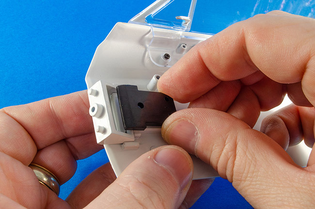

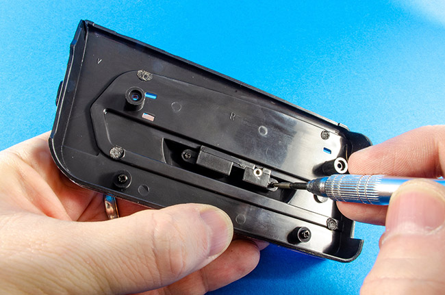

Now, it's the turn of the left hand door, also with its famous livery. We now need to fit the mirror unit.

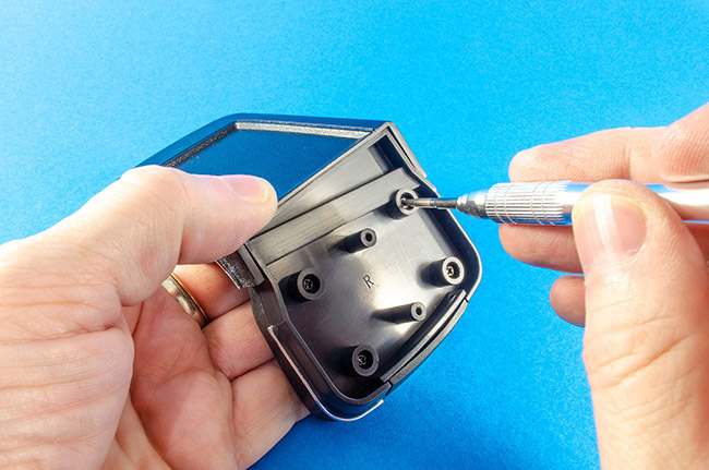

The mirror unit has a tab which goes through the slot in the main door panel.

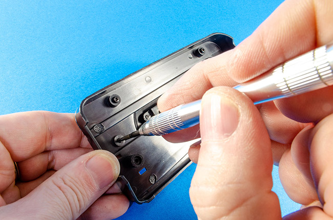

Two screws now secure this from within the door panel. This will pull it up nicely into place. Again, make sure it's tight, and careful not to scratch any paintwork.

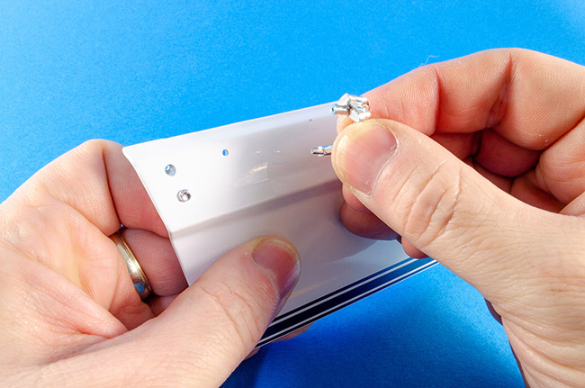

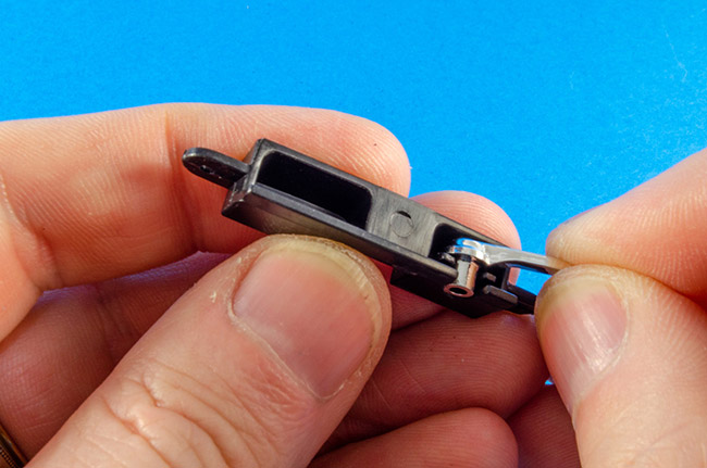

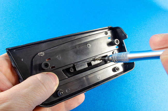

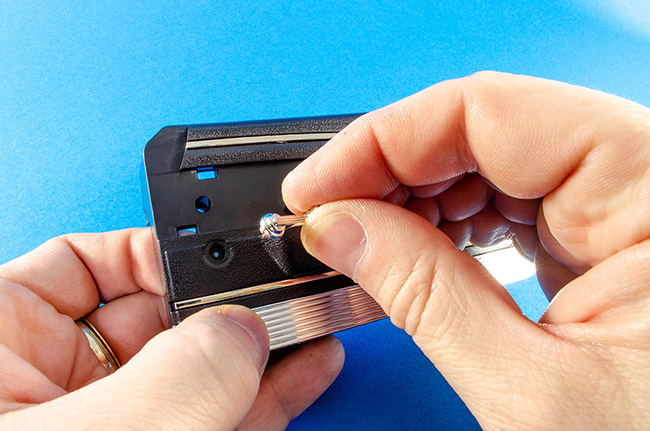

It's now the turn of the door handle. This can only fit into the exterior of the door in one way.
Again, from the interior, secure this with a single small screw.
And here is the result.

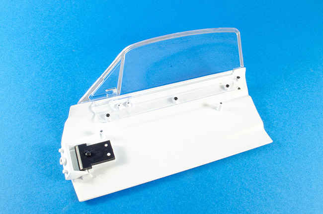

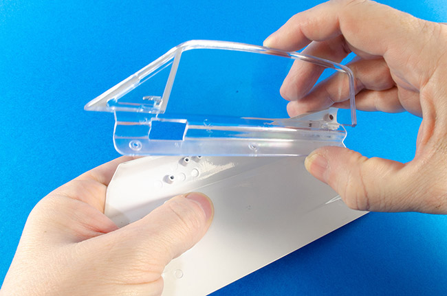

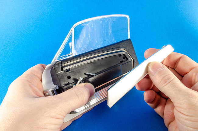

Care needs to be taken over the next stages because you really don't want to damage this beautifully clear part.

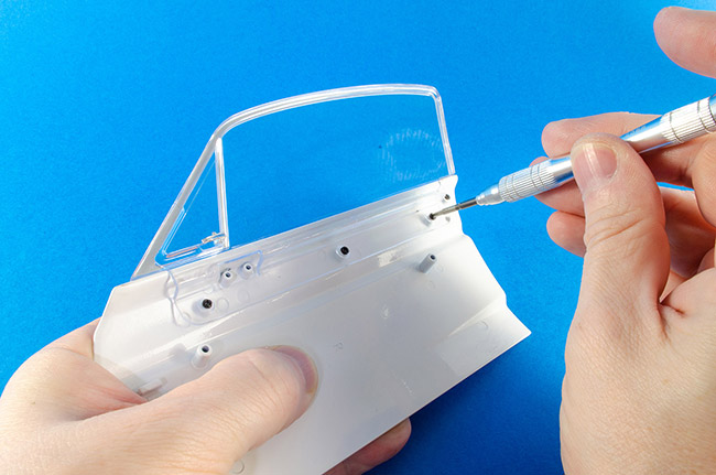

Screw the window unit into place within the door interior, using three screws.

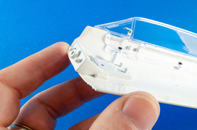

Next, fit the hinge. Note the orientation of this as it's important.
Now fit the retaining plate with the bevel facing upwards. Secure with a screw.

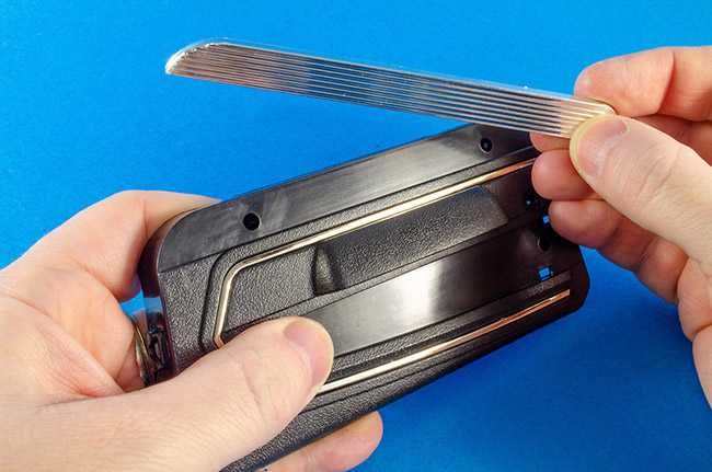

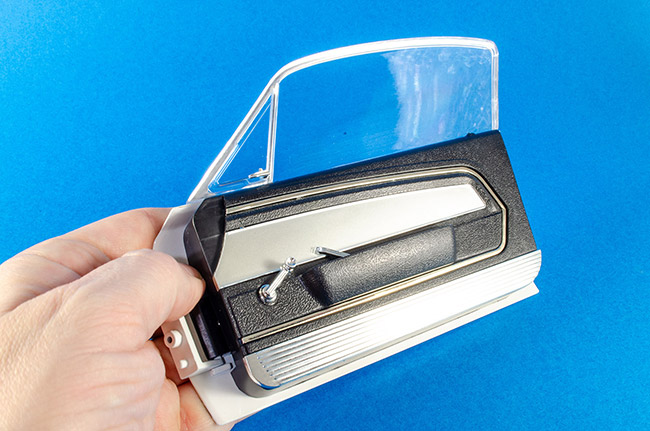

We can now start building the door interior. Take the inside door panel and lower trim strip, and fasten in place with two screws.

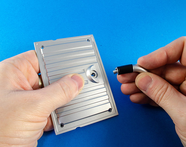

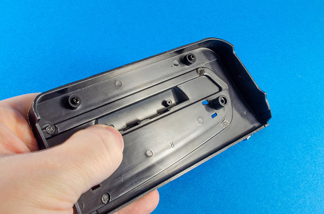

The door handle bracket needs to be orientated in the correct way here. Take the interior door handle and fit it like this.
Now fasten the bracket into the back of the door panel, slotting the handle through the hole. Take another screw and screw this into the back of the handle. This will stop it from rocking about.
The window crank handle now fits into this recess. This is tabbed so it fits in the correct position. Screw this tightly from behind.

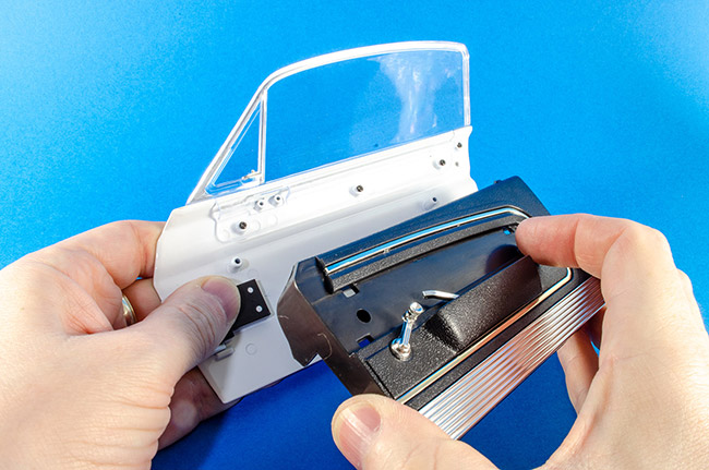

The interior door panel can now be fitted to the inside of the main door, and secured with two screws.
The upper trim strip now fits in place and hides the screw holes. This needs to be fitted carefully so as not to damage the door fittings.

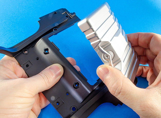

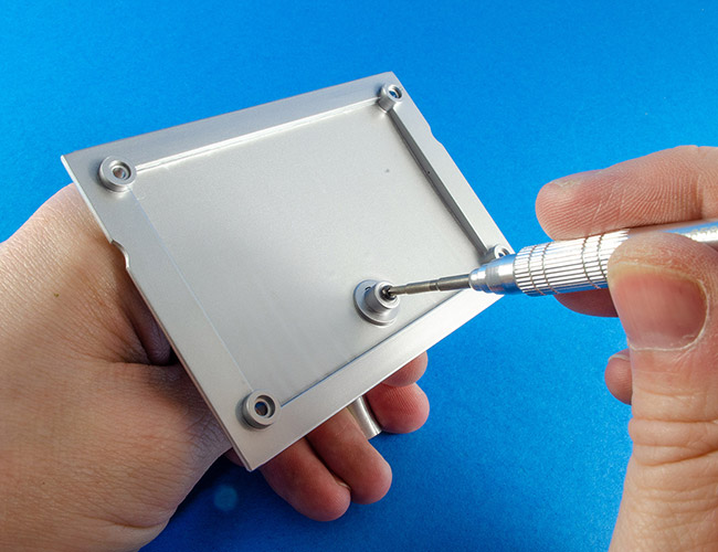

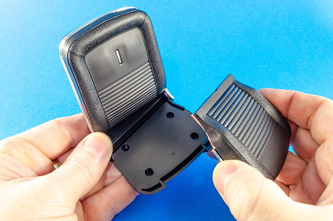

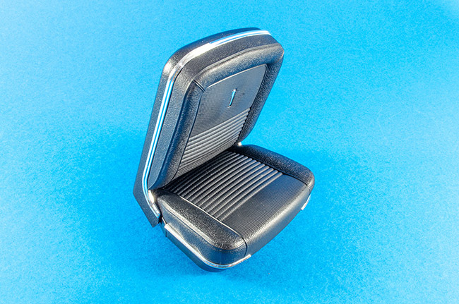

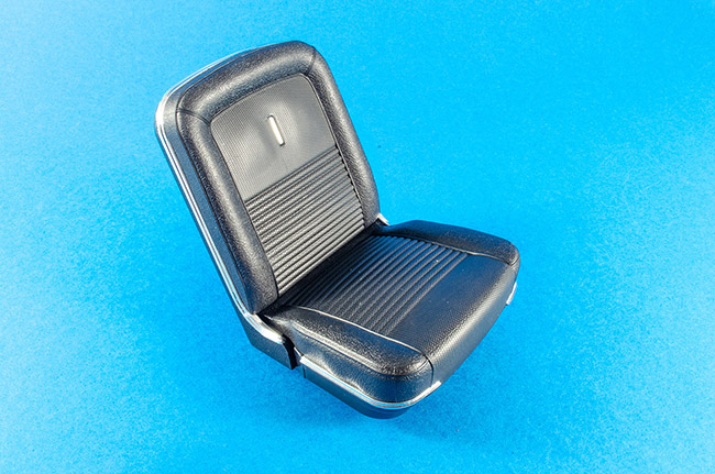

A driver needs somewhere to sit, and this is it. The backrest and backrest frame are now pushed together and secured with four screws.

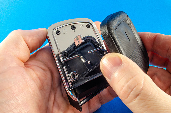

Superglue is now dripped into the three holes in the unit. The instructions say to apply this to the pins, but it's safer to do it this way as the glue can't run anywhere and ruin the parts.
Push the soft plastic upholstery unit into the holes. The tab helps with alignment.

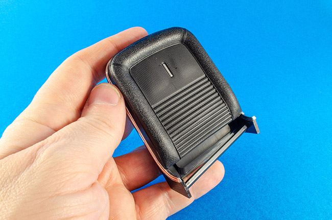

The driver's seat back part now locates to the base. You can easily see how these go together with the channel.
The driver's seat upholstery (with pre-fitted trim) now sits in place over this and is screwed together from underneath.
The finished unit looks like this and can also be tilted forward.

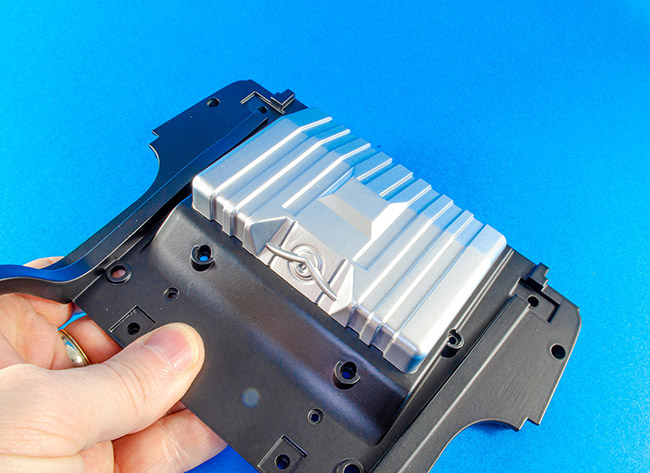

The lower tank section sits nicely onto the lower chassis and will stay there temporarily without screws...
...as thus
Now it's the turn of the upper fuel tank section
The fuel filler must now be fitted to the upper fuel tank section. The parts are notched to make orientation simple.
A screw secures the parts.

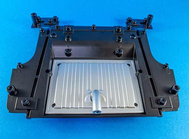

Not much in this packet, but it is pretty significant. Take the rear main chassis part and connect to the fuel tank assembly. As simple as that, but now you can see how this thing is starting to grow, and the fit is superb!

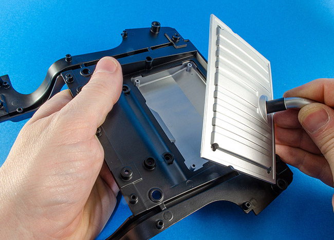

Stage 16: Rear Floor Pan
Again, only one part here, but I got 2 packs of screws. Only one of them is used, so the other looks like I can just use for any spares I might need (although the instructions also show the pack, but no use for them). Take the Rear Floor Pan part and fit to the rear chassis. Pretty obvious where this goes. It's simply like fitting a square peg to a square hole, metaphorically speaking. Nine screws hold this in place.

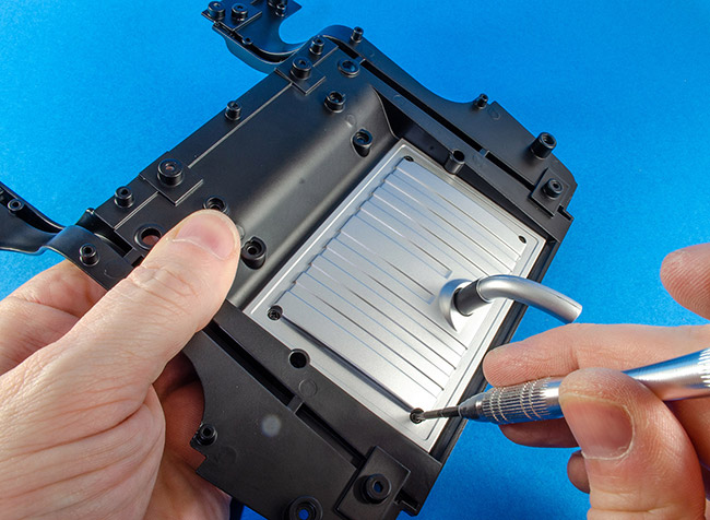

Pack 5 landed on the doormat late last week, so spent some time on this one. Please excuse some of the interior photos as the velvety interior is quite hard to photo on a white background without highlighting dust etc. The finish itself looks excellent, so I hope I've done it some justice here.
STAGE 31: STABILIZER BAR AND LOWER SUSPENSION ARMS
This pack is very simple and just adds the stabiliser bar and suspension arms in a single piece. This needs to be able to pivot and flex to is can take the natural suspension of what will be a very heavy model when completed. The stabiliser bar is first screwed into the forward chassis, and then pins used to locate the suspension arms. The pin is serrated and grips the metal of the chassis. I fitted the stabiliser bar first, unlike the instructions said, as this seemed the most natural thing to do.
Be careful with the pliers so you don't damage any of the metal paintwork.

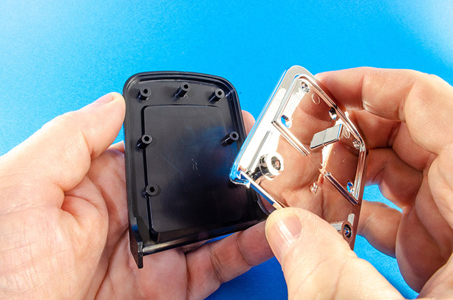

STAGE 33: FRONT INTERIOR FLOOR AND GEAR LEVER
And now for something completely different! Some interior!
The interior parts of this model have a black velvet-style finish to them, and you'll need to be careful that you don't mark this as you build. I found a piece of de-tacked masking tape was perfect was removing lint and hairs/dust etc. This pack is simple.....we just screw the gearstick to the interior floor by inserting a screw from underneath. Et voila!

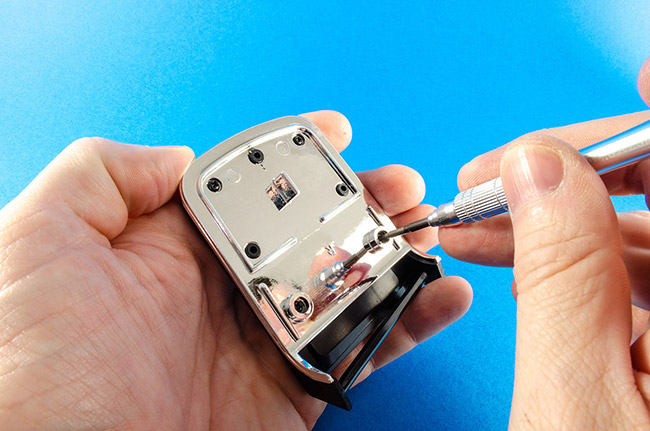

STAGE 34: FRONT SIDE WALLS, PEDALS AND SWITCHES
We now see the first of the electronic parts in the form of two microswitches for the accelerator and brake pedals. First though, we fit the front side walls, being careful not to damage that velvet interior finish on them.
The switches are now located to the switch holder, observing the correct position for each 01, 02.
The switch holder is then clicked to the rear of the interior and screwed into place.
The pedals are now fitted. I had to make sure the pedal plungers went through the holes in the interior and could make contact with the switches. One of these was a little sticky, so repeated operation freed it up so it worked perfectly.

STAGE 38: REAR FLOOR AND FRONT SEAT BELTS
More care is needed here as we have another velvet finish part in the shape of the rear floor. Before we do anything else, the seatbelt anchors are clicked into place in the slots on the floor section. These are quite a tight fit and I needed to remove fingerprints with some de-tacked masking tape on the black surface, when done.
The rear floor is now screwed to the interior section and a central pin used to lock the 'tunnel' together.
The seatbelts are slotted into position as shown, making sure that the Cobra badge is facing upwards on the clasp.
Flip the model over and located the belt to the pips as shown. I needed to use. small spot of CA to make these stay in position.

Remember those seats? Those are now fitted to the interior. Note the 'R' and 'L' on the underside and fit them in the appropriate place as shown on the instructions. Two screws hold each in position.

STAGE 85: HOOD, FRONT GRILLE, HIGH-BEAM HEADLIGHTS
To attach the Shelby logo to the front grille, two little tabs need to be bent inwards. These then snag onto the badge locating pins, holding it in place.
The other tags now need to be bent inwards, fully. The grille can then be fitted to the grille surround, and the tags then bent backwards to lock the grille into its surround. The surround is then screwed to the front Cobra assembly.
The next thing to fit are the headlights which just push into the grille surround from the front. The screw position needs to be pointing upwards so they are angled correctly.
STAGE 86: HOOD HINGES
The hood hinges are now fitted to the hood. There are three different types of screw used for this, so care needs to be taken to get this right. There's quite a lot of tension in these when built, and it's a good idea not to keep operating these until fitted to the car as the slider won't cleanly operate until then.
Four screws now secure the hood to the main body. The hood needs to be inserted an an angle and then slid upwards at the rear to locate it. I had to move the hinged slightly to get this into position. I also noticed that the hood wasn't even to the fenders on each side, so the fenders needed to be slackened off and realigned to the hood.

STAGE 89: LOWER REAR BODY SECTION, TRUNK HINGES AND BRACKETS
The lower rear body part is now offered up to the rear of the main body and secured with six screws.
Both trunk hinges are fitted to the lid and the trunk led fitted to the main body, using the hinge brackets to hold in position. These are metal, so no chance of them being bent with any force.
STAGE 90: REAR LIGHTS, LED WIRES, GAS CAP, GAS PIPE, CABLE HOLDERS
Before I can start the wiring, the gas cap and gas cap base are fastened together using the small hinge and shortest small screws. This is then pushed into position and secured with a screw. The gas pipe holder is then also fastened into position, using screws from the outside rear.
The right rear light is pushed into position...
...and the rear right LED strip popped into place. I did find that before I could fit the light holder, that I needed to clip down the LED tails on the soldered joints as they protruded a little too far and stopped the holder fitting snugly.
With the holder in place, the cable is run in its channel and the cable clips used to hold it down. Again, a spot of CA was used to make sure these didn't eventually come loose when everything is finally assembled.
