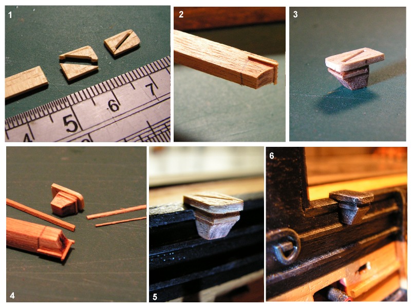

The sheet anchors were basically spares for the Bowers and were stored more or less permanently back on the Fore Channels, my own Del Prado instructions don't even mention the anchors other than showing the metal parts in the kit! Below is the photo from my own diary when I scratch built the Anchor Palm Block. The pointy bits on the anchors (which I always thought were called Flukes were called Palms back in Victory's day which then explains why the Palm Blocks are called that! The anchor palms locate into the slot in the palm block which keeps the bottom end in place with an iron chain around the shaft/arms but where that chain is secured I haven't found out yet!
There were then rope lashings around the shaft/wooden stocks which, according to Anatomy of the Ship: HMS Victory book by John McKay "were lashed to the top of the fore channel, outside of the shrouds". And that's the only description I've got!
As there are iron ring bolts in the outside top of all the channels, I'd assume the anchor is secured or lashed to them.
