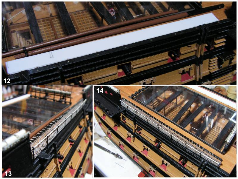

As mentioned last time, the wooden channels now required the decorative edging strip. This is shown after super gluing into place in Photo 21. The copper wire was first stretched between a couple of pliers removing the coil curve and leaving a nice straight rod. This was glued along the front of the channel and once set the two concave ends were gently smoothed into position and then glued in turn (I used super glue gel initially to get the wire fixed and then a thin superglue applied via cocktail stick to seal the wire in firmly. Once all was dry the copper wire was first primed with Vallejo grey primer and then given a coat of Admiralty Dull Black acrylic and finally, a dry brushing of Vallejo light grey to accentuate the edging, (the exposure isn’t quite right in Photo 22, it’s not as pronounced as it appears!) At this point, I super glued the channel in place on the hull – the starboard channel will be hopefully following a slightly different technique as the following part was one of those ‘tear your hair out’ moments! With the channel in place I then had to create the five iron brackets which help to support the channel (non existent on the kit unfortunately, though not exactly unexpectedly!BigGrin ) Two of them are shown in Photo 23. The ones on the Main and Mizzen channels were made from 0.5mm brass strip for the top bits and 0.3mm strip for the supports. Unfortunately I had run out of the rest of that brass so I went to order some more. Also unfortunately I then discovered that the company I’d got the brass from; “Eileen’s Emporium” had ceased trading (some years earlier)Blink . I managed to get some 0.5mm on ebay but no-one had any 0.3mm so I had to go for 0.2mm instead. 0.1mm may not sound like much but it certainly makes a difference in how firm or flimsy that support feels when trying to solder it!
Photo 24 shows the set of five supports after blackening along with a sixth one which I kept back as a pattern for the other set later (and then went and lost the darned thing and had to start from scratch anyway!) Trying to super glue those things in underneath the channel was a nightmare! I had to have the hull balanced at almost forty five degrees to be able to even see what I was doing and the tweezers kept pinging the supports off in all directions at high speeds. As I said, the starboard channel is going to go together a little differently to try and make it a bit easier to get the bits in place. Eventually I managed to get all the supports glued down (or more appropriately, up) and the channel then appeared as it looks in Photo 25. Now came another really fiddly part, adding in the chains securing the deadeyes to the hull. The port side chains are shown underway in Photo 26, each one is composed of three sections or links. The upper link, which connects onto the deadeye strop, is a straight forward parallel link and is the same size for all the deadeyes. The second link is a little more complicated, it is wider at the top and then reduces in width until the bottom where it has a slightly larger ring for the bolt to pass through. The third section isn’t so much a link as a bracket, almost like a flattened dumbbell . This is used to fix the entire chain into the hull timber via two bolts which are drilled into the thicker upper wale running below the gun ports. Fortunately, on the forechannels these brackets are fitted to the wale itself. On the main channel, some of them are longer than the wale and have a double ninety degree ‘kink’ on the bottom to run from the wale to the proper hull!Blink In this photo, the last two chains visible are awaiting the bottom brackets (actually it was only one of them, the other was supposed to be a shorter chain for the smaller deadeyes so I had to change that one later!)Blushing
With the port side completed it was time to begin on the starboard. This was when I suddenly realised I had made a little – OK, BIG mistake when I was rigging up the gunports all those years ago! The port side gunports were fine (which was why this came as a big surprise) but on the starboard side, as shown arrowed in Photo 27, I had mistakenly put the lead tubes for the gunport lid tackle above the thin moulding instead of under it as I had on the other side! The problem being of course is that the wooden channel actually sits on that moulding so there was no way for the tackle ropes to pass through it. The foremost gunport isn’t arrowed, although it is incorrect the channel doesn’t reach that far forward so I could leave that alone (the anchor covers up most of that area once it is on!BigGrin ) Photo 28 illustrates the ‘remedial’ work underway. The aluminium tubing used for the lead tubes was gently pulled free of the hull – I do fortunately have some of that left over but was able to reuse the original bits with some new rigging thread, and corresponding new holes were drilled under the moulding. The old positions were filled in by gluing the tips of a cocktail stick into the holes and cutting off the excess before sanding flush and re-painting with Admiralty Black acrylic. Finally, Photo 29 shows the first gunport re-positioned with the second ready to start.

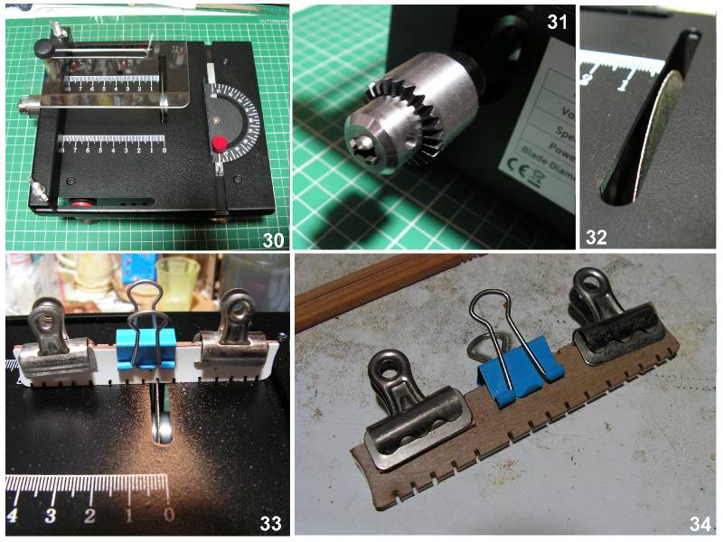

As promised, that new acquisition is shown in Photo 30 – namely a lovely little mini circular bench saw table! I found this one on ebay (of course) for a very reasonable £65. The reason I went for this particular type can be seen between the 3 and 4cm mark on the upper scale to the left of the saw blade. At the bottom of that little hole is a screw bolt and the supplied Allen key which fits down there when turned raises or lowers the height of the circular saw!Cool That particular facility (which not all mini table saws have) allowed me to do what comes later. Not only is this a circular saw, but in Photo 31, you can see the drill chuck which sticks out on the left side of the machine (also visible in the earlier photo). A selection of sanding disks comes with the set which go on here. Not shown here, on the opposite side of the motor shaft is a connection for a flexible drive shaft with a smaller chuck on the end which takes a selection of drills, sanding drums and other ‘Dremel’ type tools (also supplied in the set). One word of advice – when using the saw, follow the advice in the manual and disconnect the flexible shaft connector – it doesn’t half give your right hand a whack if you forget its down there!Blink
As well as a wood saw blade the machine also comes with a diamond dust grinder blade as shown in Photo 32 and this is the one I used for the deadeye strop slots. The wood sheets I bought for the replacement channel proved to be about a mm too thin, that’s what you get relying on a ruler instead of double checking with the micrometer!Blushing Fortunately I had some veneer, which took the wood sheet up to the proper thickness. Once the channel had been made up, the plasticard template was attached via mini bulldog clips and the saw blade set at the right depth for the slots. All I had to do then was to carefully slide the channel, template first, towards the grinder blade aiming for the previously made slots in the template as shown in Photo 33. The final result is seen in Photo 34, all neatly ground into the wooden channel and a heck of a lot easier than the manual filing out that the port side channel received!Cool
The next task was to drill the two holes for the brass rods, which will hold the channel in place as the glue dries. The first test fit is shown in Photo 35, in this instance there was another slight difference in the technique – on the port side both rods were glued into the channel and then pushed into the holes in the hull. This time however the forward rod was so tightly held in the hull that it came out of the channel on removal so I left it in there and superglued the rearward one to the channel with a drop of extra thin superglue on the other one in the hull.

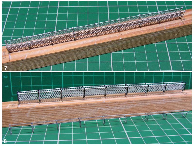

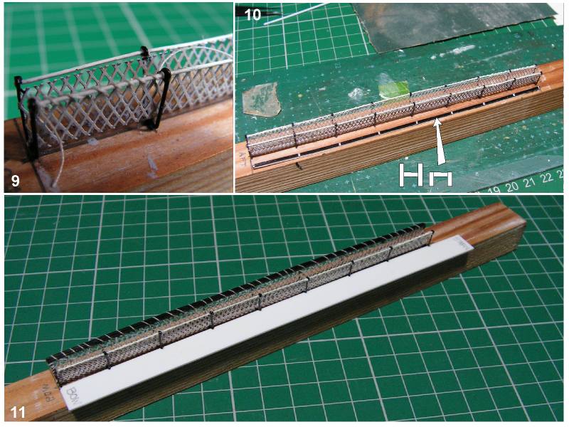

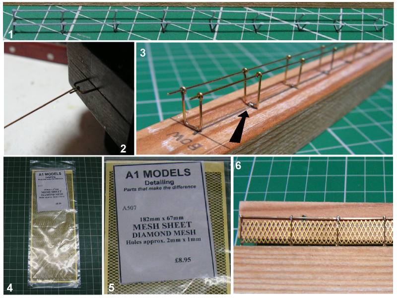

So, time to re-engineer those waist hammock frames! So far, I’d made up the hammock frames on the bow bulwarks, the quarter deck bulwarks and the cross section frame on the forward edge of the poop deck. They looked OK with the fabric mesh netting and Milliput hammocks. Being lower in height I could get away with the fact that the netting was a hexagonal ‘chicken wire’ form instead of the actual square or diamond shaped mesh. I’d only made one side of the waist hammock frames and the more I gazed at it the more I thought it looked ‘not right’. Eventually I got out all my Victory references and double checked – the suspicion was right – the frames were not high enough! That meant one of two solutions – either spend out for some PE Brass after-market ones or do it again. The PE ones I found on the internet were lovely to look at but the cost of them was not!Crying In the end I decided that since I’m having to scratch build most of this model to get it right (the kit didn’t actually have any hammock frames or netting in it although the DelPrado publicity fold out poster of the ‘finished’ model did have brass frames but no netting), I might as well carry on and make my own again.
Photo 1 shows the ‘old’ frame. It was constructed from 0.5mm brass rod by bending the ‘U’ shaped frames into shape and soldering them on the outside edge to a pair of straight brass rods to simulate the ropes onto which the rope netting was attached. The new version would be very similar but would have the rings at the top to thread the brass rod ‘rope’ through before soldering as well as an extra piece of slightly thinner brass rod (I think it was 0.4mm) attached to the base of the frame to provide a ‘nail’ to glue into holes drilled in the ‘Hammock Crane Plank’ which runs along the edge of the deck (Hammock Frames are also known as Hammock Cranes). Photo 2 shows how those bottom additions were fitted on. The frame or crane was formed first and gripped in the vice with the base just outside of the jaws. The ‘nail’ rod was bent around a steel needle to provide the ‘U’ shape, which was hooked over the base. The other end was gripped in another mini vice and pulled back under tension to keep the hook in the dead centre of the frame and then soldered. Once fixed the excess part of the hook was snipped off level with the base and the nail part cut to about 5mm or so. When all the frames were made, I took a scrap piece of wood, drew a pencil line down the centre and marked out the length of the entire frame and the spacing between the individual frames. All the frames except the two end ones had the ‘nails’ and they were all slotted into the holes drilled in the wood jig, the nearest is shown by the arrow in Photo 3. Then the two long brass rods were threaded down through the rings and once in place the two end frames slid on from each end. When I made the first hammock frames, I had a pack of perfectly straight brass rods. This time around I have a multitude of brass wires on spools. As every modeller probably knows anyway, wires on spools do NOT like going straight! The easiest remedy for that is to cut a length off the spool, grip one end in a vice and the other end in a pair of pliers or mole grips and simply pull the wire away from the vice at 180 degrees. The wire stretches slightly and when the tension is released the curved wire is perfectly straight! Instead of using the hexagonal nylon mesh the netting on the new frames was going to be made from PE brass from a Company called A1 Models Detailing. Part Number A507 – a sheet 182 by 67mm, with a diamond mesh of 1 by 2mm, as shown in Photos 4 and 5. The length was just enough to get the full waist in one piece. By luck I had another piece of scrap wood which was just the right thickness to slide in between the frames. This was used as a former to bend the cut off section of brass mesh (heavy duty scissors did the job), the wooden former is seen holding the mesh in place within the frames in Photo 6. With the brass netting in place the whole assembly was primed with Vallejo Grey Surface Primer as shown in Photo 7. After a day or two to fully dry, the netting was painted with Vallejo Ivory so the netting had a slight contrast with the supporting rope which was Vallejo White and the frames themselves were (very carefully) painted with MiG Satin Black. Despite a steady hand there was a bit of to-ing and frowing with ivory covering over accidental black and black over-painting touch-up spillage from ivory and white! The result is shown in Photo 8 with the old original frame shown at the bottom for comparison.
The next task is very fiddly to say the least! Using a thin white thread, the top most diamonds in the brass mesh have to be hand stitched to secure the brass ‘netting’ to the brass ‘rope’ as shown starting on the first section in Photo 9. I did this on both sides of the netting although to be honest I need not have done it on the inboard side as it turned out. I only went back to the drawings after I’d done both only to discover that the inboard side didn’t actually have a supporting rope at all (so I could have saved all that bending the rings on the top of the frames as well!Blushing ) Instead of the rope supports the inboard side has a wooden handrail which is attached to the top of the frame with a simple spike stuck into a hole in the rail, and the netting is then lashed to the rail. Photo 10 shows the hand rail under construction. The rail itself is made from a styrene ‘H’ girder from ‘evergreen scale models’ (I could have sworn it was Plastruct! It was 1.5mm square and the first job was to sand down the top part of the ‘H’ to turn it into an upside down ‘U’. Once the top was sanded flat I painted the inside groove in black acrylic and when dry laid it alongside the frame and used a micro drill bit to drill down into the groove at the positions of the frames – the drill holes are the little white dots along its length. I could then add a little drop of super glue gel in each hole and place the rail into position, fixing it to the top of each frame (needing all the fingers of both hands to get them all to stay in place at the same time.) Once stuck, the rest of the rail was painted black and the following day the brass netting was stitched onto the rail as shown in Photo 11. Also shown in this photo is the next simple jig, a length of plasticard corresponding to the total length of the waist with a small notch cut out to match the position of each of the frames. The jig is shown in position on the port side of the waist in Photo 12 with a small hole drilled into the edge plank in each notch ready to take the base spike on the frames. Flipping the jig over then allows it to mark the positions on the starboard side as well. The final two pictures, Photos 13 and 14 illustrate the port netting in place, dry fitted for now as I don’t want it getting in the way when I come to do the railing around the open waist later on.
