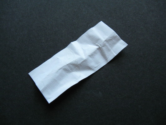

Issue 34 - Contains the left-hand upper & lower engine cover's and gold reflectors; and has instructions for preparing and attaching the gold reflectors to the injector unit.
Preparing the gold reflectors - Turn both face down and gently rule pencil lines on the reverse surface 10mm from each end of the white backing paper.
Take a reflector between your fingers and thumbs and gently wrinkle and twist it at a point about a third of the way along the strip.
The metallic strip will gradually soften and start to separate from its backing paper.(Make sure the ends that you marked remains firmly in contact with the backing paper).
Work your way slowly along the reflector, wrinkling the surface until the whole of it is crumpled and starting to separate from its backing paper - apart from the ends you marked.
Repeat the process with the second reflector strip, then carefully cut both strips along the two pencil lines.
Attaching the reflectors to the injector unit - Take the injector unit that you assembled in issue 33, and check the positions of the gold reflectors. They go on the flat areas of each side, so that they fit between the two rounded ends and just below the red line.
Peel off the backing paper and gently place the gold foil in position, lining it up as mentioned, gently press the foil into place, taking care not to smooth out the wrinkled/crumpled effect.;
Use scissors or a very sharp blade to very carefully slice away any surplus foil beyond the edge of the injector unit moulding, then repeat the process with the second reflector on the opposite side of the unit.

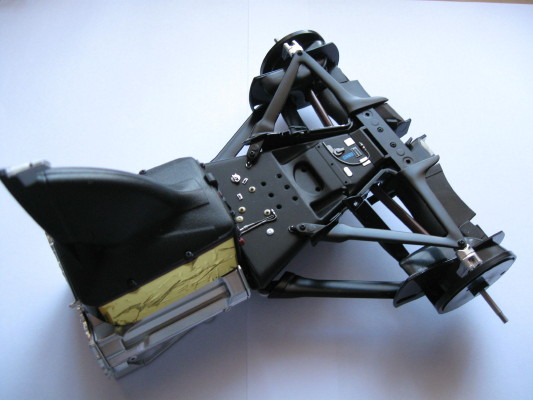

Issue 35 - Contains the right-hand upper and lower engine cover; and has instructions for Stage 2 of assembling the lower engine covers.
Attaching the injector unit to the engine - Take the engine/gearbox and test fit the injector unit onto the two projecting lugs on top of the engine block, then apply superglue to the lug contact points and press the parts together.
Attaching the lower engine covers - Carefully remove the type 'E' screw that holds the forward end of the upper wishbone to the top of the gearbox, (take care not to damage the small pin which locates the end of the arm).
Fit the left lower engine cover around the lower wishbone. The rear supper corner of the cover has a recessed area that matches the end of the suspension arm you just unscrewed, carefully fit this under the suspension arm.
Refit and tighten the screw you removed, so that the suspension arm traps the top of the lower engine cover.
Then repeat the process with the right lower engine cover.
The lower engine covers may appear a little loose at this stage, do not be concerned about this, as the covers will be fixed rigidly when you install the underbody in a later issue.
That's it for this week, carefully store the assembly and the remaining right-hand upper engine cover.
