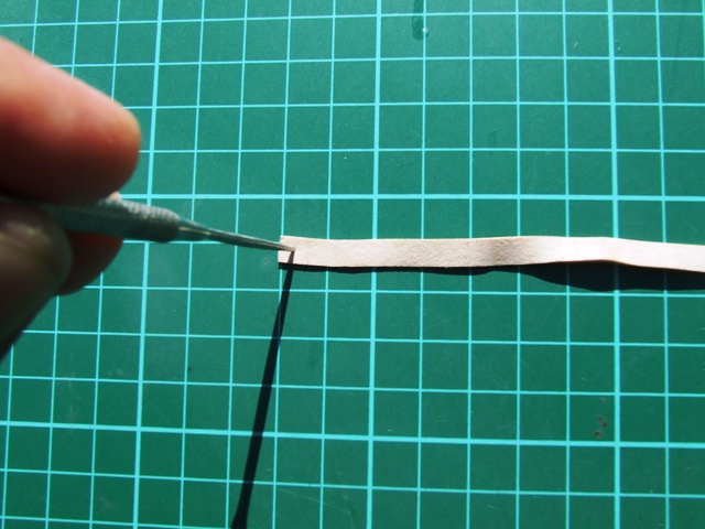

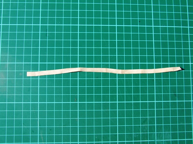

Like a lot of modellers I love to hear about any useful tips that might be helpful in making my hobby easier or more enjoyable, so I thought that I might share with you, my own system for keeping all those little screws safe in one place until needed and also a way of making them easily accessible with a reduced risk of losing them to the carpet monster!!
I was trying to come up with the best way of storing them but didn't want to spend too much money on a solution and was fiddling with an elastic band at the time when it occurred to me that the answer was already in my hand!! This is how you do it:

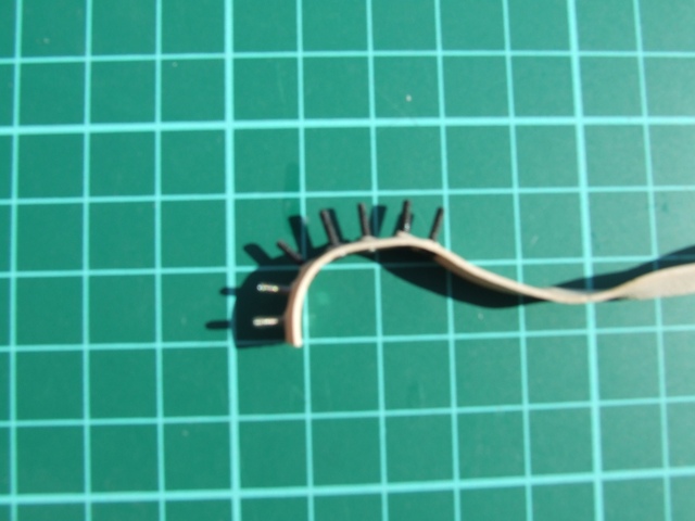

Cut an elastic band and open it out. Using a sharp tool make the same number of holes as per the screws for each weekly issue. Then insert the screws in number and type order into the holes along the band. Then using a fine permanent marker pen write the issue number and screw type details on the band after the last screw, then cut off the band at the end. Store in a partitioned box until needed. Hey presto a neat and tidy solution to the problem that can be done quickly every week after the building is finished and the instructions tell you to store the rest of the screws for later in the build !!
The beauty of this system is that the inherent elasticity of the rubber band holds the tiny screws gently but secure without damaging the threads and the screws are easily pushed out when needed. It is also very flexible for storing.

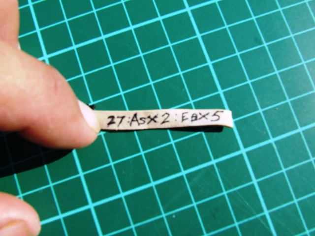

The ID code I use on each band is as follows:
For example: 27:Asx2:Fbx5
Which stands for: Issue 27, type'A'(silver) x 2, type 'F' (black) x 5
A simple and effective filing system for all those little screws and it is a quick and simple matter of finding the correct band for the relevant screws when in a later issue it says to use (for example) the 'type F screws' from issue 27, etc!!

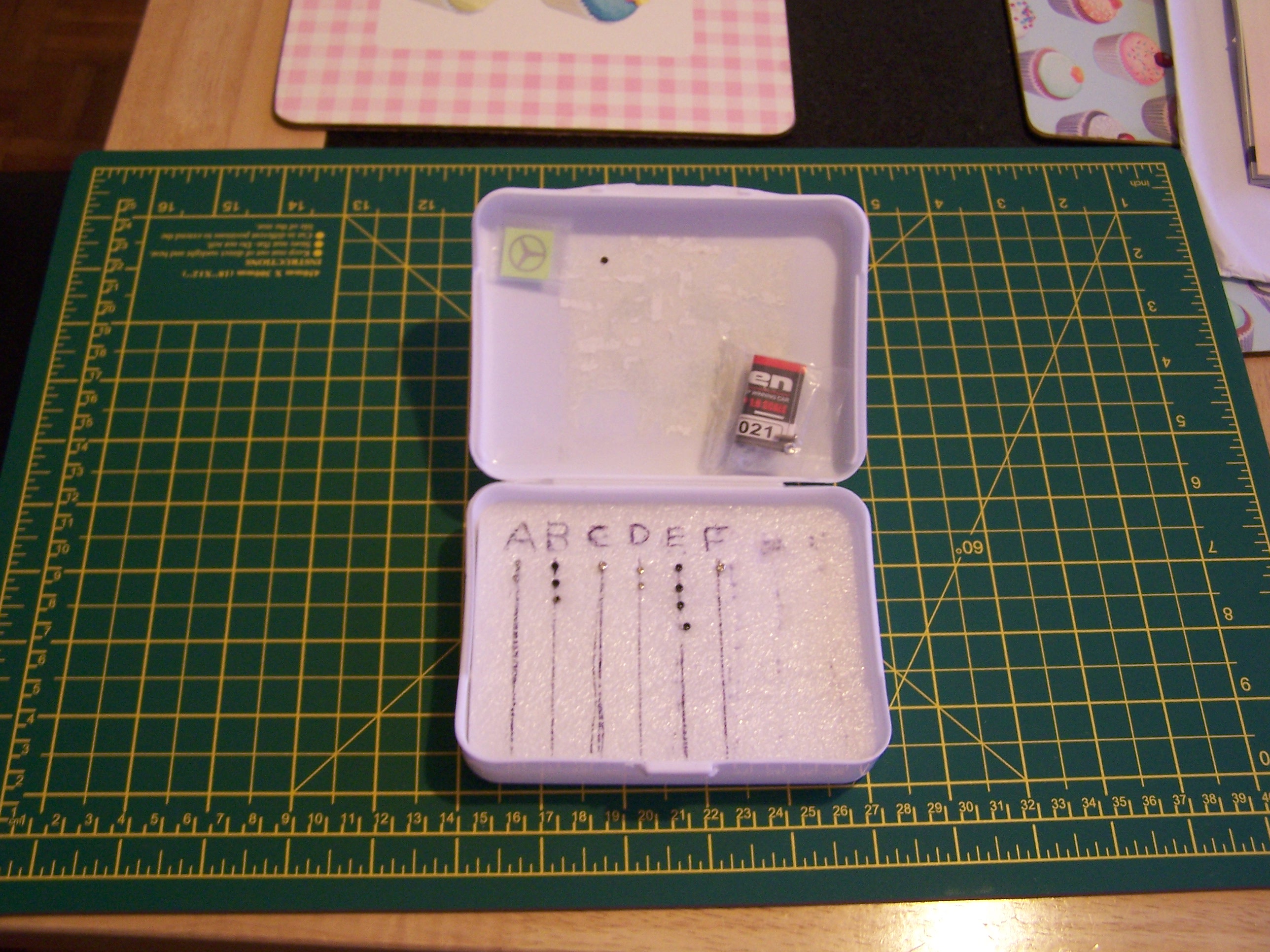

I have a small plastic box with a piece of polystyrene in which I just push screws into in a line and wright next to them easy peasy. Flapper
