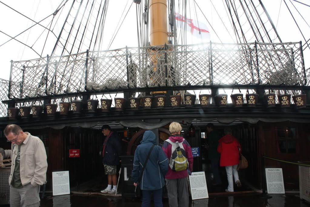

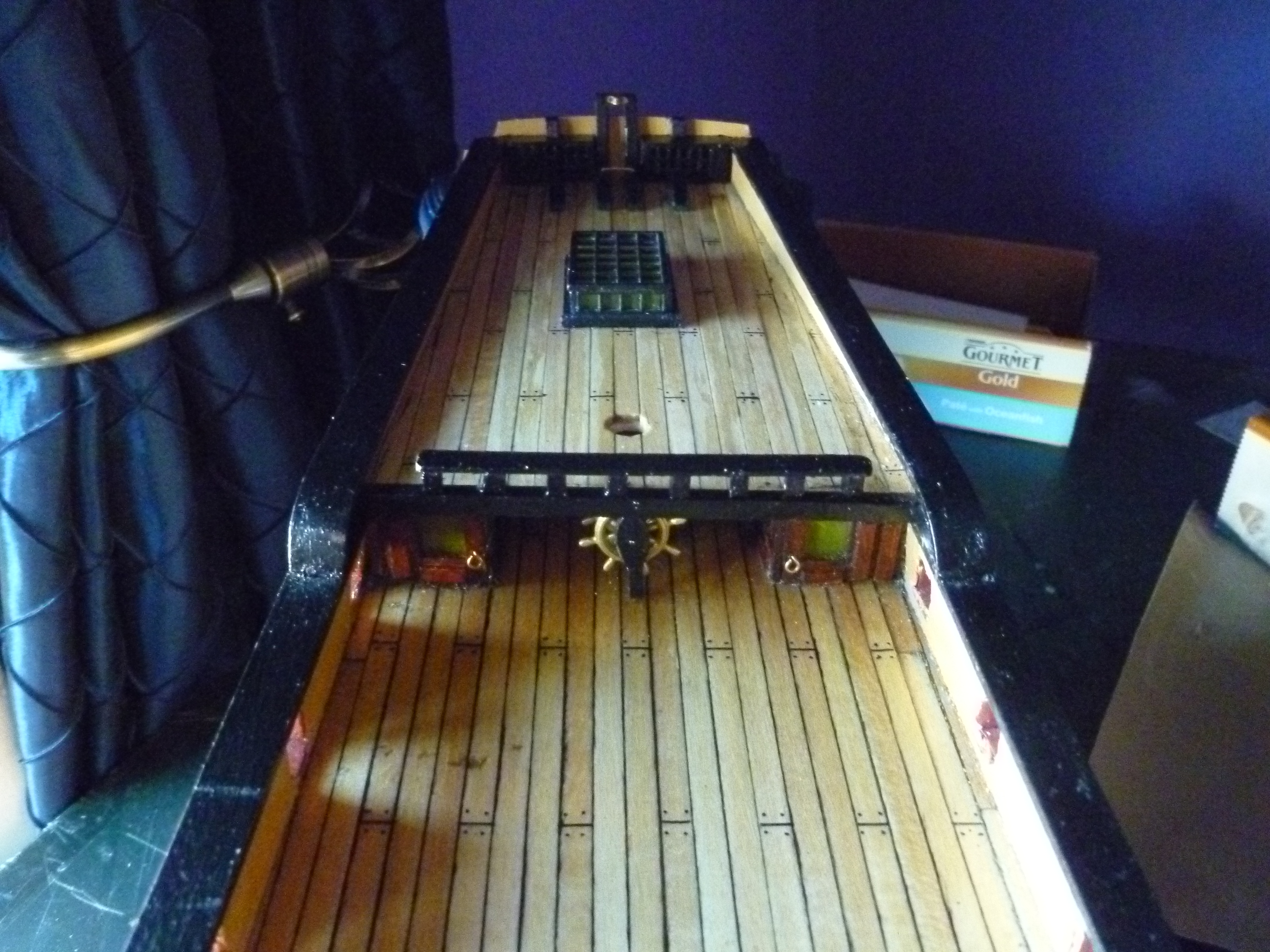

Well i would love to muddy the waters a little... I will apologise in advance Blushing Having looked at the original i suggest you require 8 2mm x 2mm blocks evenly spaced with an overhang to create an authentic look.
PS Photo is authors collection BigGrin
#10 Posted : 06 October 2011 22:53:18
Spot on with the graphic Darron Cool
Personally I would go with an 85mm long rail as already mentioned, I'm awaiting an answer from design as to 83mm being a typo which seems the most likely scenario.

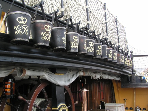

I now have two rails - one 8 block, and one 9 block - so which to use? Well,in the picture kindly proved by Jase there appears to be a net for stowing ropes that is fixed to stanchions which in turn are fixed above the blocks - but do we know if this net will feature as part of the build? If it does I will use the 8 block rail,if however there is no further detail to be added I will use the 9 block rail.
One further point. Below the rail there are 21 fire buckets,clearly this quantity is beyond the scope of the build,but will any be provided - I doubt it as the scale size would make it almost impossible to handle.Perhaps Tomick,with his contacts could confirm this and the point about the netting

looking at the photo my gess for the buckets is 3mm dia x3mm high[ may be try it if get boared]

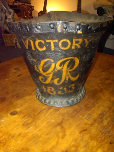

#14 Posted : 07 October 2011 12:55:08
An actual Victory bucket from 1803 and a photo of how they look now.
As for the nets and supporting stanchions for the rail, I've not seen them as yet but that's not to say they're not in the mix.

If you look at the cover of issue 69 you can clearly see the netting is in place. i would work on that basis personally.
As for buckets it would be possible to add them even if not supplied more importantly there is an instrument locker in front of the wheel and as far as I can see we don't get that.
