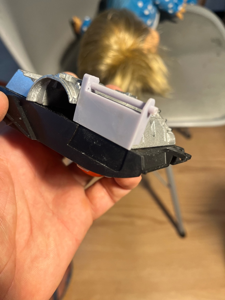

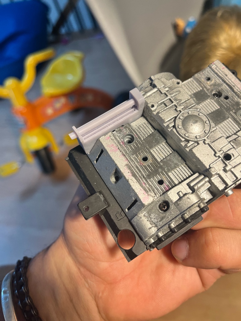

I started from the initial part that starts from the hump of the fan and also finished the last piece of the makeover of the wings next to the fan
I then reassembled the engine to start reproducing the missing radiator and consequently the last part of the air duct.
I start taking the measure and I see that the gearbox half bell stamped on the cylinder block is in the way and makes any project difficult.
The radiator is directly flanged to the monobloc: I finally sawed off part of the bell and created an "orthogonal" space for designing my radiator.
In short, we are still in the cut and sew phase.

The oil radiator is ready….I printed actually thinking of having to redo the “full” piece from scratch by eliminating the pattern…and instead with no small wonder my little Elegoo Mars 3 was able to reproduce 0.2 alternating with holes of 0, 4… I'm happy.
