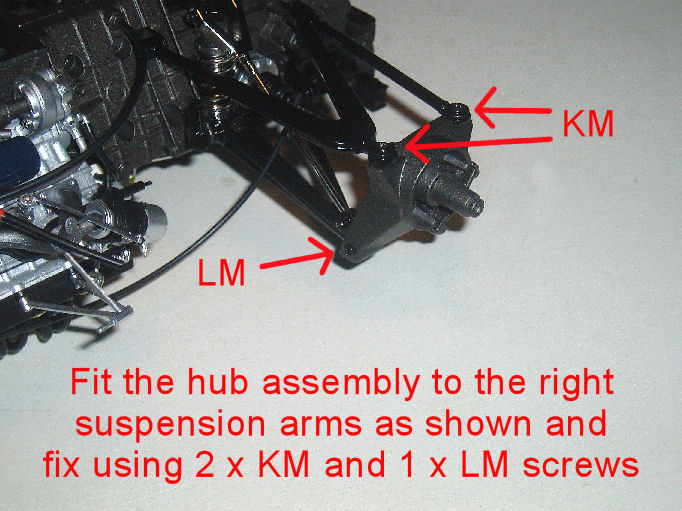

STAGE 60:
The parts in this stage are for assembling more of the right rear suspension.
Retrieve the engine assembly.
Locate the hub parts, 60A and 60B and fit them together. They will only fit one way.
Secure using 2 x BM screws.
Fit the rubber sleeve, part 60D into the hub seal, part 60D.
Insert the driveshaft, part 60E through the rubber sleeve, part 60D from the widest side.
Fit this assembly to the hub, parts 60A/60B and secure with 2 x BM screws.
Fit the driveshaft on the hub assembly into the rubber mount, part 48J on the transmission.
Locate the two mounting points on the bottom of the hub into the two locations on the lower suspension arms, parts 59B and 59C.
Secure using 2 x M screws from underneath.
Fit the top of the hub into the upper suspension arm, part 58A.
Fix using 1 x LM screw from the side.
