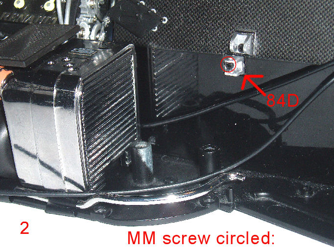

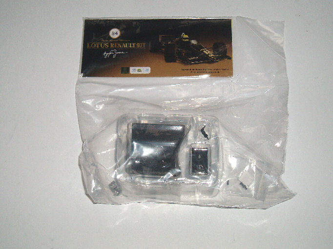

STAGE 84:
Right intercooler duct.
Pic 1: Locate the upper bracket 84E. It has smooth flat faces inside the two side flanges.
Screw the bracket to the body as shown using 1 x MM screw.
The bracket fits on the body with the screw at the bottom.
Pic 2: Locate the lower bracket 84D. It has grooved faces inside the two side flanges.
The bracket fits on the body with the screw toward the rear of the car.
Pic 3: Shows the brackets fitted.
Pic 4: Fit the air duct 84A and the ECU 84C together as shown and fix with 2 x DP screws.
Pic 5: Fit the duct in place on the chassis plate as shown and fix from underneath with 2 x EP screws.
Pic 6: Fit the wiring connector 84B into the hole in the top of the ECU with the thin pin angled inwards as shown and then connect the wire 25D to the pin on the connector.

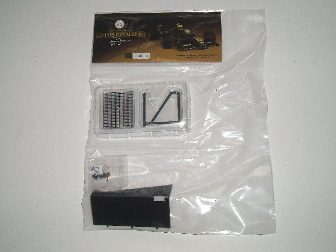

STAGE 85:
Right sidepod.
Pic 1: Retrieve the model and locate the sidepod 85A.
It will fit in the location indicated.
Pic 2: Fit the sidepod as shown and fix with 2 x EM screws.

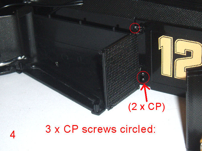

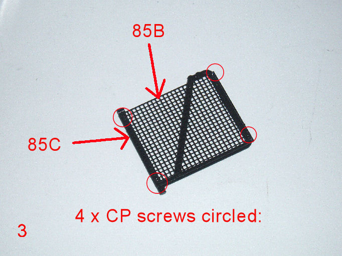

Pic 3: Fit the sidepod front grille 85B and frame 85C together as shown.
Secure with 4 x CP screws.

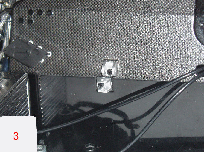

Pic 4: Fit the frame to the sidepod with the double-fixing bracket on the frame at the bottom.
Fix in place with 2 x CP screws at the bottom and 1 x CP screw down from the top.

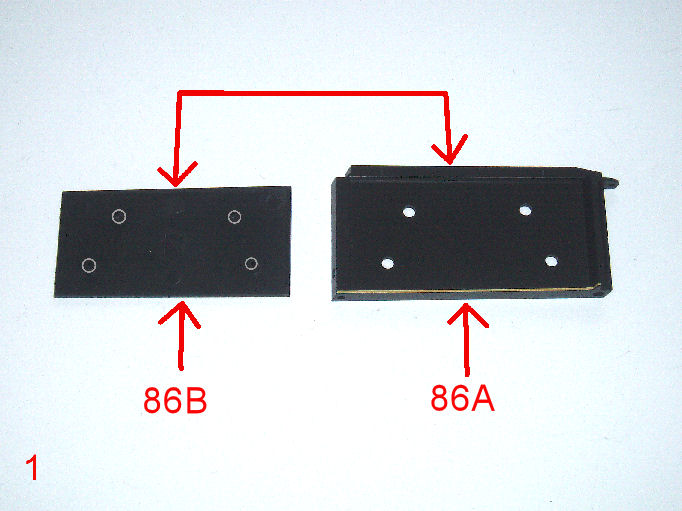

Pic 1: Locate the radiator parts 86A and 86B.
They will fit together face-to-face.

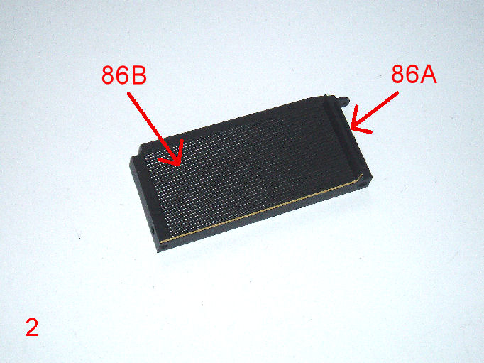

Pic 2: Shows the parts fitted together.

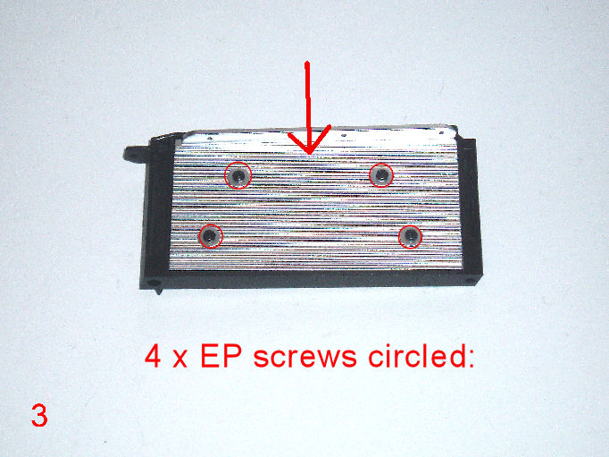

Pic 3: Fit the heat sink panel 86C as shown and fix using 4 x EP screws.
