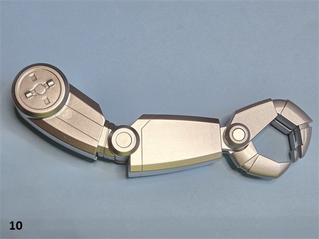

In issue 31 we continue the construction of the Tyrannosaurus Dinozords right arm. Parts supplied.....Pic 1, you will also need the final assembly and the unused part 30.4 from Issue 30.
Start with the assembly from Issue 30 and press fit the forearm plates 31.1 and 31.2 as shown in Pics 2 and 3.
Now position the right shoulder base 31.5 onto the shoulder cover 31.4, Pic 4 and from the inside, fix the parts together using 4 x PWM screws and 4 x 31.6 washers. All shown in Pic 5. Connect the previous assembly to the forearm, by engaging the spindle into the shoulder, Pic 6. Add the second shoulder cover 31.3 as shown in Pic 7, then (whilst holding the parts together) fix them with a PB screw, shown in Pic 8.
Finally fit the screw cover 30.4 (from the last issue) as shown in Pic 9. That`s all for this update with the final assembly shown in Pic 10.

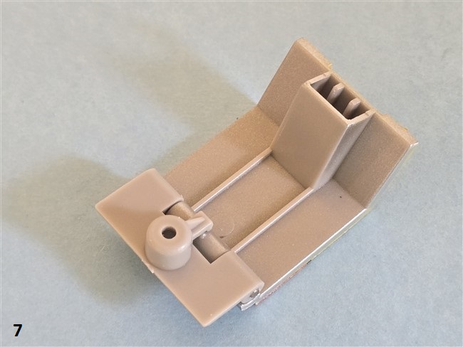

Start with the torso, part 32.1 and either of the side plate parts 32.2, fitting the side plate into the torso as shown in Pic 2 and for clarity, engage the two tabs into the slots (marked A), then press the outer end into place (marked B) all in a close up Pic 3. Repeat this process with the second part 32.2 as shown in Pic 4.
Place the torso centre plate 32.3, the centre plate hinge 32.4 and the hinge pin 32.8 as in Pic 5. Then engage the hinge sections and feed the smooth end of the pin into place as in Pic 6. Finally, press the pin completely into position, so that the knurled end of the pin locks it in place, Pic 7.
