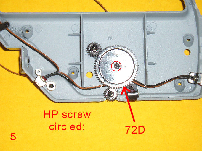

STAGE 72:
Inner door panel.
Pic 1: Fit the LED light wire into the door panel 71A as shown with the correct colour LED’s fitting in the respective sockets.
Pic 2: Fit the wire so it runs inside the window frame channel. Fit the retaining clip 72G and fix with 1 x AP screw.
Pic 3: Locate the thinner cog wheel, 72C and fit it to the upper post inside the door panel. Secure with 1 x HP screw.
Pic 4: Locate the thicker cog wheel 72E and fit it to the lower post on the door panel, with the recessed face upwards. Secure with 1 x HP screw.
Pic 5: Fit the large cog wheel 72D to the central post, between the other two cogs. Secure with 1 x HP screw.
Pic 6: Fit the smaller window, 72B in place, locating the cogged edge in place on the door panel.
Store the door panel and unused window safely for now.
