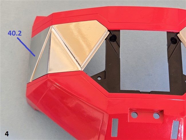

Start with the assembly from Issue 1 and position the left body cover 39.1 as shown in Pic 2, fixing it in place with 2 x PWM screws from issue 39. Shown in Pic 3.
Repeat with the right body panel 40.2 and 2 x PWM screws 40.5 as indicated in Pics 4 and 5.
Next, add the centre plate 40.1 shown in Pic 6 and fix it in position with 4 x PWM screws 40.5, Pic 7.
