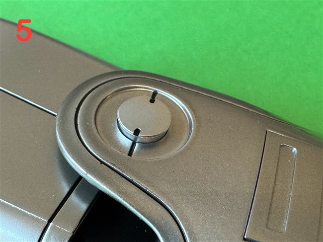

Now the fiddly bit.BigGrin Look at the sprue and take off the screw cap marked 11, picture 3. Take one of the double-sided stickers and place it over the underside of the disk, covering the number, picture 4. Place it into the screw hole as shown in picture 5. Now do the same with the disk marked 12, picture 6.
Secure the other 3 quarter shoulder covers in position using 2 x CM screws for each one. Note: the covers are numbered as illustrated in picture 7.
Repeat the process with the disks as before, noting their positions as I have illustrated in picture 8.
