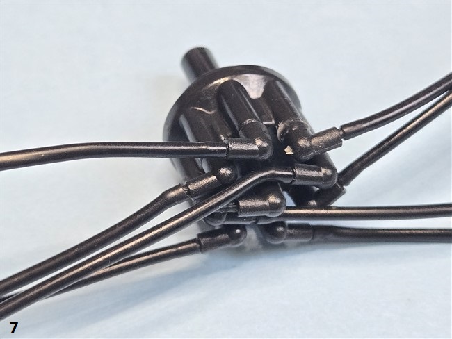

#3 Posted : 10 June 2025 15:53:30
Hi All, BigGrin
It`s 1:6 Mustang time with Issue 90.
Parts supplied.....Pic 1, you will also need the engine assembly from the last update.

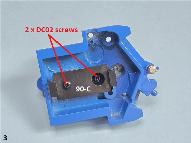

Start by press fitting the connector 90-F into the engine front 90-A as in Pic 2.Then on the inside of the engine front, fit the front support 90-C and secure it with 2 x DS02 screws as in Pic 3. Carefully store this assembly for later use.
Remove a distributor connector 90-D from the fret and press the thin pin into one of the ignition leads 90-G, shown in Pic 4. Repeat this process seven more times so you have eight leads with a connector attached to each.
Remove a ninth connector 90-D from the fret (tenth is a spare, keep it safe) and fit the "D" shaped pin into the centre hole in the distributor 90-B, Pic 5.
Take one of the connectors on its lead and fit it into a position in the top of the distributor, Pic 6. NOTE: the "D" shaped pins and holes determine which way each lead lays and a "very small" spot of glue can be used if a connector is a loose fit.
Now fit the remaining seven leads/connectors in the same manner, Pic 7.
Turn the previous assembly upside down and fit the distributor base 90-E to it, Pic 8. This part will only fit in one position due to the slot and protrusion on the parts.
Carefully hold the distributor parts together and position them into place on the engine assembly from the previous update, Pic 9. Again this parts orientation is determined by another key and slot. Finally fix the distributor into its position from underneath, with a PS02 screw. Shown in Pic 10.
The end results of this update are shown in Pic 11.

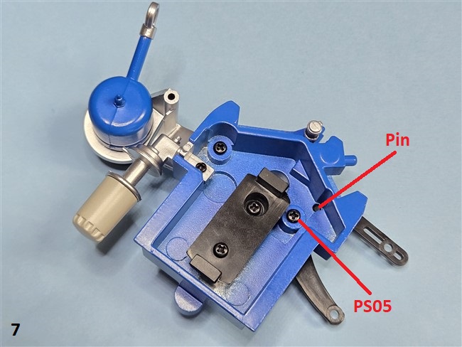

Take the engine front panel and place the pump onto the outside, as shown in Pic 6, fixing it into place from behind the panel with a PS05 screw as in Pic 7.

Next position the starter bracket 92B onto the front engine panel, (using the locating pin for orientation), Pic 6 and fix the bracket from behind the front panel with a PS05 screw as shown in Pic 7.

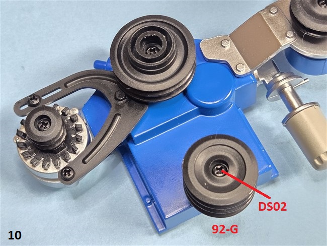

Staying with the engine front panel, add the pulley 92-F fixing it into position with a DS02 screw, Pic 9. Then add the next pulley 92-G, fixing its position with a further DS02 screw, Pic 10.

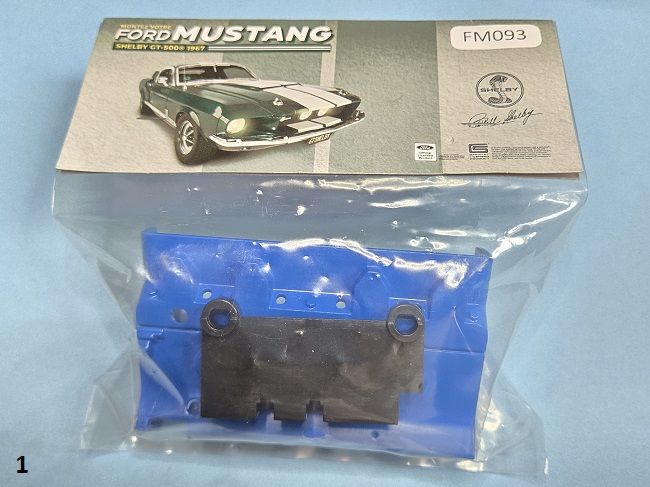

Final issue #93 of this pack is a parts supply only, Pic 1. Crying
