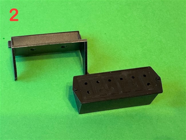

Fitting the Detect-A-Scope Screen

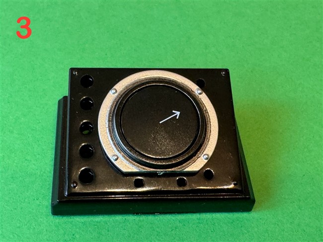

Begin by slotting the detect-a-scope screen (81C) into the bezel (81B), picture 2. Fit the assembly to the console (81A) and secure it using 2 x KP screws, pictures 3 and 4. Fit the LED housing (81D) as shown in picture 5, using an AP screw.

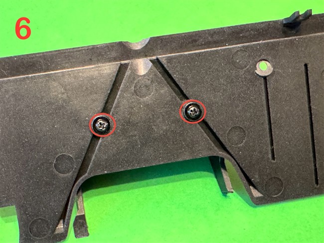

Warning: This next part is very fiddly. I would recommend using your fingers only (not tweezers) for the placement of the knobs around the console. They are quite hard to push in. If you have the same problem, take some of the excess paint off the pins, this will help. I also used some glue on the inside of the console once the knobs had been fitted to hold them in place.
Follow the illustration in picture 6 to insert the knobs in their respective positions.

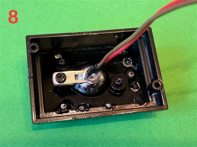

Before attaching the scopes LED, you must first detach it from the wiring loom on the car. The LED to use is marked “M” as shown in picture 7. Now place the LED to the underside of the console pushing into the hole in the LED housing, picture 8. Note: I also used a little glue to hold it in place. Fit the completed console onto the upper dashboard and secure it in place using 2 x AP screws, pictures 9 and 10.

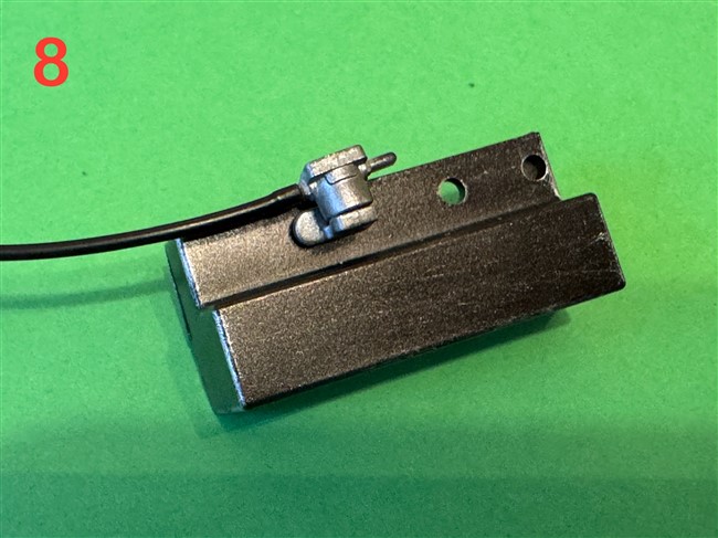

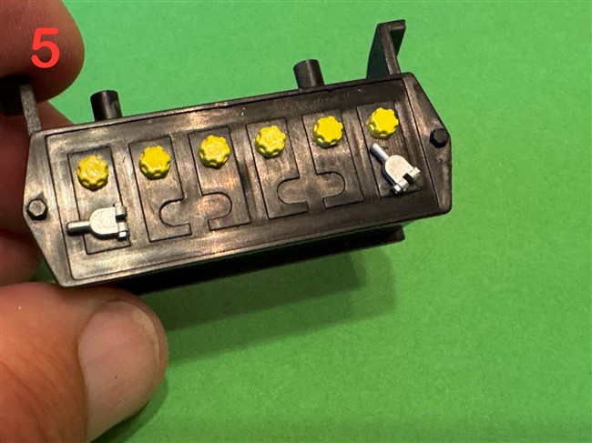

Assembling the Fuse Box
Connect parts (84C) to (84B) as shown in picture 2. Note: they will only fit one way. Attach the cable to the pin on part (84B) picture 3. I found it easier to apply the cable if you push a cocktail stick in the end to open the hole slightly.

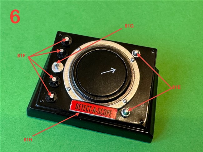

Assembling the Battery and Starter Motor
Before starting with this issue, please note that I have painted some of the parts as I have with the rest of the engine bay. Feel free to do the same if you feel confident in doing so. Although it is not necessary to paint the parts, if you do, it is at your own risk.
Take the battery (85A) and the battery bracket, picture 2 and secure then using 2 x TP screws, picture 3. Push the two terminals (85D) onto the battery, picture 4. Push fit all six of the vent plugs (85C) as shown in picture 5. Now secure the assembly onto the firewall using 2 x TP screws, pictures 6 and 7.
