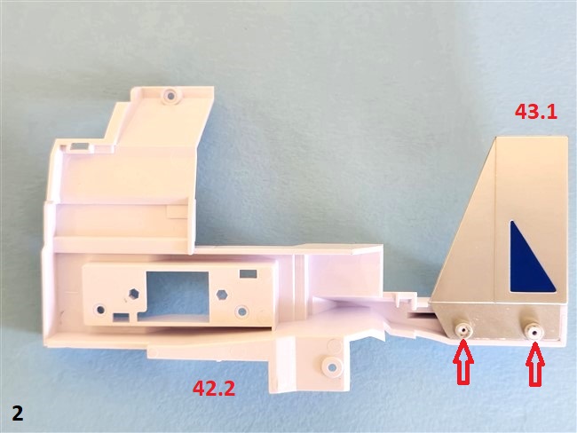

Start with the left side tail structure 42.2 and press fit the left rear wing 43.1 onto the posts as shown, Pic 2.
