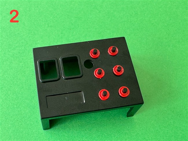

Place the six button washers onto the six pegs, picture 2. Make sure the flat side is touching the control box. Push fit the six buttons, so they sit over the washers, picture 3.

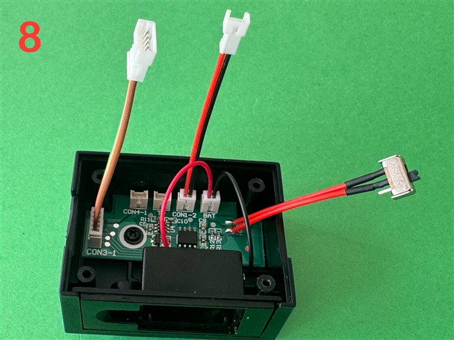

Issue 26
The Belt
Take the metal grill and place it on the control panel. You will need to peel it from the paper. Take care when doing this. Turn the assembly over and push in the two green lenses, picture 4. Tip: Make sure you push the two green lenses all the way in.
Fit the washer for the red light and then the red light, picture 5.

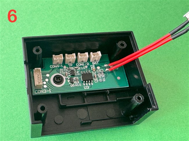

Place the printed circuit board inside the control panel and secure it in place using the type “I” screw, picture 6.
Connect the extensions cables 1 and 2 into the circuit board as illustrated in picture 7.
Slide the battery box into the control box and connect the power cable to the right end terminal on the circuit board as shown in picture 8.
Place the battery cover over the battery case and secure with a type “Q” screw, picture 9. Note: The battery case takes 3 x LR44 batteries. If you have some batteries, then place them in the battery box.
Picture 10 show the complete assembly for this issue.
