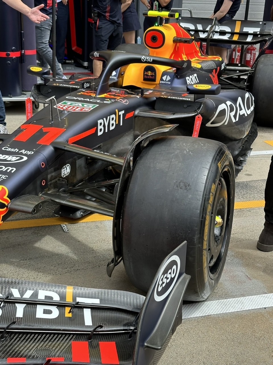

And now let's start with the "shopping list of defects/shortcomings"
- oversized tire shoulder ribs
- incorrectly shaped lenticular funnel
- lenticular color too opaque
- lenticular support ring details too evident
- no tire valve
- no barcode labels on tire shoulder
- no writing on tire shoulders
- no balancing weight on external lip
- no Dutch flag sticker on external lip
- no wear holes on tire footprint
as desired: no tread wear and rim bead too new, in many photos and races it is marked.
Redoing the lenticular and the valve is not a problem, now I have to decide (but I think without even thinking too much) to redo the tire as well.
I will wait for the decal until the end because I think there will be a lot of integration to do.

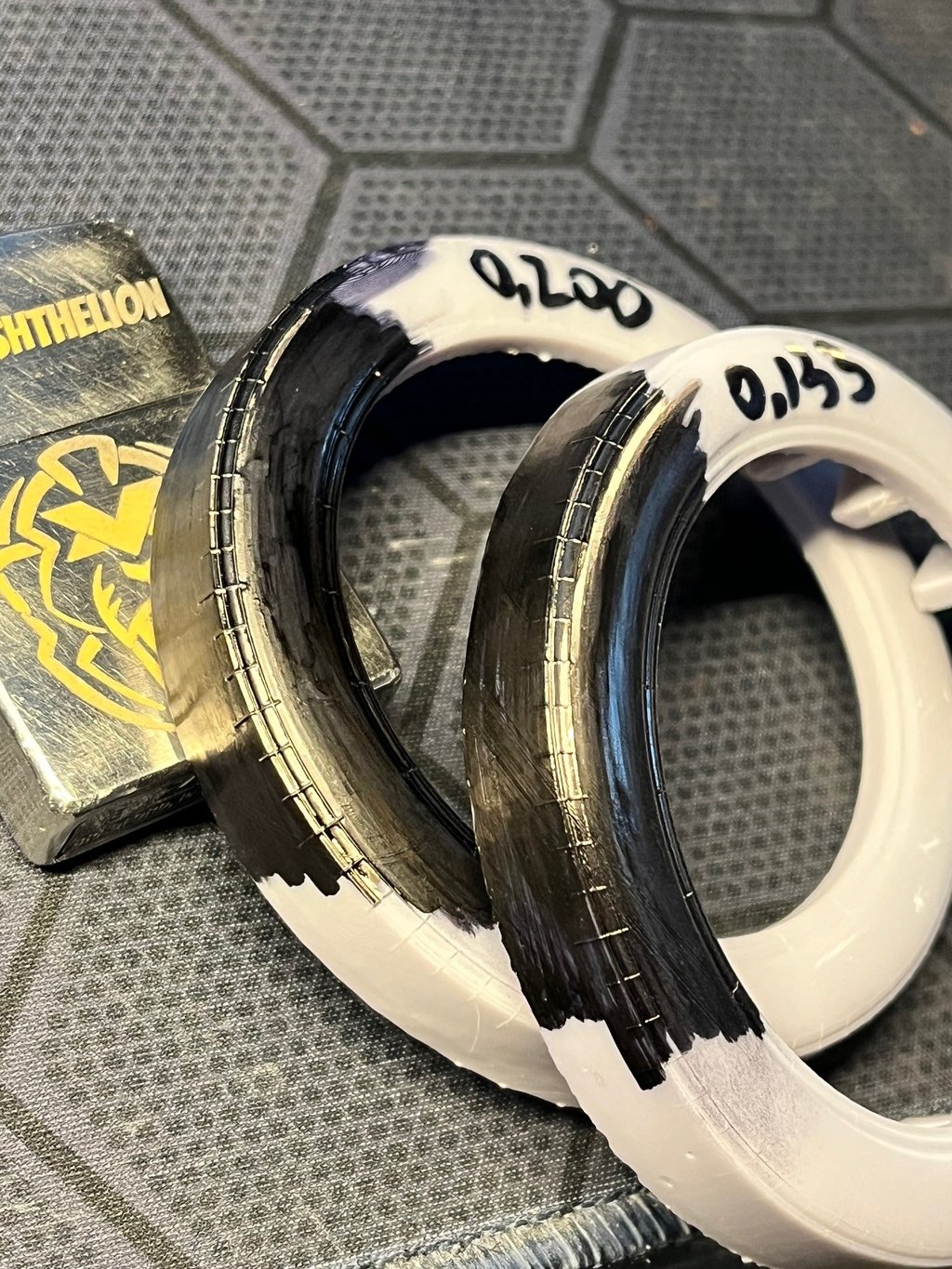

I've printed the second beta test.
The phone camera can't handle grays, so I used the marker to highlight the lines
I compared the 0.2 mm with 0.133 mm and compared them with the enormous ones from the kit.
The 0.2 mm seem right to me, hoping that the primer and color don't drown these ribs too much
A few more finishing touches and then I'll move on to printing the entire tire (which I'll have to tilt): the x and y planes of the print bed of my Mars don't contain this rubber beast that measures 88 mm Blink

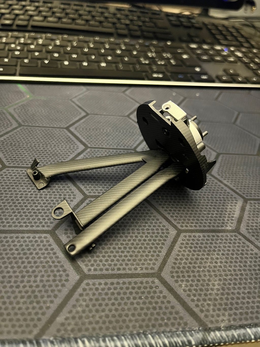

Stage 4
First part of the front left wheel suspension hub group.
The twill weave of the carbon dominates.
Two round pieces and a PE strip.....more than PE a real metal ribbon engraved with micro ventilation holes and a metal toroid: they simulate the carbon disc.
The arms in their shape are correct, chromatically they are not right.

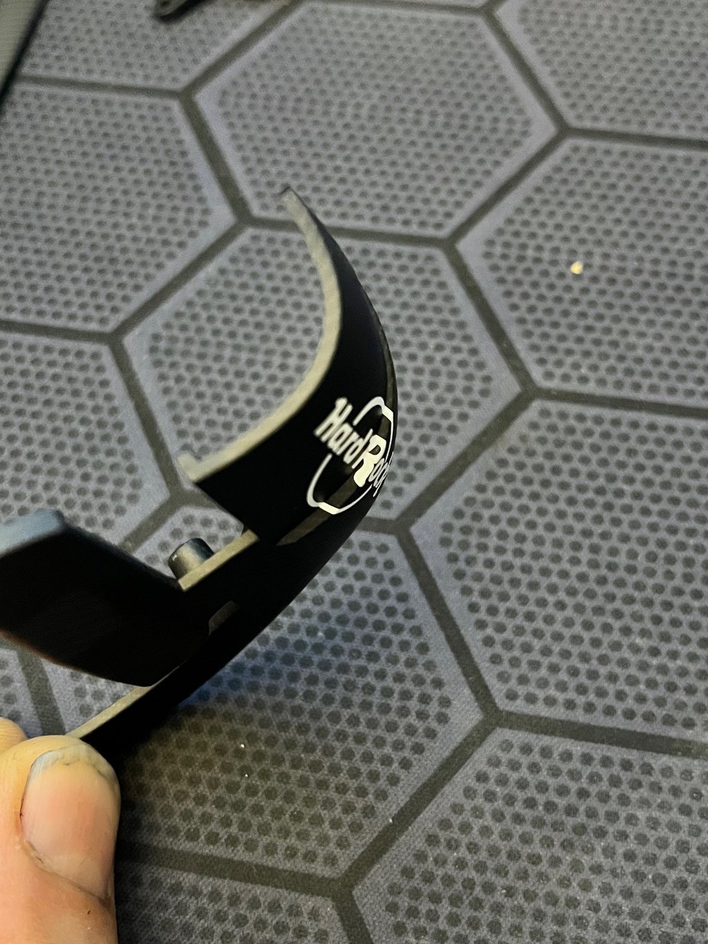

The rear cover of the hub (which in reality is a single piece with the air deflector with the Hard Rock sponsor) is always all in twill weave...when in reality it is a puzzle of chequered carbon with various reinforcement strips of finer weaves.

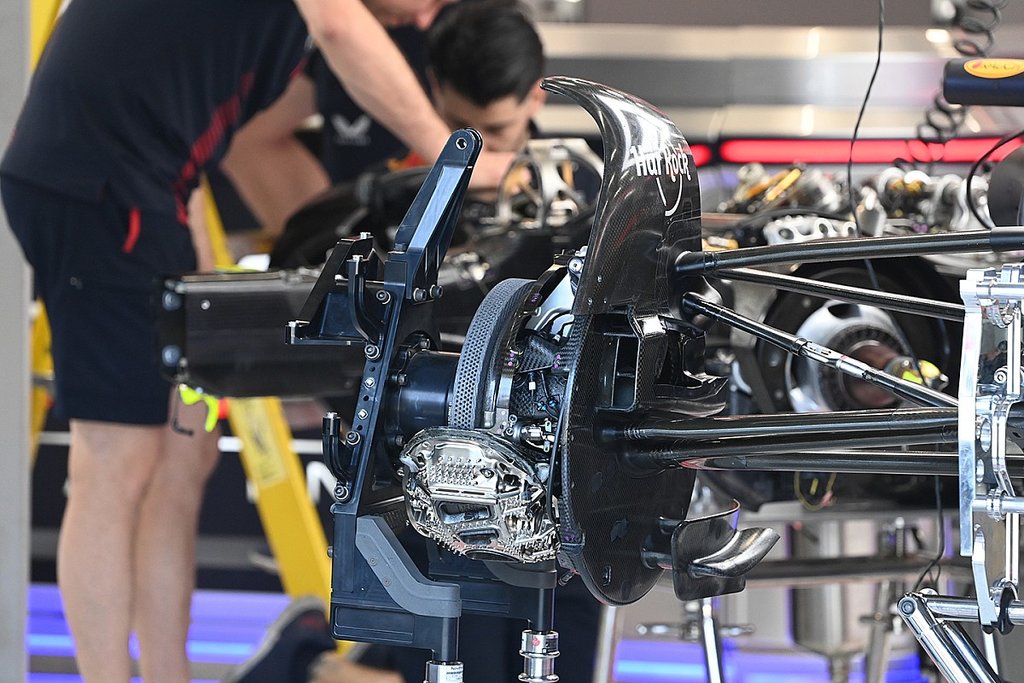

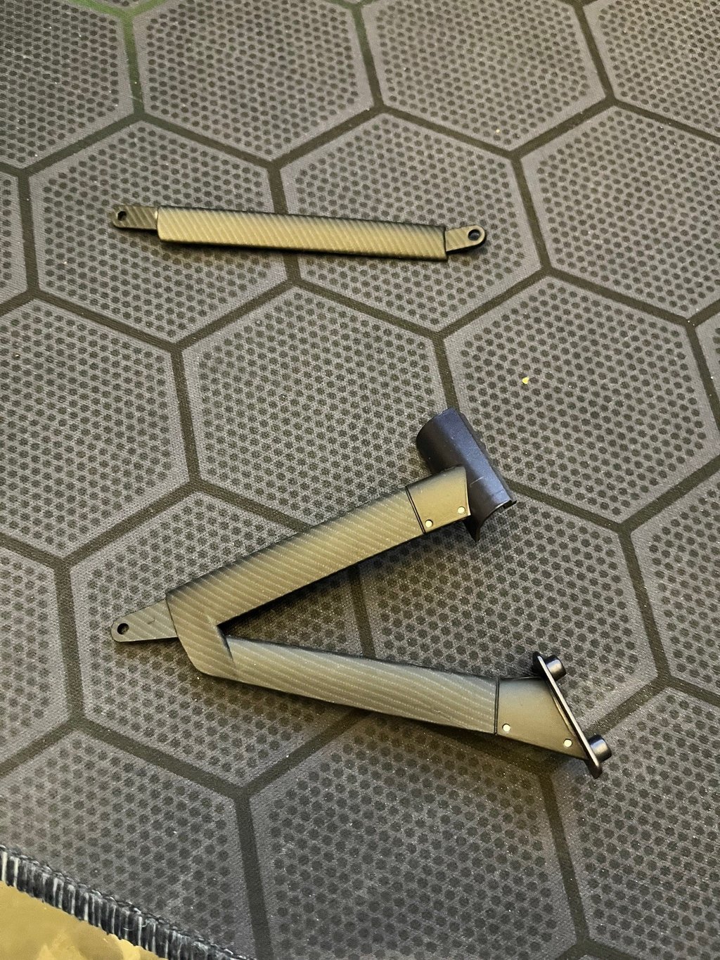

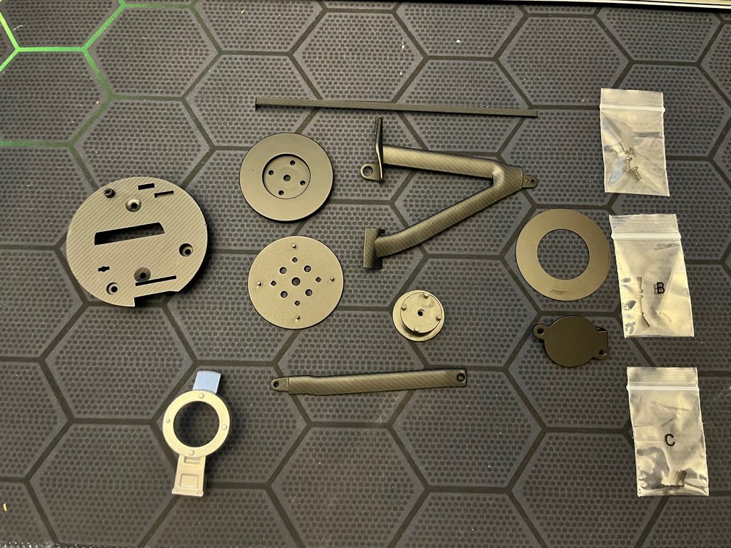

Here the components to continue assembling the suspension group, steering, left front hub.
Always twill weave and incorrect colors; but the first mini macro details that catch the eye are starting
The deflector or fin above the wheel has various functions, and one concerns aerodynamic flows.
It has an open gill in the upper curved part and 2 open gills in the lower area that serve to channel the air where Newey wants it.
In the kit everything is closed.
The arm that adjusts the camber angle has a cover that reveals the adjustable tie rod. Here the arm is flat and smooth
Then the small air intake on the brakes needs to be reviewed.
Carbons and colors to be redone.
I'm then waiting to see the final part of the hub hoping that they made the correct nose cone with the 3 fins... otherwise I'll get back to work with the 3d.

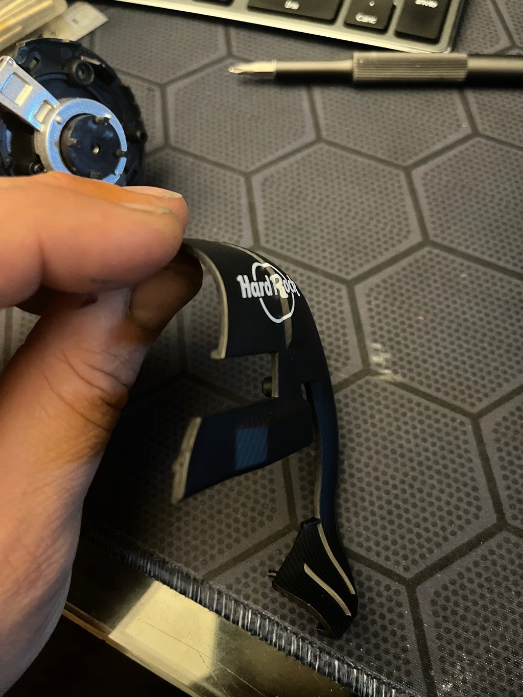

From the various photos you can see that the suspension arms and the various tie rods are all built with a very fine composite.
Depending on the light they appear black, in others a dark gray brown, in others an almost gunmetal gray.... the usual trap of the textures like on the McLaren mp4/4.
As already said, the camber adjustment cover is missing and the attachments to the frame need to be reviewed in their color.
The carbon of the rear hub deflector is a chequered with various patches, here and there and with various insertions of other fibers especially in the cutting area.
I'm not going to look at the hub and the disc, I'll cover everything with the basket when it arrives
In the meantime that my Mars produces the first tire (I've reached V.04) I started working on the deflector by opening the gills.
Depending on the race (like Monaco) they added flaps in the lower part of the deflector perhaps to better channel the flows towards the flat bottom.
For now I'll open them, then I'll see which race to christen (which will necessarily be the first part of the season before they changed the side pods and radiator air intakes).

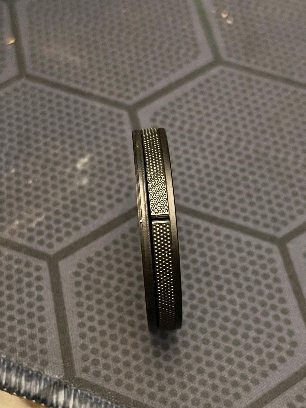

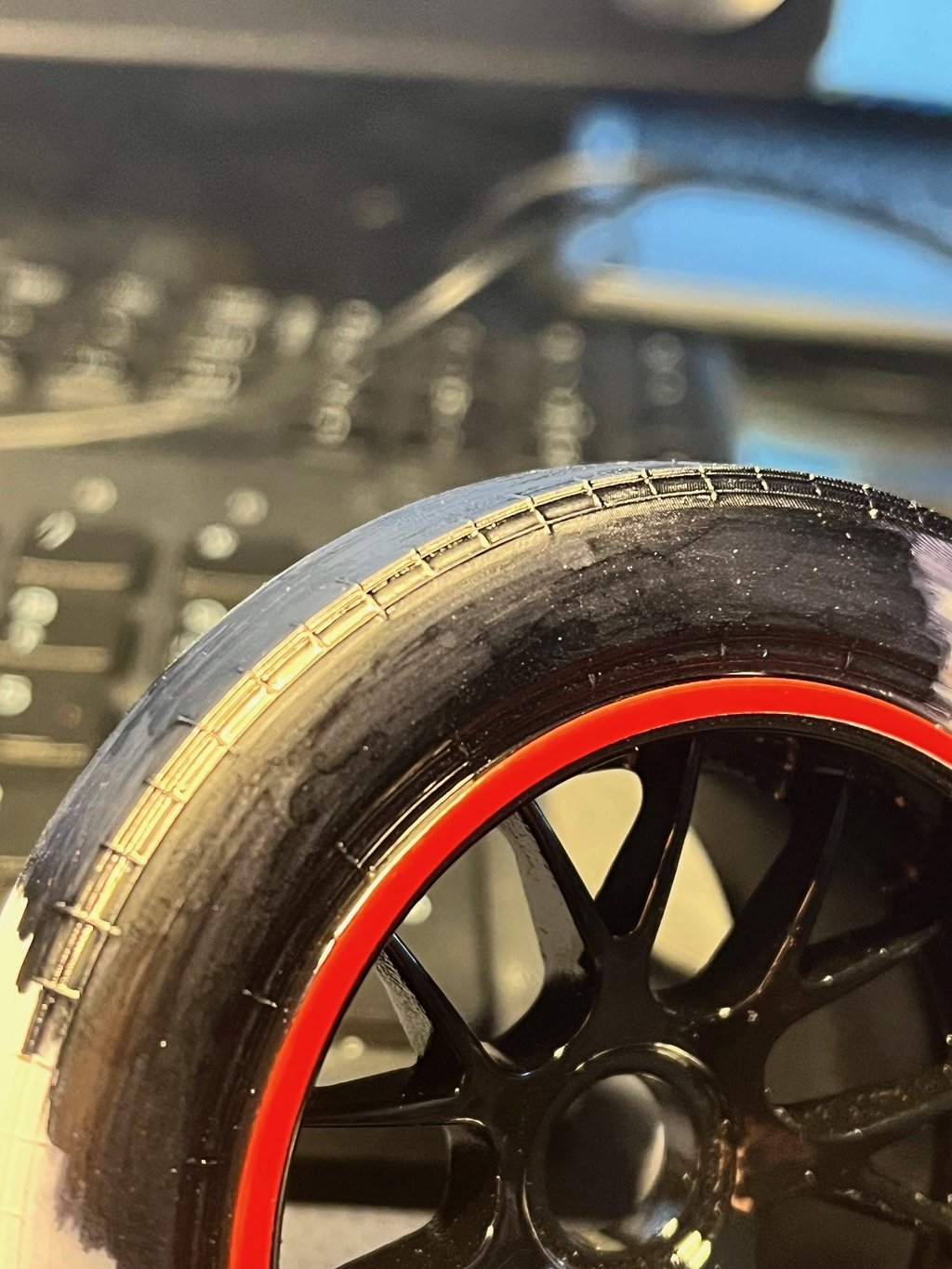

I printed rubber, and to limit the sprue pins as much as possible, I printed it standing up instead of lying on the shoulder.
I wet sanded it with 800 to even out where the layers were visible and as far as I could without erasing the ribs.
I then moved on to the primer and two coats of gloss black.
6 hours of drying and then I started studying how to make a minimal wear effect from a single running-in lap look realistic as is done for the installation lap or when they leave the pits for the last time to then go to the grid before the start of the GP.
I passed a 3m microfine sponge to opaque it, then I used the black rubber tamiya brushing it in a wild boar fashion back and forth.
This has (imagined and also unexpectedly) produced what happens with paints (especially Tamiya), the brush carries the first layer and creates accumulations and veins that would make you swear, here instead they are just right for me generating a pick up effect like marbles left on the track or in pit lane.
The opacity and roughness were already good, I evened it out with a general pass of wheatering "soot" only on the footprint on the ground.
The effect seems plausible and acceptable to me
For the decals I'll wait (even if I already know that they will be soft and therefore red stripe) when I will do the total cart of everything that will be added.
After a week between studying photos, profiles, importing profiles, my tire is a little better than the kit tire.

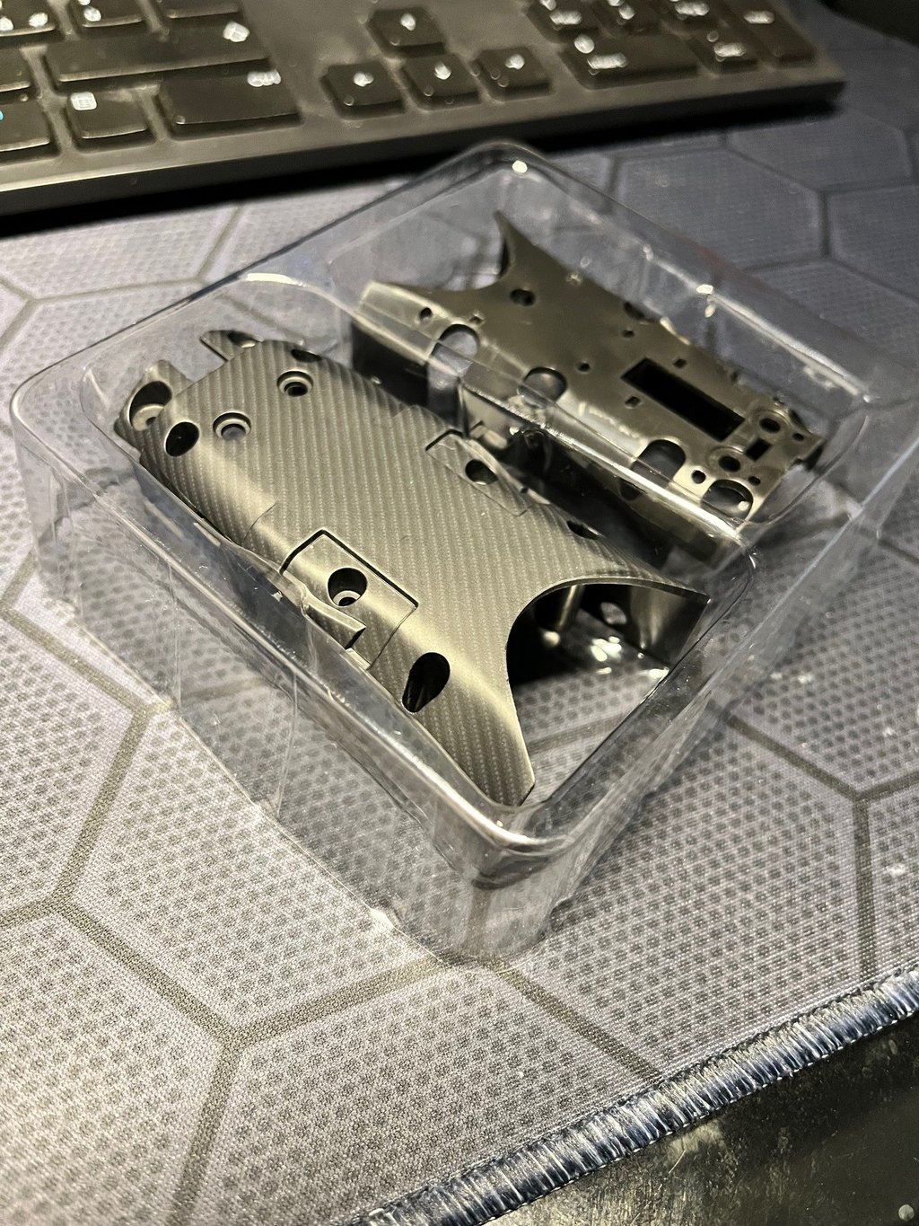

The first lower part of the survival cell has arrived. Here too, the carbon fiber ribbon twill...but the texture doesn't even remotely resemble the real thing, whereas on the MAX single-seater, it's a much thicker, chequered-like texture. I'm almost certain the FIA logo is missing, but I'm waiting for the upper part.
Anyway, we'll do it again today; we'll assemble it tomorrow.Glare

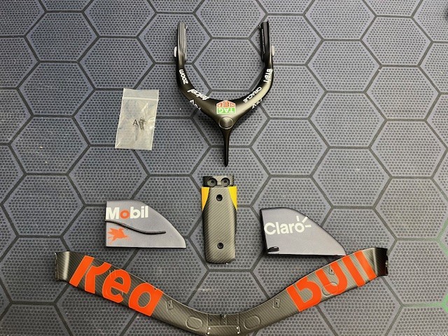

#17 Posted : 01 August 2025 10:46:48
Joined: 05/04/2016
Posts: 720
Points: 2,163
Location: Ferrara
Last shipment: the upper and lateral protection around the helmet and shoulders. A sort of foam "collar" that is put on once Max is in the cockpit, then removed and pressed down.
I was hoping not to even look at the part here, but alas, there are some differences, which I had to keep.
The 1:1 has some bumps that are likely to be helmet stops when taking fast corners with more lateral G. I think they provide additional lateral support to avoid excessive strain on the neck.
Under the mini headrest cushion, there is a recess...completely missing.
The Mobil One decals on the side are larger than they should be.
In short...a lot of stuff.Huh
