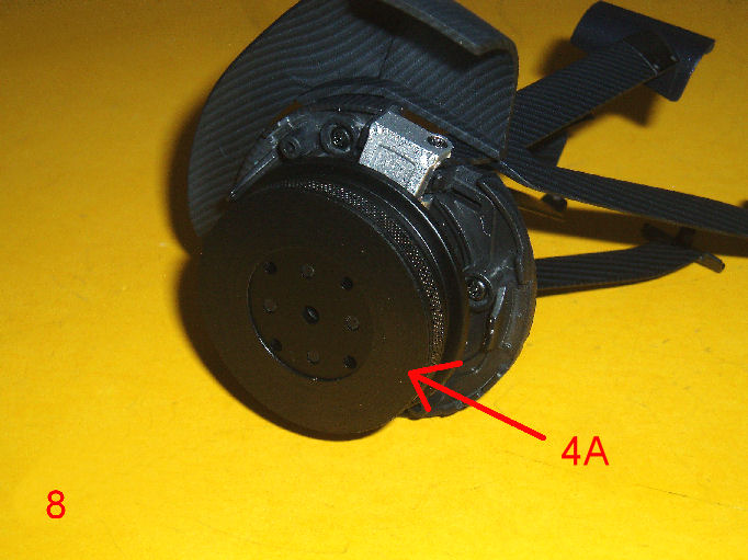

Pic 1: Locate the brake parts 4A and 4D.
Note the highlighted slot in 4A.
Pic 2: 4D has one end ‘hooked’. Fit this end into the slot in the disc 4A.
Pic 3: Wrap the strip 4D around the disc and fit the other end into the slot, bending the tab over inside the disc to keep it in place.
Pic 4: Press-fit part 4B into place as shown.
Pic 5: Peel the backing paper from the metal disc 4C and stick it in place on top of 4B.

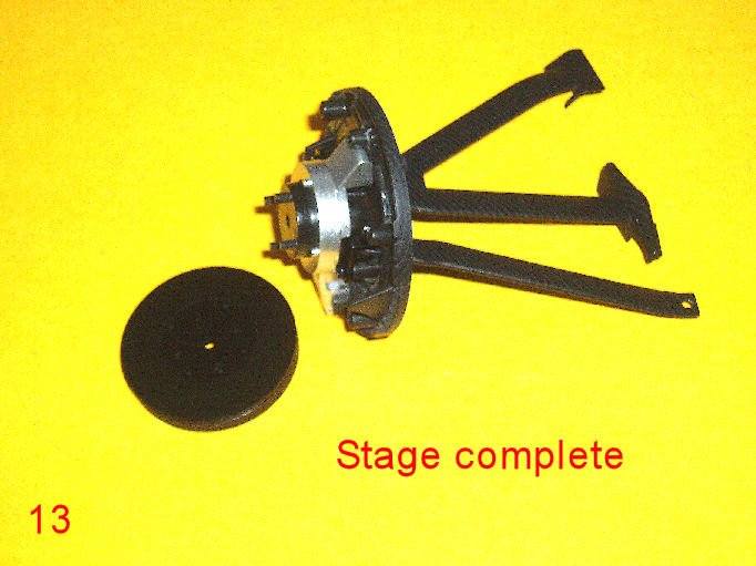

STAGE 4B:

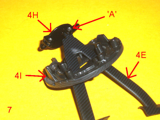

Pic 6: Locate the suspension parts 4H, 4I, 4E and 4F.
Pic 7: Fit the arm 4E through the slot in 4I and attach it to the right slot in the plate 4H. Fix using 1 x ‘C’ screw.

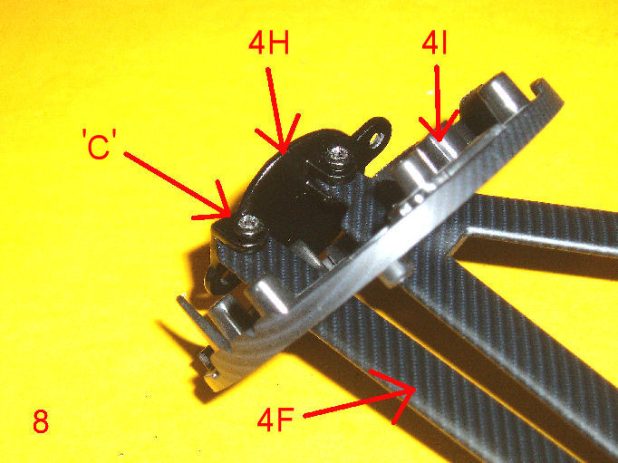

NOTE – The printed instructions incorrectly call these screws ‘A’.
Pic 8: Fit the arm 4F through the slot in 4I and attach it to the left slot in the plate 4H. Fix using 1 x ‘C’ screw.

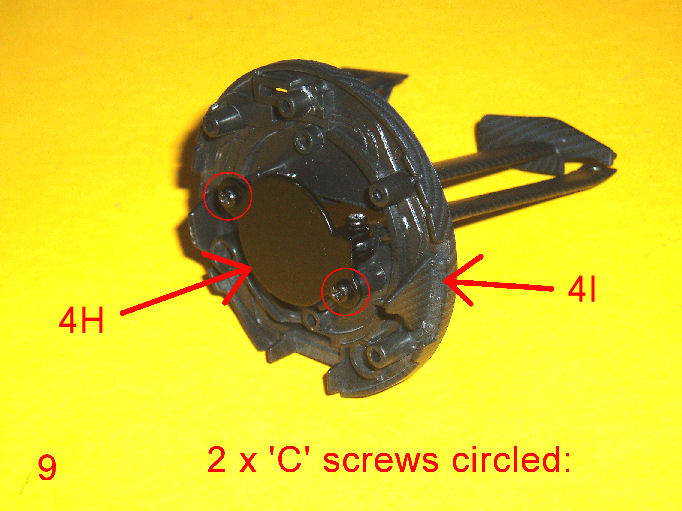

Pic 9: Fit the plate 4H to the hub 4I as shown and fix using 2 x ‘A’ screws.
Pic 10: Assemble parts 4G and 4J as shown.
Pic 11: Fit the assembly to the hub as shown.
Pic 12: From the other side of the hub fix the parts together with 2 x ‘B’ screws.
Pic 13: Store these parts safely for now.

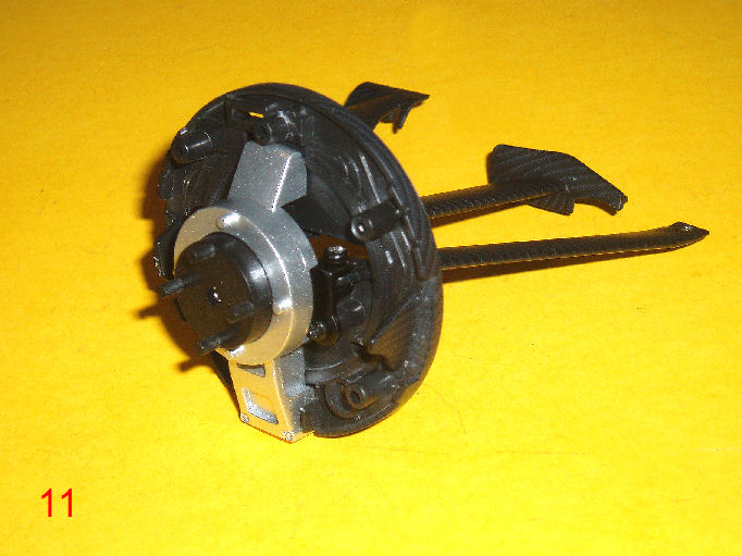

#4 Posted : 22 June 2025 12:09:22
Posts: 5,856
Points: 17,720

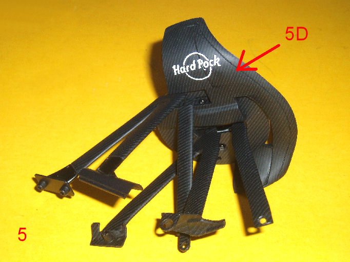

STAGE 5:
Front left suspension.

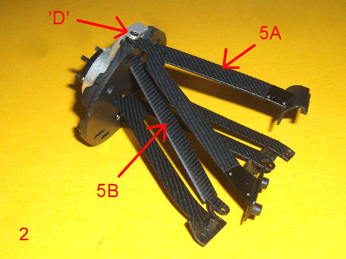

Pic 1: Retrieve the suspension assembly from the previous stage, and parts 5A and 5B.

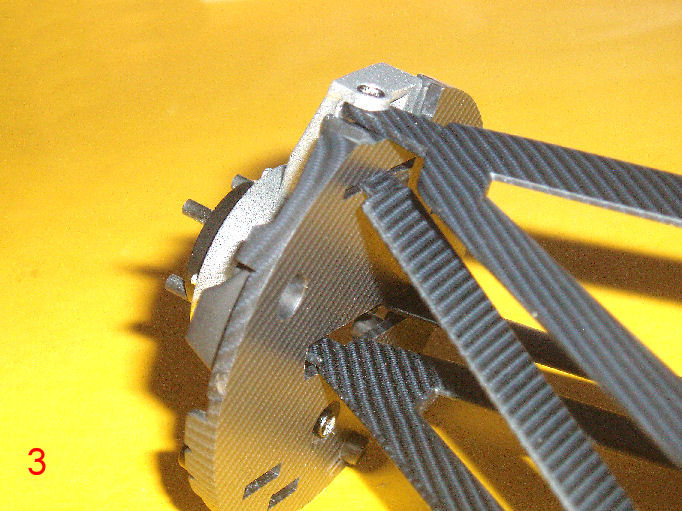

Pic 2: Fit the upper arms 5A and 5B to the main hub as shown.
Fix the parts together with 1 x ‘D’ screw through the top of the hub.
Pic 3: Shows close up the assembly and fixing of 5A and 5B.
Pic 4: Press-fit the air intake 5F into the slot in the hub.
The part must have the flat vertical side toward the centre of the hub.
Pic 5: Fit the brake cowing 5D to the hub as shown.
Pic 6: Fix the cowling in place from the other side of the hub using 2 x ‘A’ screws.

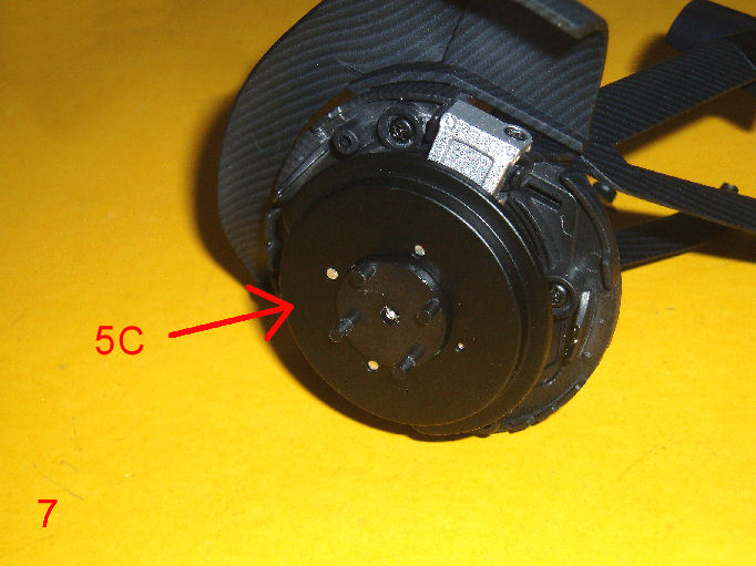

Pic 7: Fit the brake plate 5C to the centre of the hub.
Pic 8: Press-fit the assembled brake disc to the hub with the metal outer ring to the outside.

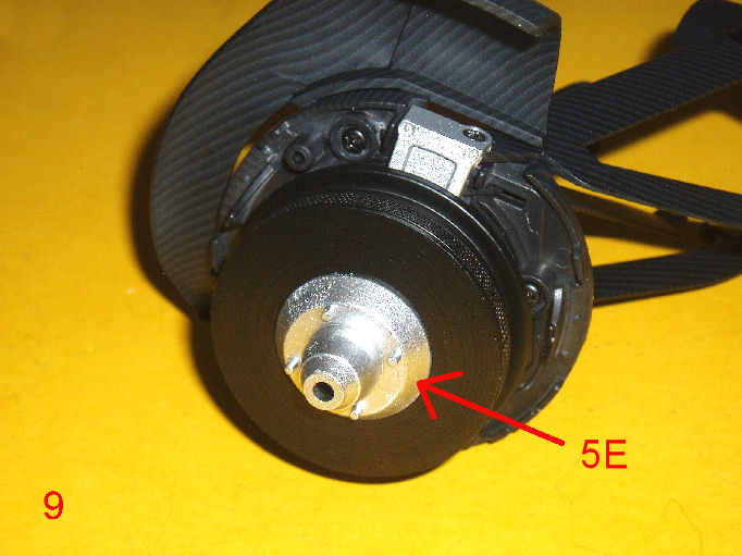

Pic 9: Press-fit the outer hub 5E in place.
