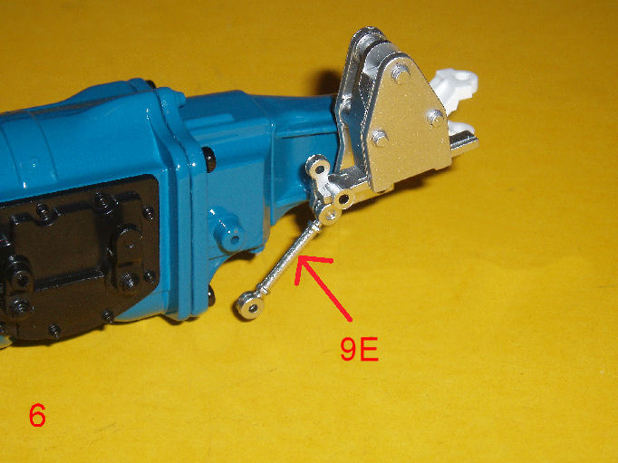

Pic 6: Fit lever 9E to the lower hole in the bracket as shown.

Pic 7: Fit lever 9D to the upper hole in the bracket and the other end to the pin inside lever 9B.

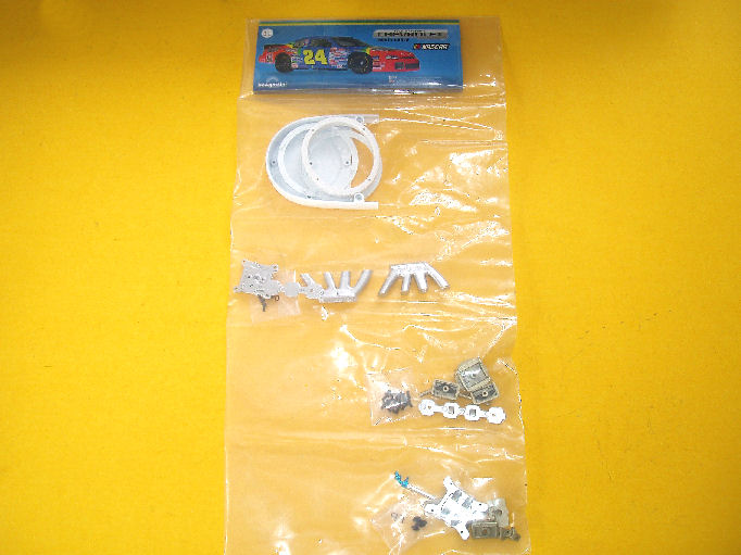

STAGE 11A:
Air filter and carburettor.
Pic 1: Locate the manifold parts 11E, 11F and 11G.
Note the parts are marked ‘L’ and ‘R’.

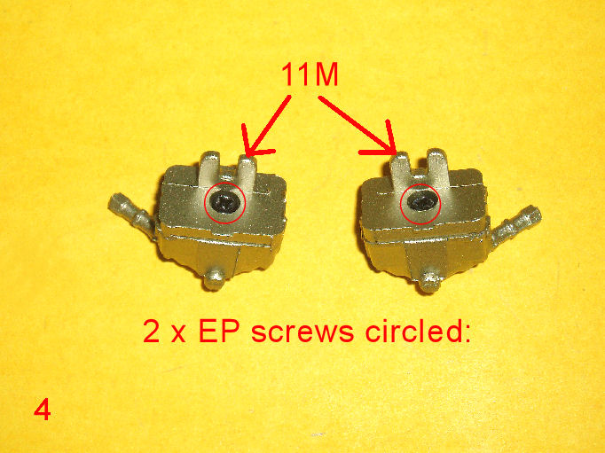

Pic 4: Fit the base 11M to each pump and fix with 1 x EP screw.
Pic 5: Locate the flange 11O and fit the two assembled pumps as shown and fix them using 2 x FP screws.

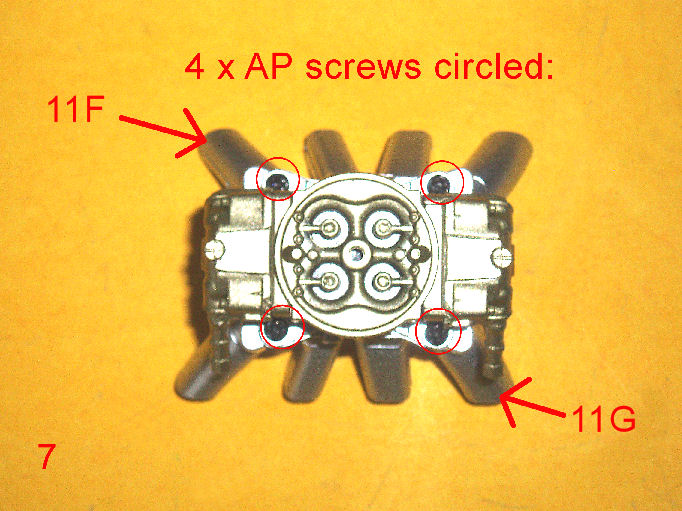

Pic 7: Fit the carburettor to the manifold assembly as shown and fix using 4 x AP screws.

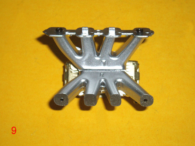

Pic 9: Shows a different view of the assembly.
Pic 10: Fit the manifold flange 11I to the manifold 11G. Fix in place with 2 x EP screws.

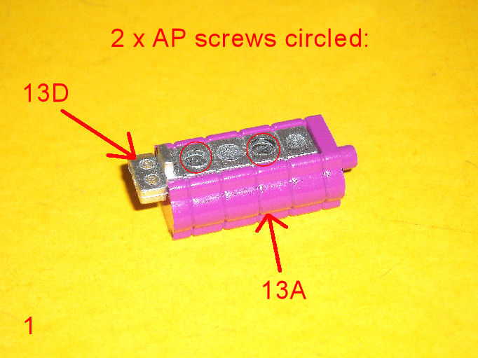

Pic 1: Fit the oil pump and bracket 123A and 13D together. Fix them using 2 x AP screws.

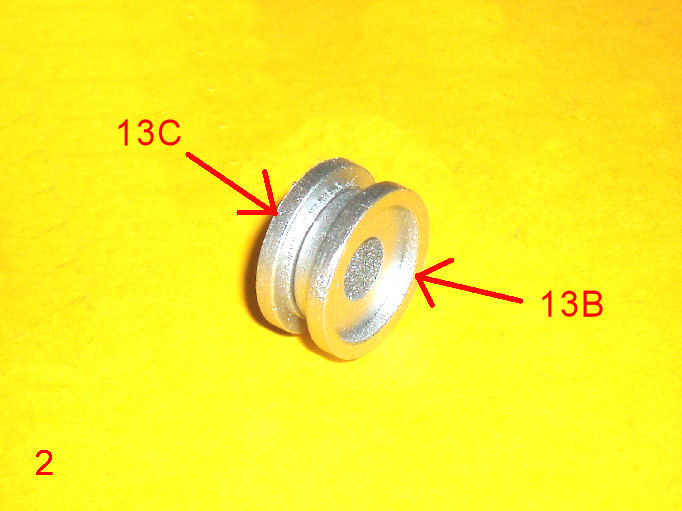

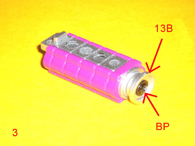

Pic 2: Fit the two pump pulley parts 13B and 13C together.
Pic 3: Fit the pulley to the pump as shown with the pulley part 13B outwards.
Fix with 1 x BP screw.

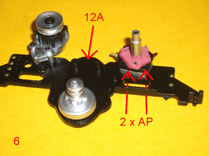

Pic 6: Fit the assembly to the right upper side of the frame 12A and fix from behind with 2 x AP screws.

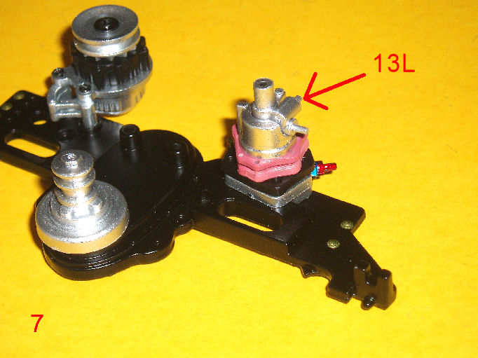

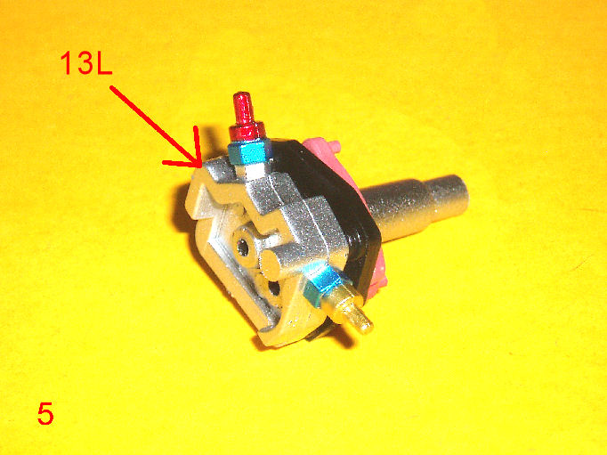

Pic 7: Fit the power steering pump 13L over the shaft on part 13J.

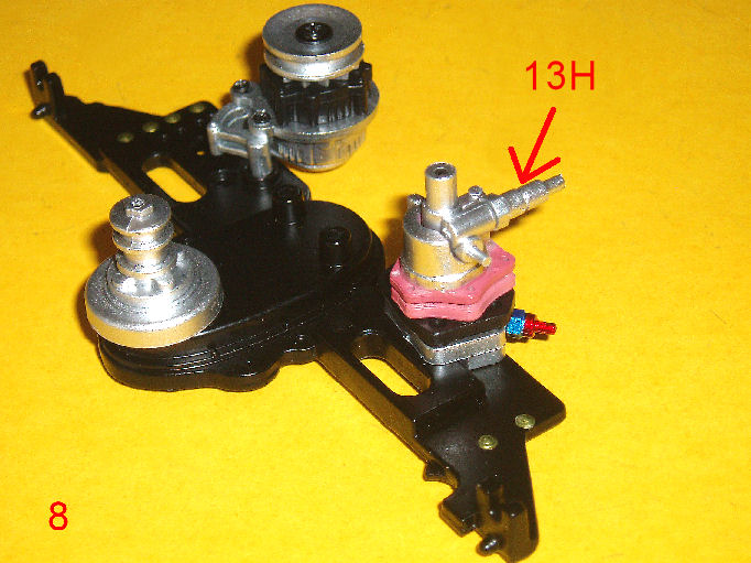

Pic 8: Fit the pump spigot 13H to the pin on the steering pump 13L.

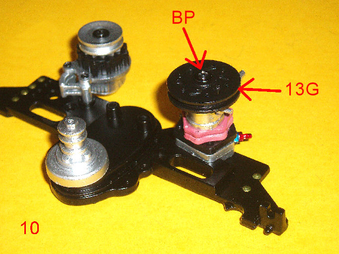

Pic 10: Fit the pulley to the end of the oil pump as shown with part 13G uppermost. Fix with 1 x BP screw.

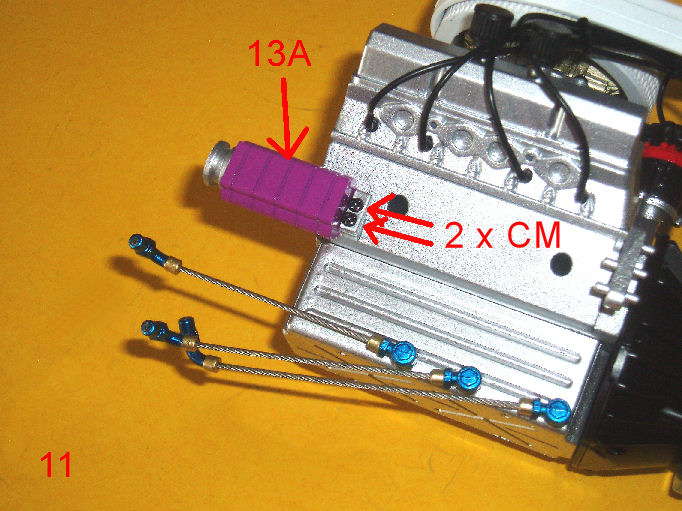

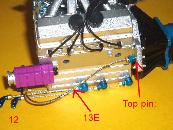

Pic 12: Attach the straight end of the oil line 13E to the top pin on the bracket at the rear of the engine.
Pic 13: Fit the other curved end of 13E to the outer hole on the sump pump as shown.

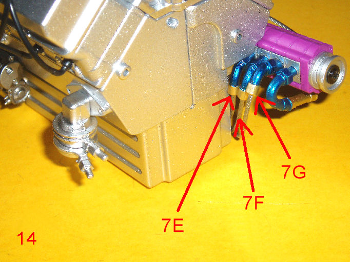

Pic 14: Fit the other three oil lines 7E, 7F and 7G in order to the other three holes in the pump.
HINT – You may find it easier to remove the pump from the engine to fit the oil pipes and then re-fit it afterwards.

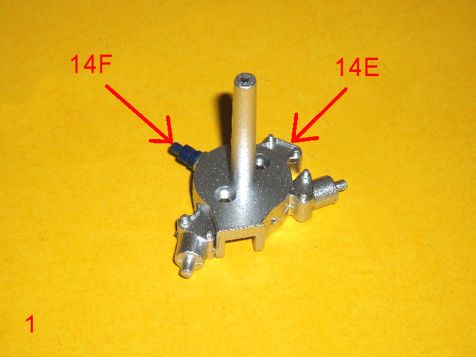

Pic 1: Locate the water pump fitting 14E and fit the attachment 14F in place.
NOTE – This part may already be fitted as supplied but if it is a loose fit, a dot of adhesive might be advised.

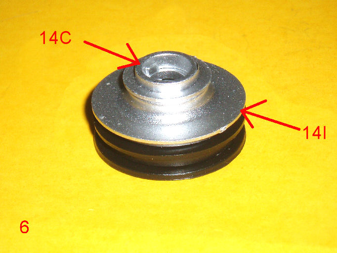

Pic 5: Press fit the outer section 14I onto the two pins on 14B.
Pic 6: Press-fit the outer ring 14C in place on 14I.

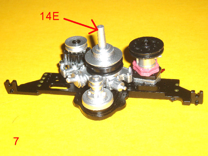

Pic 7: Fit the assembly over the shaft on part 14E.
#12 Posted : 23 June 2025 10:37:42

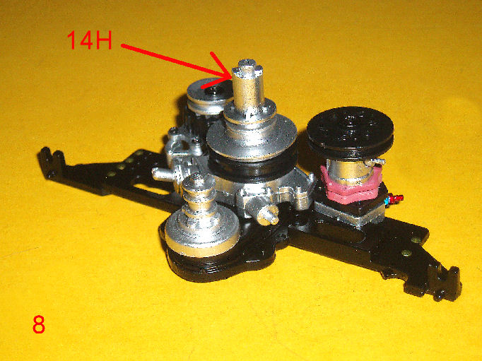

Pic 8: Fit the pump pulley hub 14H over the shaft on 14E.

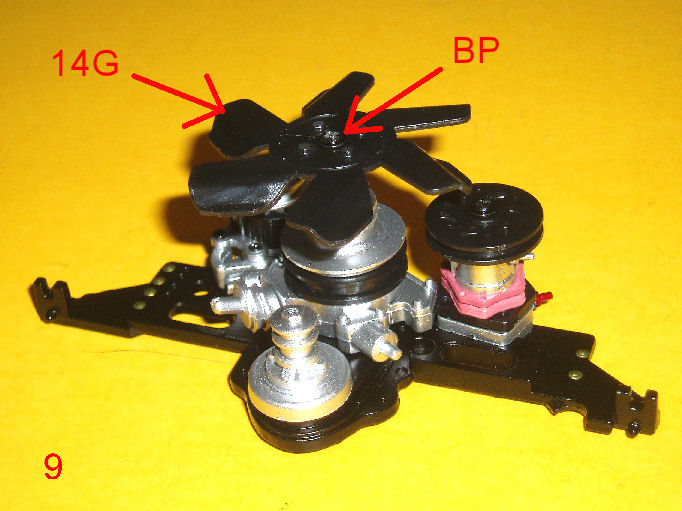

Pic 9: According to the printed instructions - Fit the fan 14G to the end of the shaft 14E, locking the key-way slots together.
NOTE: You are advised not to fit the fan at this point as the next stages will be rendered almost impossible.

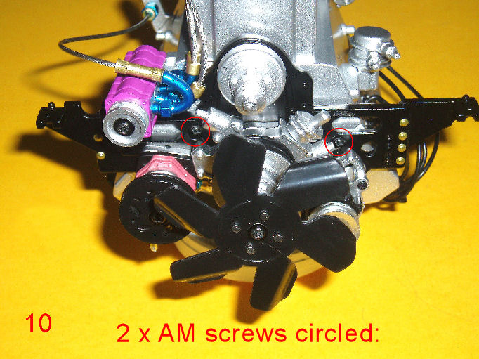

Pic 10: Attach the frame assembly to the front of the engine using 2 x AM screws.

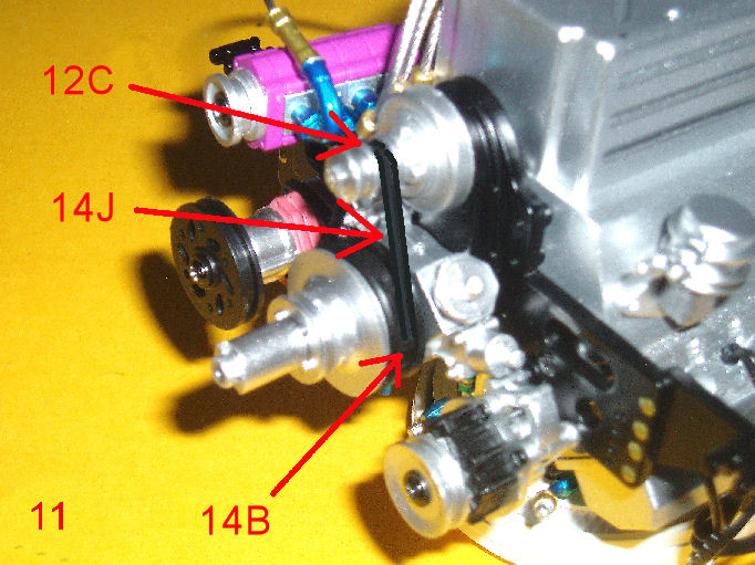

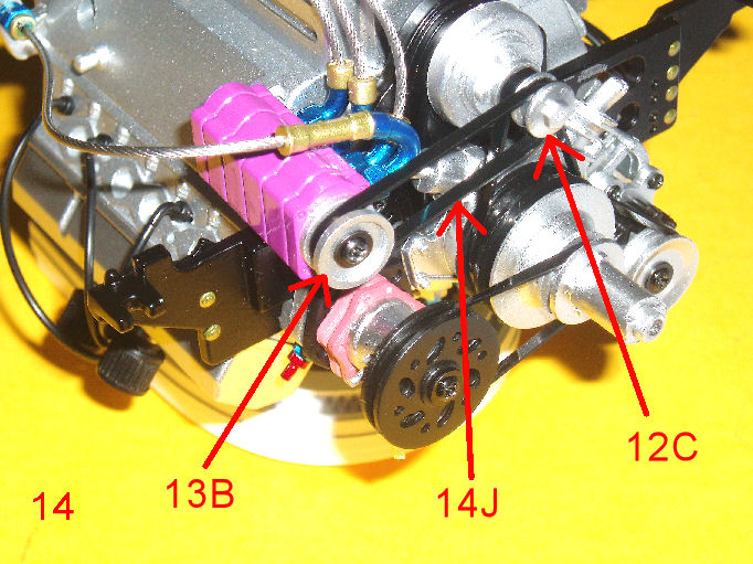

Pic 11: Turn the engine upside down and fit one of the belts 14J between the inner pulley on 12C and the pulley 12B.
Pic 12: With the engine the right way up fit a belt 14J between the inner pulley on 12E and the pulley 14L.

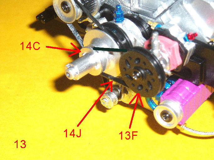

Pic 13: With the engine the right way up fit a belt 14J between the inner pulley on 14C and the pulley 13F.
Pic 14: With the engine the right way up fit a belt 14J between the inner pulley on 13B and the pulley 12C.
Pic 15: Now the fan can be fitted.

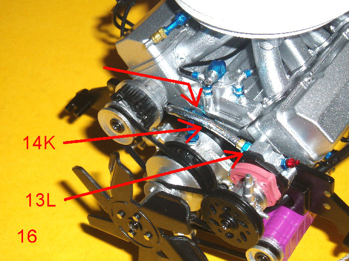

Pic 16: Fit the oil hose 14K to the pin on the end of the pump 13L, locating the other end in the hole on the engine block.

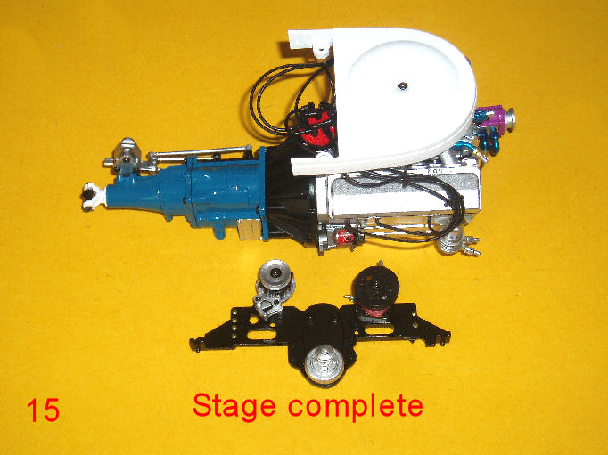

Save the assembly safely for now.
