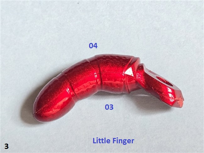

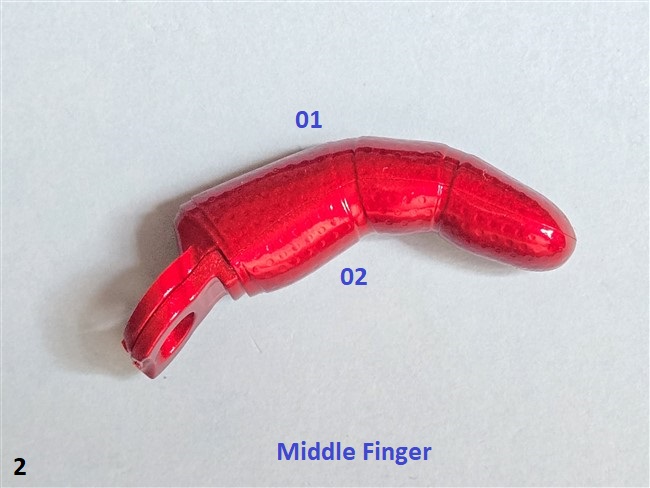

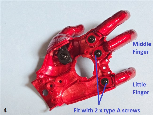

Carefully line up and press together the middle finger parts 01 and 02, as shown in Pic 2. Then do the same with the little finger parts 03 and 04, Pic 3.
Take the hand assembly from Issue 8 and fix the new fingers with a type A screw in each, Pic 4.

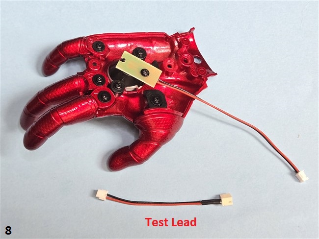

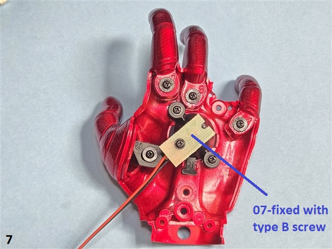

Position the circuit board 07 (tested earlier) and fix its position with a type B screw as in Pic 7. The final assembly is shown in Pic 8, but I like to retest the circuitry after assembly and that`s shown in Pic 9.

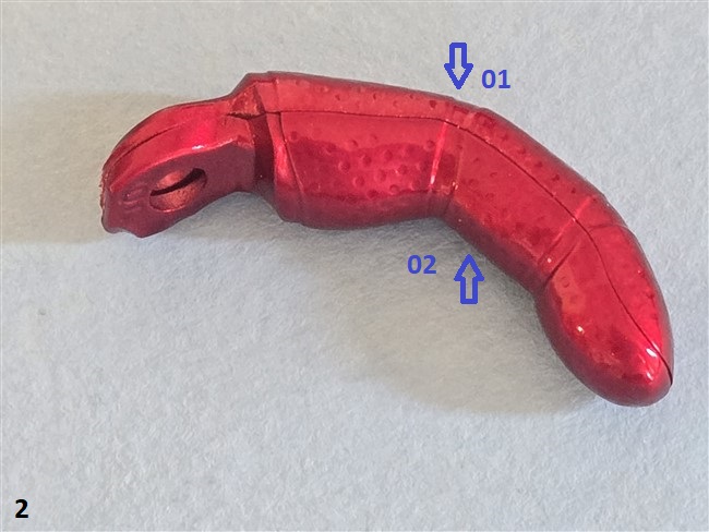

Start by pressing the two halves of the Ring Finger, parts 01 and 02 together as shown in Pic 2. Then position the finger onto its post in the back of the hand 04R, Pic 3.

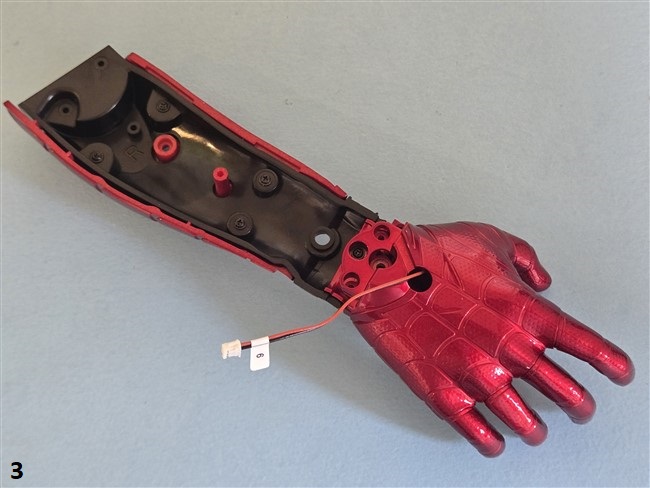

Now bring the palm and back of the hand together, carefully feeding the cable through the back of the hand as shown in Pic 4. The two halves of the hand are now fixed together, with a type "C" screw shown in Pic 5 and a type "B" screw in Pic 6. With the hand now fixed together, place the cover 03R into position at the base of the ring finger, Pic 7.

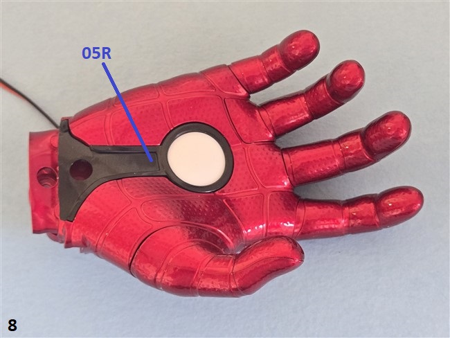

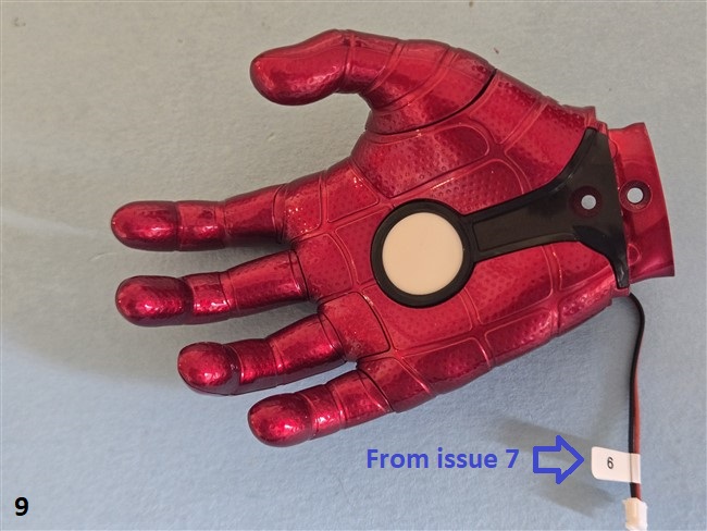

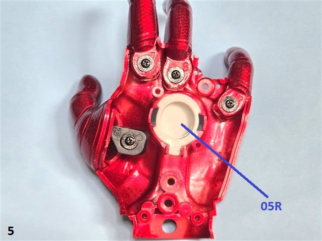

Carefully press the web launcher chassis 05R into the palm/wrist as shown in Pic 8. That just leaves the number "6" label (from issue 7) to apply to the cable, Pic 9. The end result of this update is shown in Pic 10.

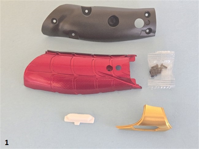

Parts supplied.....Pic 1, you will also need the right hand from the previous update.

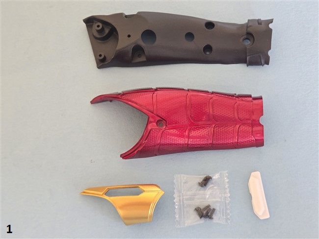

Place the right forearm inner 04R, inside the right forearm lower plate 02R and fix them together with 4 x "E" screws, Pic 2.

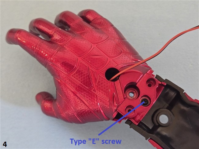

Now position the hand from the previous update onto the forearm, using the orientation shown in Pic 3, with a closer view of the "E" fixing screw shown in Pic 4.

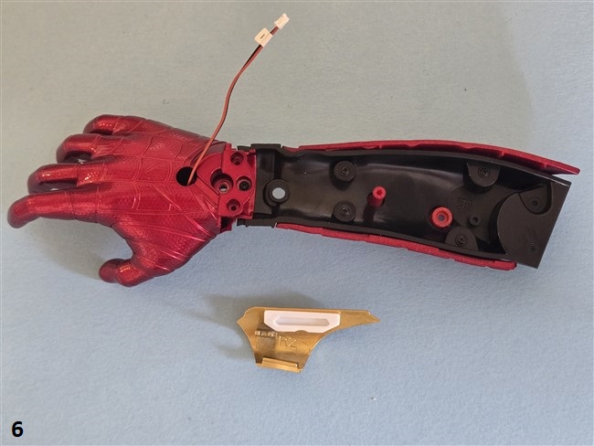

That`s all for this update, Pic 6. Store the parts carefully until needed again.

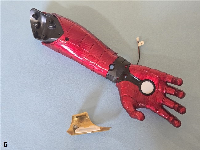

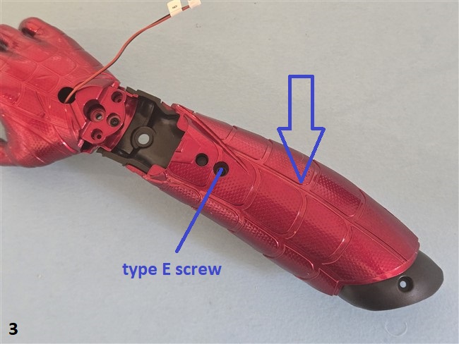

Position the forearm assembly just made, onto the hand/forearm from Issue 11 and fix them together with a type "E" screw as shown in Pic 3. Then turn the arm over and insert another type "E" screw to further secure the arm together as shown in Pic 4.
Finally, position the light cover 03R1, inside the web shooter part 01R1, Pic 5.Note that these parts are not fixed together at this stage, so store them carefully with the other assemblies.
Pic 6 shows the final assemblies for this update.
