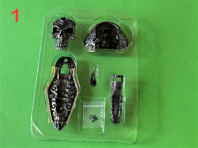

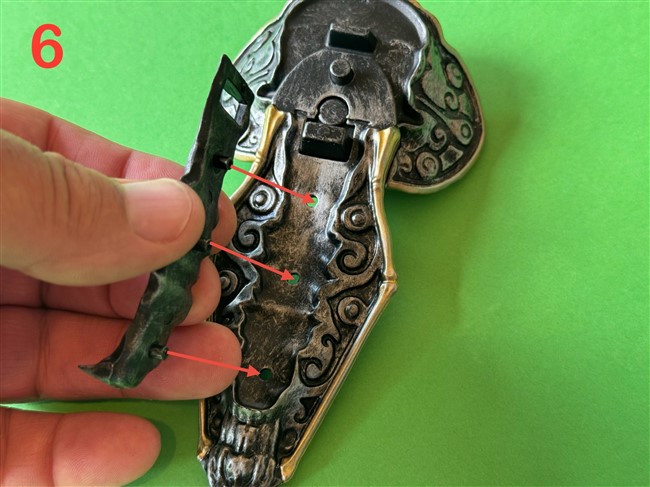

Issue 4
Right Poleyn
Place the right poleyn horn (4C) into the ā€œLā€ shaped hole at the top of the right poleyn ornament (4D), pictures 2 and 3.
Position the right schynbald (4E) on the right poleyn (4A), pictures 4 and 5. Next, place the schynbald reinforcement (4B) onto the schynbald, pictures 6 and 7. Secure this in place using 3 x DP screws, picture 8.
Finally, take the poleyn ornament assembly and fit it into the top of the poleyn by pressing the tabs into the corresponding holes, picture 9.

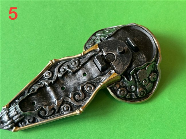

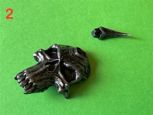

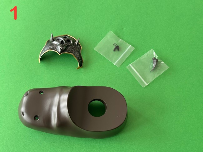

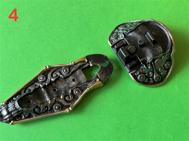

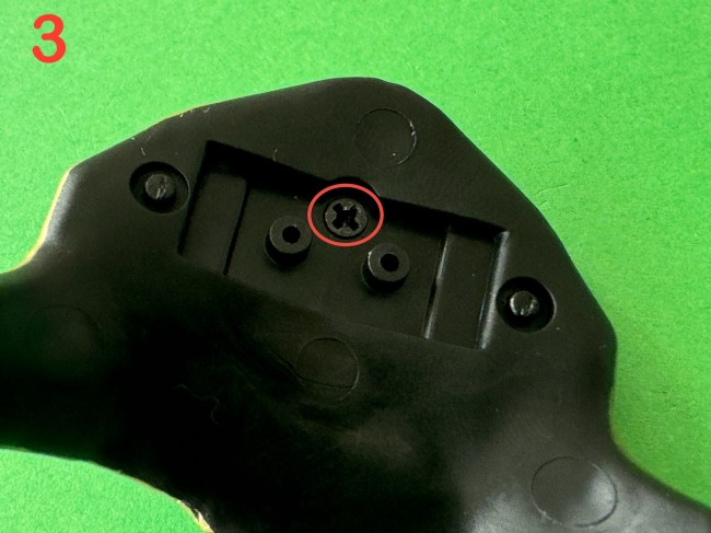

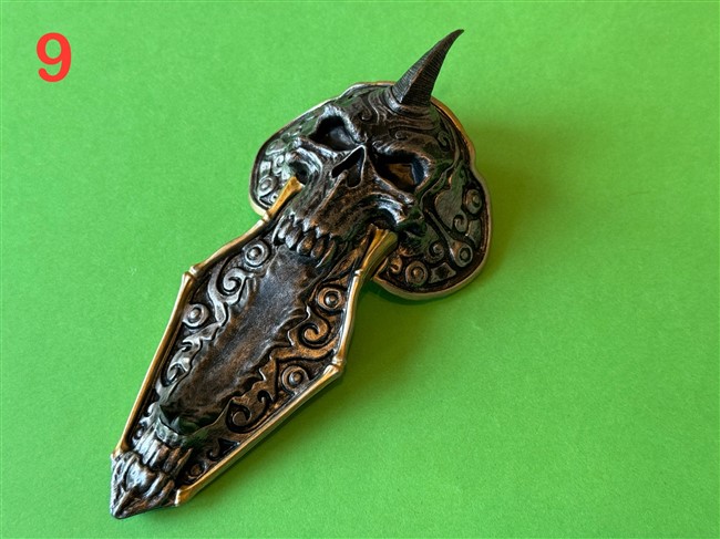

Left Shoe Heel
Place the horn of the left shoe heel (5C) and place it into the hole at the front of the sculpted skull on the heel (5B), picture 2. Secure it in place using an EP screw, picture 3.
Picture 4 shows the assembly complete.
Store the shoe and the heel away carefully.
