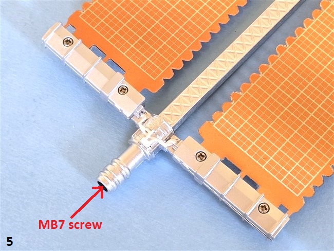

Now position the end covers 3i and 3H, fixing them in place with 4 x MS4 screws, shown in Pic 4. Finally and carefully, tension the solar panels by inserting the MB7 screw into the spindle, indicated in Pic 5.

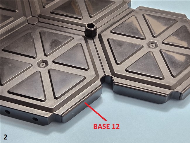

Start by adding the side trim BASE 12 to the main models base as shown in Pic 2.

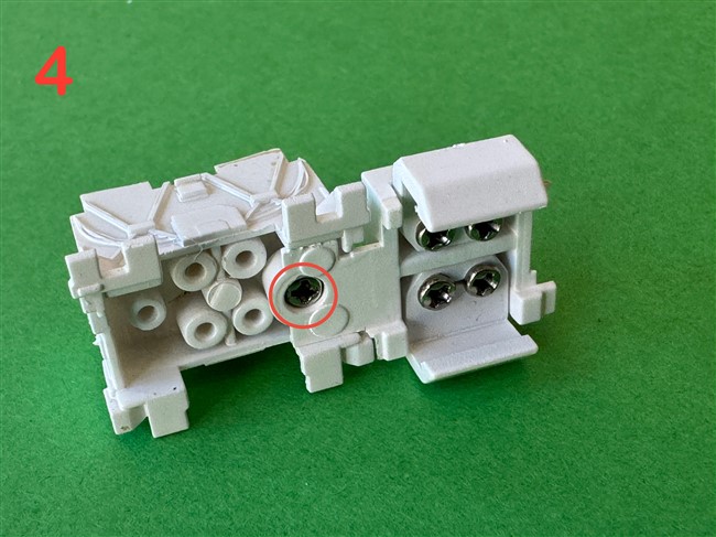

Now we work on the solar panel from the previous issue and position the part 26Q under the spindle as shown in Pic 3. Then add the upper part 26P above the spindle and fix the two parts together using 3 x MS4 screws, Pic 4.

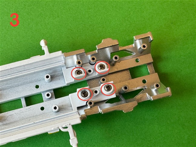

Position the parts 26L and 26R together as shown in Pic 2 and fix them from underneath with 2 x AS5 screws, Pic 3.
Take the assembly from above and position it onto the solar array from Issue 83, as indicated in Pic 4. Then fix it in place using 4 x MS4 screws, as in Pic 5.

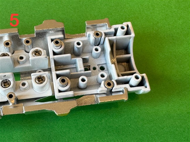

Fix one of the 28C pieces to the 28B and secure it in place using 2 x AS5 screws, picture 2. Add another 28C piece to the other side as shown in picture 3.
Secure this assembly to 28A using a AS5 screw, picture 4.
