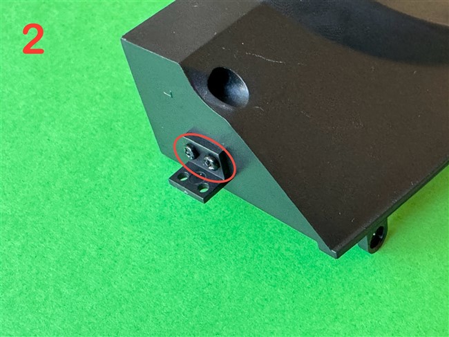

Assembling the Wheelarch
Fix the bracket (87E) to the side of the wheel arch (87A), and secure it using 2 x AP screws, picture 2. Secure the bracket to the end piece (87D) using 2 x AP screws, picture 3. Picture 4 shows the assembly. Push the brake fluid distributor (87C) into the wheel arch as shown in picture 5.

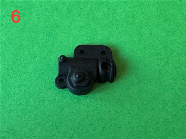

Replacing the Steering Gear Housing.
Picture 6 shows the replacement part from this issue. Undo the 4 screws from the old part, picture 7 and then replace it with the new part and secure it using the 4 screws that you removed, picture 8.

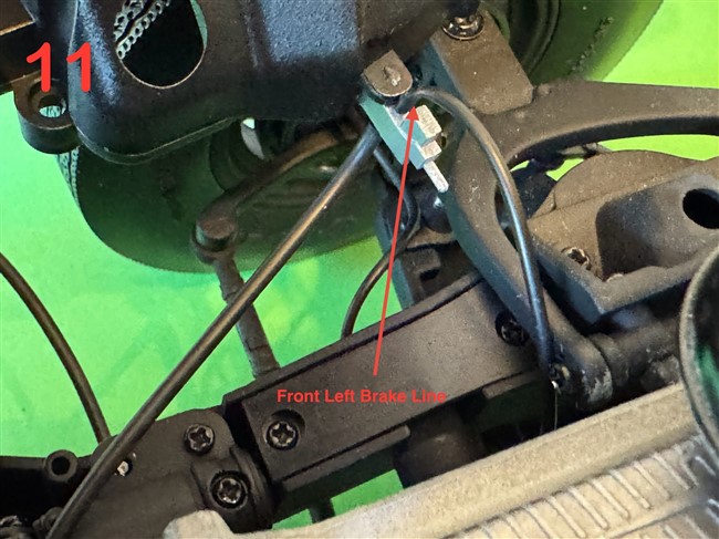

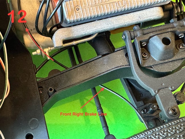

Fitting the Brake Fluid Pipes
Fit the rear brake line into the distributor as shown in picture 10. Next, fit the front left brake line to the distributor, picture 11, and finally, the front right brake line, pictures 12 and 13.

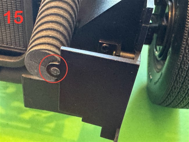

Installing the Wheel Arch
Secure the wheel arch (87A) to the front chassis using 2 x CM screws. Once secured, push the end of the air filter into the loop at the end of the wheel arch, pictures 14 and 15.

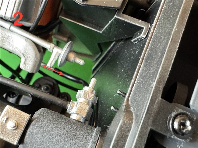

Push the 40mm hose on the pin of the left radiator feeding pipe, picture 4.
This next part is very tricky. Push the 110mm hose onto the free end of the brake fluid distributor that you attached to the wheel arch in the previous issue. The easiest way to attach this, as I found it was near impossible to attach by feeding the cable down through the engine bay, was to undo the wheel arch and carefully lifting it up to expose the distributor to allow you to attach the cable, picture 5.

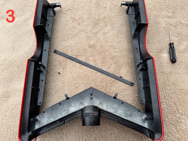

Removing the Shipping Beams
Remove the four screws holding the two shipping beams on the rear body panel (89A), pictures 2 and 3.
That complete this issue.

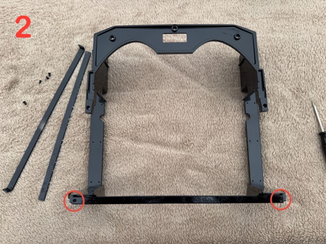

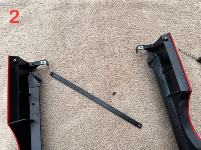

Remove the six screws holding the three shipping beams on the middle body panel (90A), picture 2.

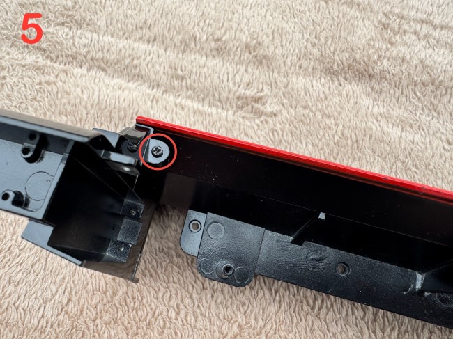

Fitting the Frames Together
Fix the body frame middle to the rear body frame using 2 x EM screws on both the left and right sides of the frame as shown in pictures 3 and 4.
Turn the assembly over and place an EP screw, again on either side of the frame, pictures 5 and 6.
Tip: When securing the last two screws, turn the assembly over again and tighten up the previous four screws. I found that mine tightened up a little further.

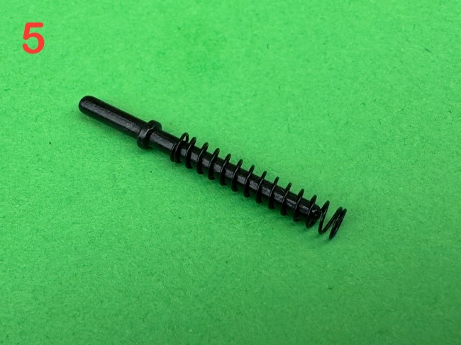

Use 2 x AM screws to fit the right door lock bracket (91E), picture 4. Take the door lock (91F) and place the spring (91G) over it as shown in picture 5. Place the lock and spring into the bracket, picture 6, and then fit the door lock cover (91B) in place using 2 x AP screws, picture 7.

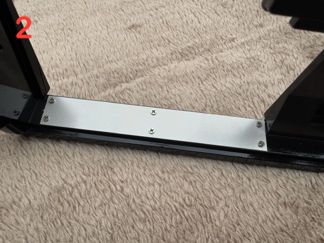

Fitting the Rear Body Panel
Take care not to scratch the body panel. I used a soft blanket to rest mine on. Secure the body panel (92A) to the body frame as shown in picture 2 using 12 x CM screws.
Picture 3 shows the panel in place.
