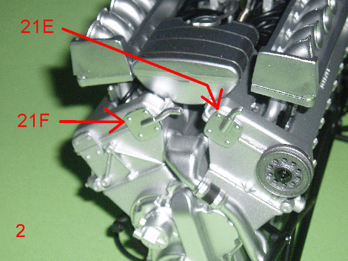

STAGE 21A:
Oil filter, fittings and pipes.
Pic 1: Locate the cylinder head fittings 21E and 21F. They are marked ‘L’ and ‘R’.
Pic 2: Press the fittings into the end of the cylinder heads. They will only fit one way.

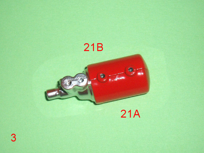

Pic 3: Press the two parts of the oil filter 21A and 21B together.
Pic 4: Attach the oil line 21I as shown.

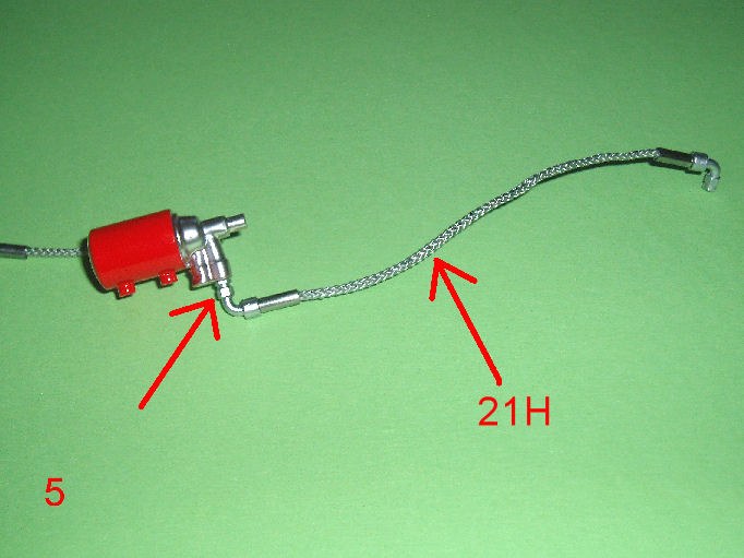

Pic 5: Attach the oil line 21H as shown, using the hole nearest the end of the oil filter.
Pic 6: Attach the oil line 21G as shown, using the hole nearest the middle of the oil filter.

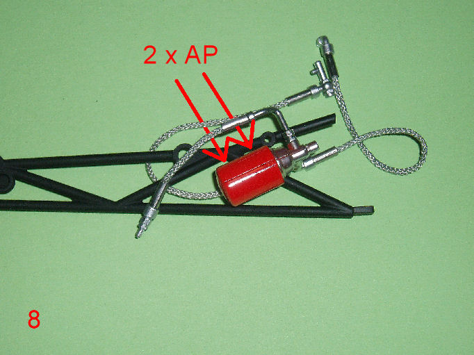

Pic 8: Fit the oil filter to the bracket as shown and fix from behind with 2 x AP screws.

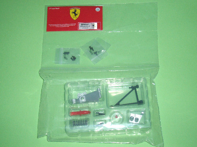

STAGE 22A:
Rear suspension and oil pipes.
Pic 1: Retrieve the engine assembly and fit the oil pipe 21G into the hole in the engine front housing 3F.

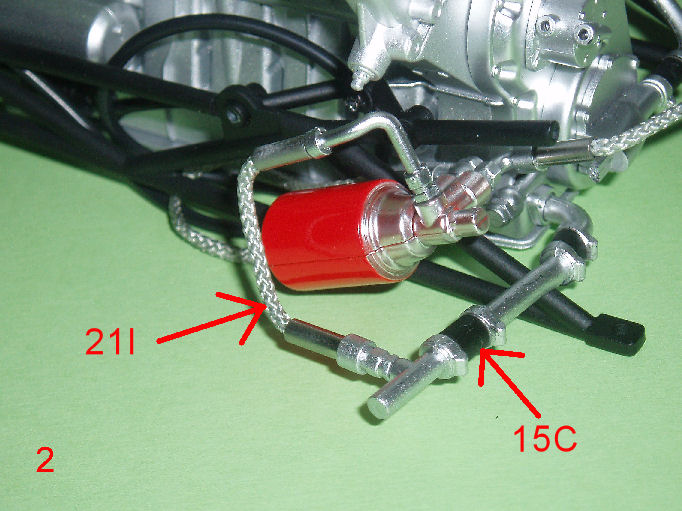

Pic 2: Fit the oil pipe 21I to the pin on the side pipe of part 15C as shown.

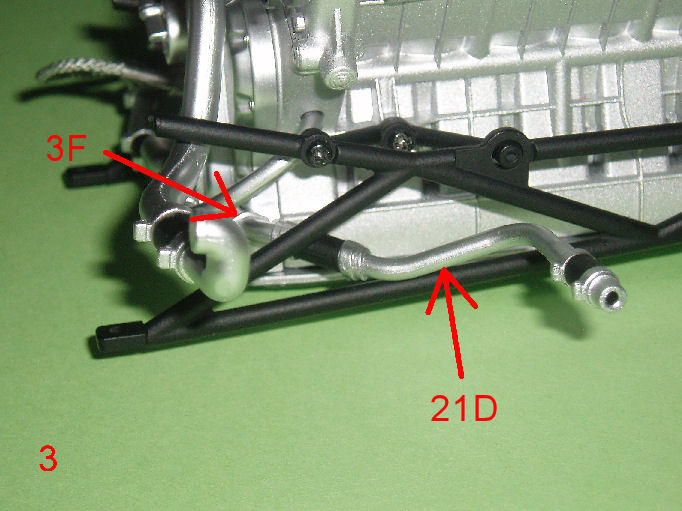

Pic 3: Feed the pipe 21D between the side frames and connect the end to the engine housing 3F as shown.
Pic 4: Insert pipe 21C into the hole in the water pump 3G.
Pic 5: Fit the adjuster knob 22E to the shock absorber body 22D.
Pic 6: Fit the shock absorber to the frame 22C as shown and fix with 1 x BM screw.
#4 Posted : 03 July 2025 10:28:07
Posts: 5,703
Points: 17,261
STAGE 22B:
Pic 7: Fit the lower fork 22G through the side of the frame 22C. This fork is the shorter of the two supplied.
Fit the hub support 22B to the other side and fix with 1 x AM screw.
Pic 8: Fit the hub upright 22A to the assembly as shown and fix with 2 x AM screws and 1 x ABM screw.
NOTE: The printed instructions incorrectly label parts 22A and 22B.
Pic 9: Fit the coil spring 22F over the shock absorber body.
Pic 10: Turn the engine assembly upside down and fit the shock absorber body and coil spring over the damper as shown and then connect the end of the suspension arm 22C to the frame 17A.
Fix the parts with 1 x ADM screw.
Pic 11: Shows the stage so far. Save the unused fork 22H until next time.

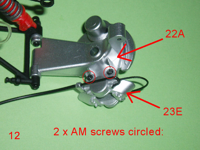

#6 Posted : 05 July 2025 14:18:56
Posts: 5,703
Points: 17,261
STAGE 23B:
Pic 7: Fit the curved pipe 23J to the holes in the caliper.
Pic 8: Fit the pipe 23J to the remaining upper hole in the caliper.
Pic 9: Fit the retaining bracket 23H as shown.
Pic 10: Push the tube 23K on to the end of the pipe 23J.
Pic 11: Retrieve the engine assembly and fit the hub part 23D to the upright 22A as shown and fix with 2 x AM screws.
Pic 12: Bend the upright 22A down and fit the caliper 23E as shown and fix using 2 x AM screws.
Pic 13: Connect the brake pipe 23K to the pin on the lower rail of the frame 20A.
Pic 13: Push the upper fork 22H from the previous stage through the end of the suspension arm 20D and then through the hole in the top of the upright 22A.
Fix from the other side with 1 x AM screw.

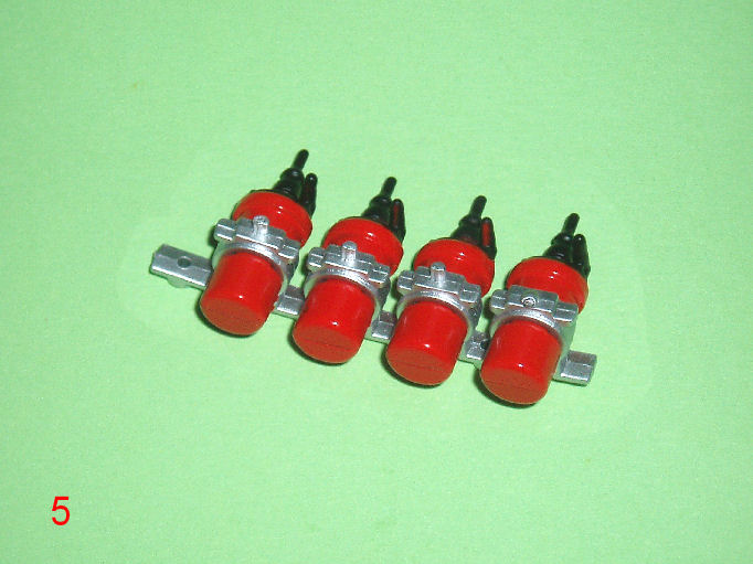

Pic 5: All coils fitted to the bracket 25C.

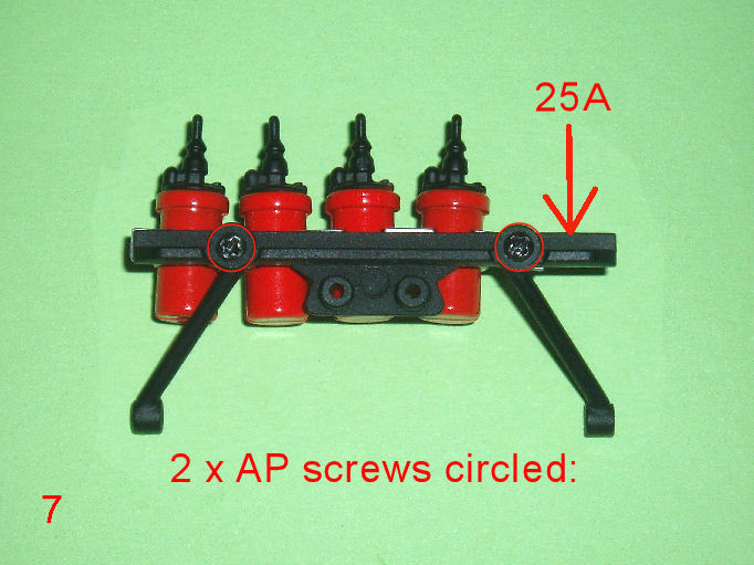

#10 Posted : 07 July 2025 10:25:30
Posts: 5,703
Points: 17,261
STAGE 25B:
Pic 6: Fit the 4 x small coil parts 25D as shown making sure the raised ‘dot’ is at the top left.
Pic 7: Fit the coil assembly to the frame 25A and fix using 2 x AP screws.
Pic 8: Fit the other frame 25B as shown and fix with 2 x AM screws.
Pic 9: Locate the wire 25G and cut off 4 x pieces:
2 x 25mm, 1 x 40mm and 1 x 45mm.
Fit them to the forward facing pins on the coil assembly in the order as shown.
Pic 10: From the wire 25G, cut another 4 x pieces:
2 x 40mm and 2 x 45mm.
These attach to the vertical pins on the coils.
Note the position of the coil assembly when fitting the wires.
Pic 11: Fit the coils and frame assembly to the top of the engine as shown.

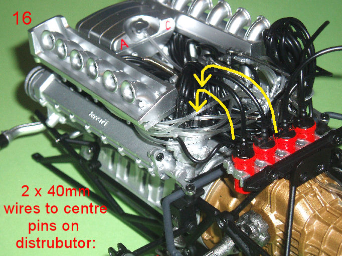

#11 Posted : 07 July 2025 10:28:40
Posts: 5,703
Points: 17,261
STAGE 25C:
Pic 12: This shows the attachment of the coil frame on the left side.
Fix using 2 x AM screws through frame 16A.
Pic 13: This shows the attachment of the coil frame on the right side.
Fix using 2 x AM screws through frame 20A.
Pic 14: Locate the two forward facing 25mm wires from the first two coils on the left.
These attach to the two pins facing the rear on either side of the left distributor.
Pic 15: Locate the two forward facing wires from the two coils on the right.
The first wire is 40mm and the second one is 50mm.
These attach to the two pins facing the rear on either side of the right distributor.
Pic 16: Take the two 40mm wires from the top of the left coils and fit them to the two pins in the centre of the left distributor.
Pic 17: Take the two 45mm wires from the top of the right coils and fit them to the two pins in the centre of the right distributor.
Store the engine safely for now.
