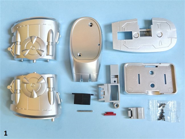

Parts supplied..... Pic 1.

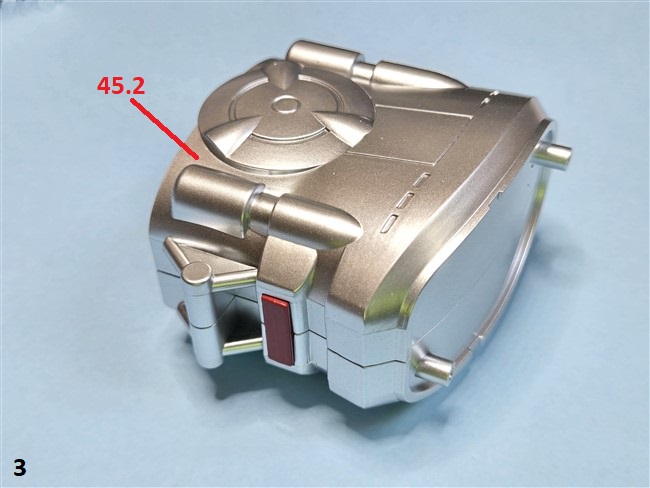

Press the trim 45.8 into place on the left leg (right side) 45.3 as shown in Pic 2. Then add the left leg (left side) 45.2 as in Pic 3.

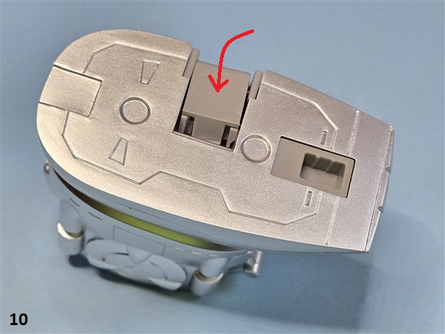

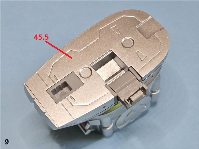

Next, carefully check the orientation and fit the connector 45.7 with the pin 45.9 as in Pic 7 and the pin fully engaged in Pic 8. Now press fit the bottom of the foot 45.5 into position as shown in Pic 9 and pivot the connector to its internal position, Pic 10.

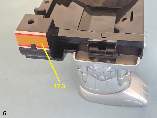

To finish, press fit the side trim pieces 47.2 and 47.3, Pics 5 and 6. That`s all for this update.

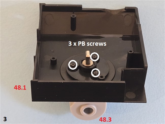

Here comes the update for Issue 48. More work on the front legs of the Mastadon.
Parts supplied.....Pic 1, you will also need the final assembly from Issue 47.
Start by pressing the spindle 48.8 into position in the articulation disc 48.4, as shown in Pic 2.
Now position the previous assembly on the inside of the Upper left articulation base 48.1, with the Left front leg articulation piese 48.3 position underneath. Fix the parts together with 3 x PB screws, noting that the assembly when screwed together still turns. Pic 3 shows the assembly at this stage.

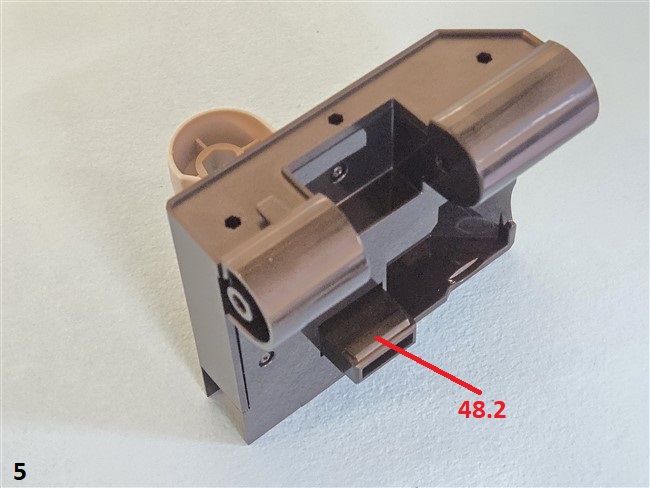

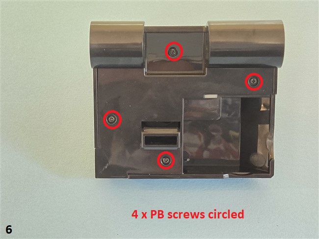

Next place the connecting piece 48.6 into the corner of the base 48.1 as shown in Pic 4. Now fit the Lower left articulation base 48.2 as in Pic 5 and fix its position with 4 x PB screws, more clearly shown in Pic 6.

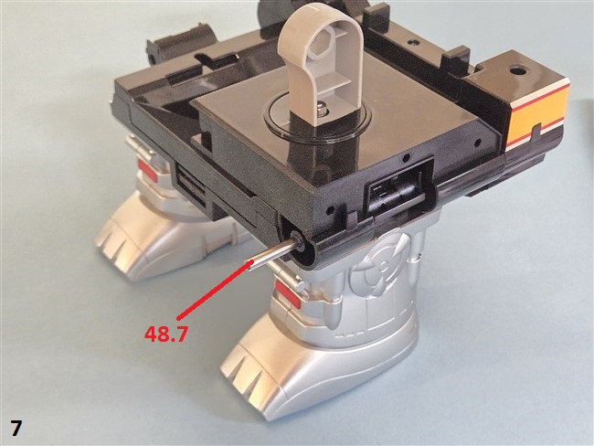

Take the resulting assembley and the assembly from Issue 47, position the hinge parts together and fix the hinge with pin 48.7, where Pic 7 shows the pin partially in place for clarity and fully in place in Pic 8.

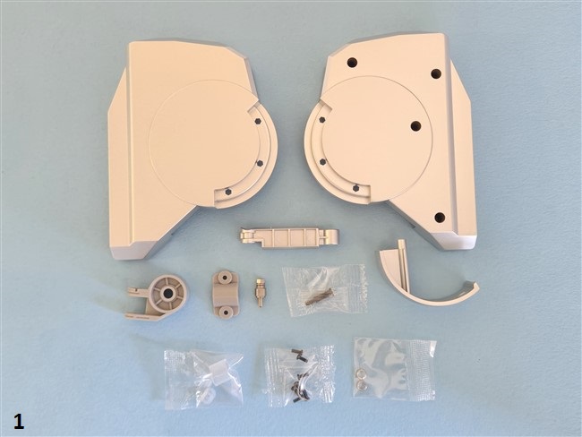

#5 Posted : 27 June 2025 19:57:14
Hi All, BigGrin
Here we are with the update for Issue 49, which is a replication of Issue 48 except its the right hand assembly as opposed to the left.
Parts supplied.....Pic 1, you will also need the assembly from the end of Issue 48.

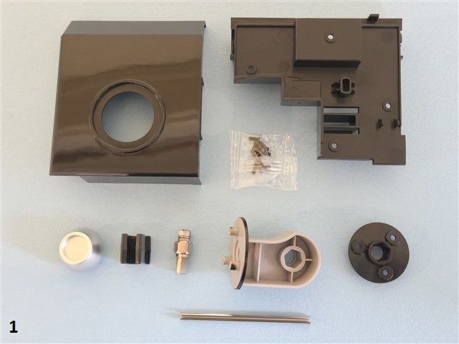

Press the spindle 49.8 into the articulated disc 49.4, as in Pic 2. Now place the resulting assembly inside the right upper base 49.1 and the right front leg articulated piece 49.3 underneath and fix 49.4 to 49.3 with 3 x PM screws. All shown in Pic 3.
Position the connecting piece 49.6 into the corner of the upper base as shown in Pic 4. Now position the lower right base 49.2 into place and fix its position with 4 x PM screws, Pic 5.

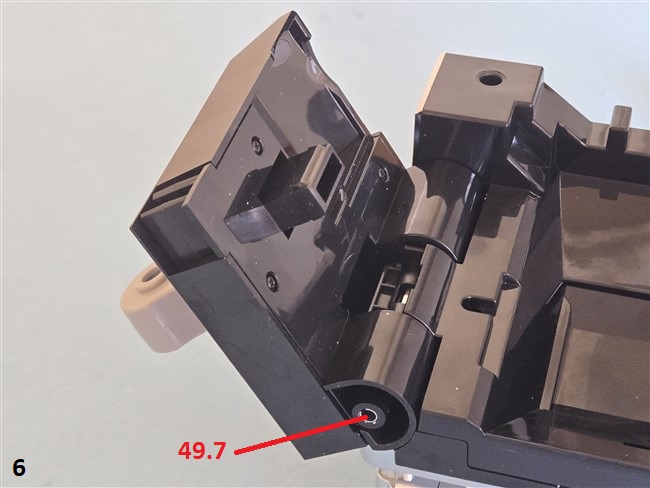

Place this assembly onto the Issue 48 final assembly, fixing them together with the hinge pin 49.7, indicated in Pic 6.
Finally, press fit the hinge pin cover 49.5 into place as shown in Pic 7.
Pic 8 shows the final assembly for this update.

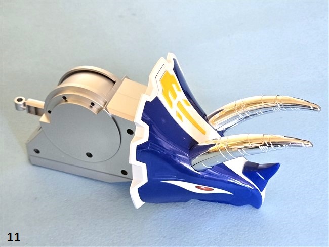

Finally add the neck right side 51.2 and fix the whole neck assembly with 4 x PB screws, Pic 10. The end assembly for this stage is shown in Pic 11.
