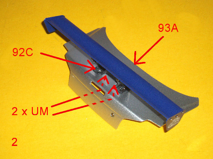

Pic 2: Retrieve the spoiler assembly from the previous stage and fit it to the boot lid as shown.
Fix from underneath with 2 x UM screws.

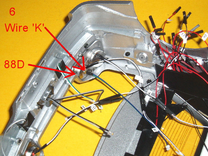

Pic 6: On the other side of the car, fit the LED on wire ‘K’ into the hole in the reflector 88D.

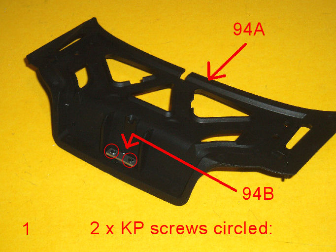

Pic 1: Fit the lock part 94B into the boot lid reinforcement panel 94A as shown and fix with 2 x KP screws.

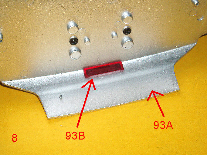

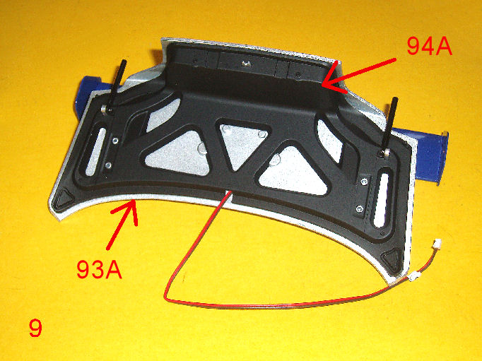

Pic 8: Retrieve the boot lid and red reflector 93A and 93B from the previous stage and fit the reflector in place.
Pic 9: Fit the reinforcement panel 94A in place as shown.

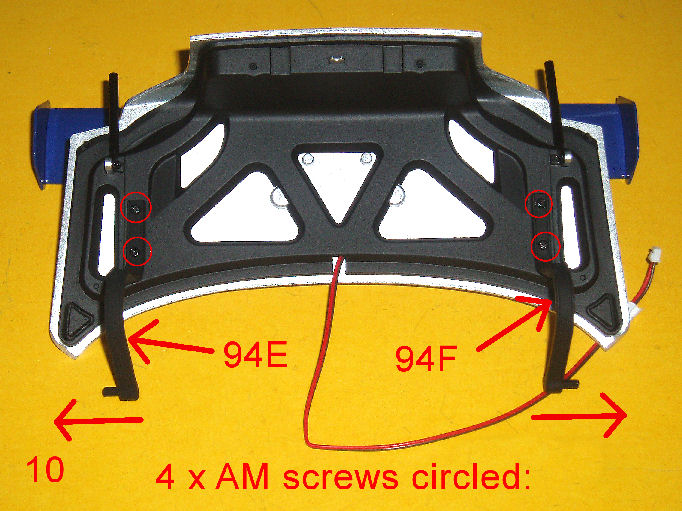

Pic 10: Fit the two hinge brackets 94E and 94F as shown making sure they are on the correct side with the angled hinge pin facing outwards.
Fix in place with 4 x AM screws.

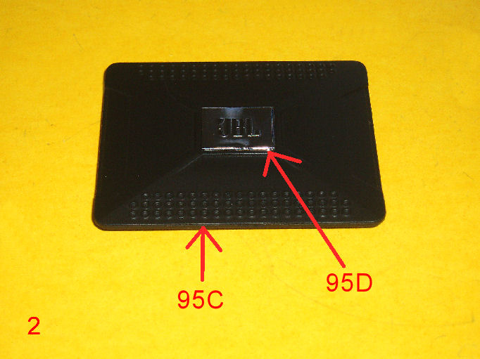

Pic 2: Press-fit the JBL badge 95D into the amplifier 95C as shown.
Pic 3: Press-fit the amplifier 95C into the boot floor 95A as shown.

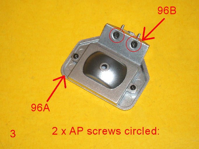

Pic 2: Fit the rear screen housing 96C in place on the front housing 96A as shown and fix using 2 x AP screws.
Pic 3: Fit the screen support 96B to the assembly and fix with 2 x AP screws.

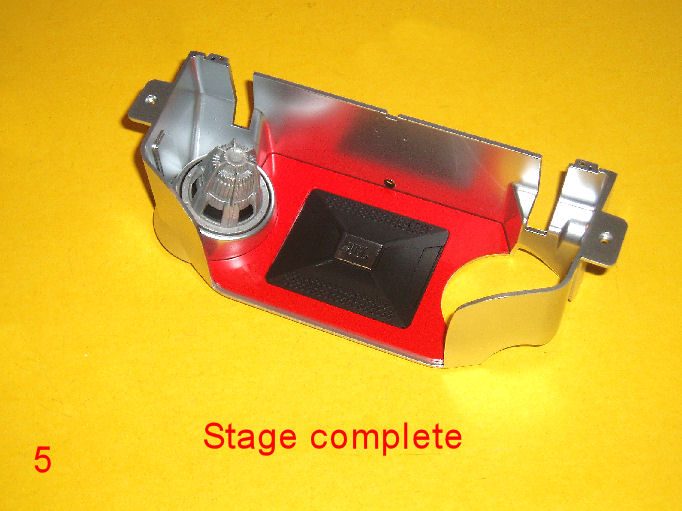

Pic 4: Retrieve the boot liner 95A from stage 95 and place it upside down in the position shown.
Fit the speaker assembly into the left aperture and fix with 2 x AP screws.
Pic 5: Shows the assembly so far.
