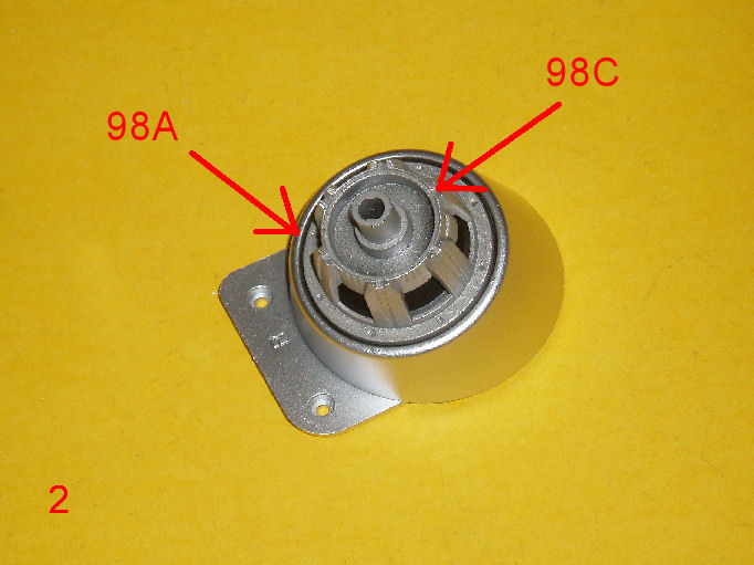

STAGE 98:
Sound system 4.
Pic 1: Press-fit the speaker 98B into the housing 98A.
Pic 2: Fit the subwoofer basket 98C to the assembly as shown.
Pic 3: Fit the subwoofer cap 98D to the subwoofer basket 98C.
Pic 4: Retrieve the boot liner 95A from stage 95 and place it upside down in the position shown.
Fit the speaker assembly into the right aperture and fix with 2 x AP screws.
Pic 5: Shows the assembly so far.
