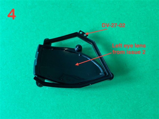

Take the two eye frames and note the differences in the left and right parts. Picture 2 illustrates the correct numbered parts.
Take the right eye lens from issue 2 and attach the right eye frame (DV-27-03), picture 3. Do the same with the left eye, picture 4.
Place the left eye assembly into the mask pushing the pegs of the eye cover into their corresponding holes, picture 5.
Follow the same procedure for the right eye cover, picture 6.
Picture 7 show the complete assembly for this issue.

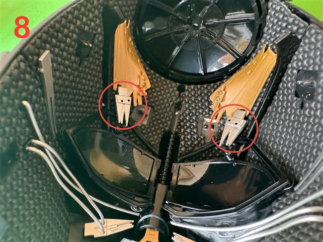

Finally, attach the two internal conductor plate end pieces by push fitting the two pegs into the eye frame, picture 8.

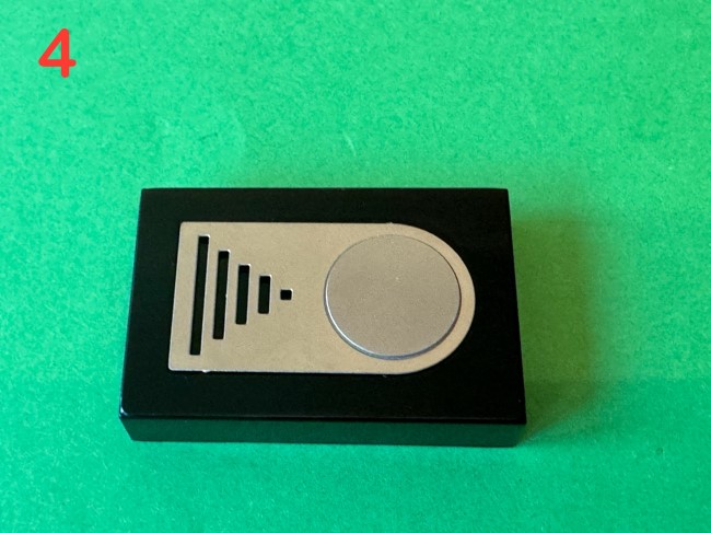

Remove the protective adhesive film from the contact button and attach it to the buckle panel as shown in picture 4.

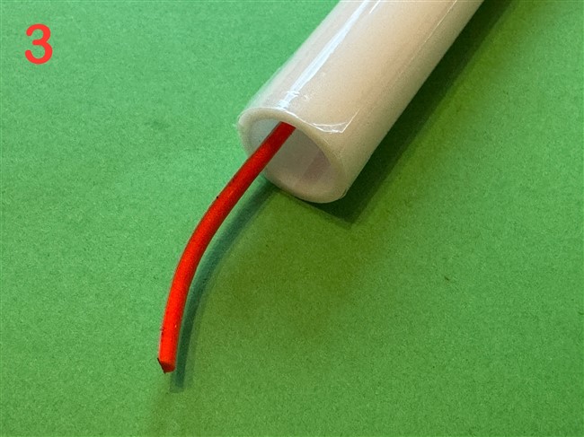

Take the lightsaber tube and insert the LED strip inside as shown in pictures 2 and 3. Note: leave the protective film on the lightsaber for now as this will stop it from getting scratched.

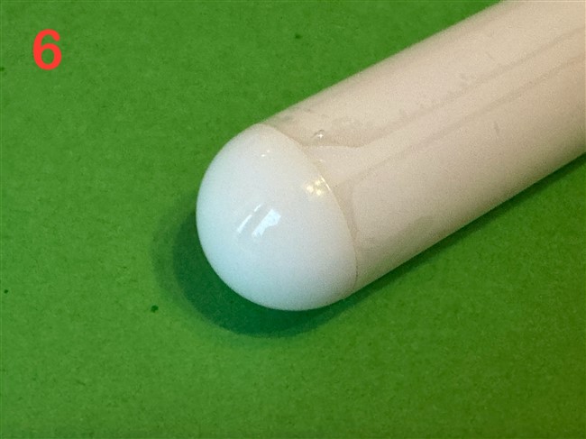

Place the LED strip cap over the end of the LED, picture 4. Attach the LED cap clasp and snap fit it in place as shown in picture 5. Push the end LED cap into the lightsaber tube, picture 6.

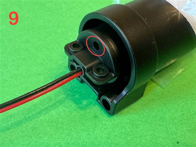

Take the front guard of the lightsaber and feed the other end of the LED cable through, picture 7. Push the guard over the lightsaber tube, picture 8. Position the upper support over the guard and secure it in place with a “F” type screw, picture 9. Turn the assembly over and attach the lower support, pulling the cable so it is taut. Secure it in place using two type “F” screws, picture 10.

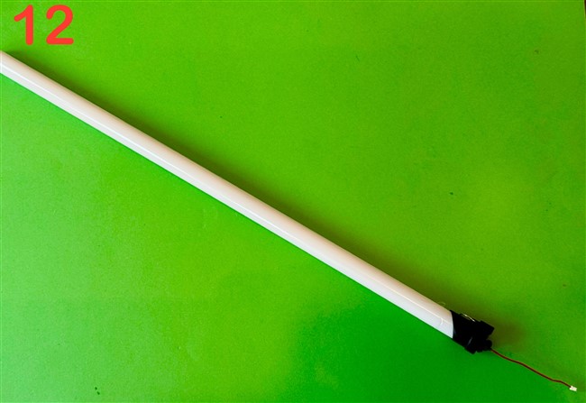

Picture 12 shows the completed assembly for this issue.
