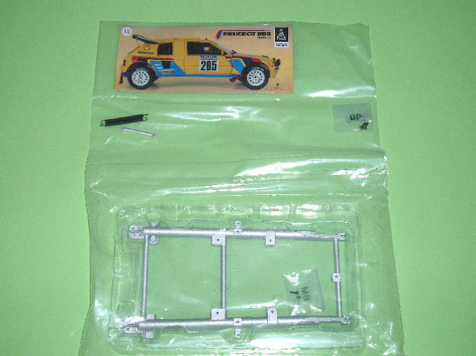

STAGE 15:
Front centre chassis.
Pic 1: Locate the chassis 15A and the tyre bracket 15B.

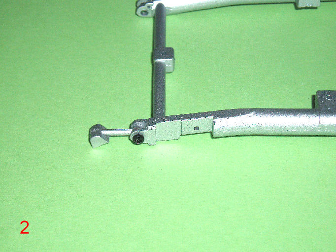

Fit them together as shown and fix using 1 x BM screw.
Pic 2: Detail of fixing.

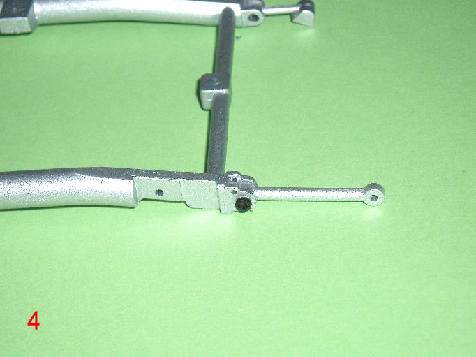

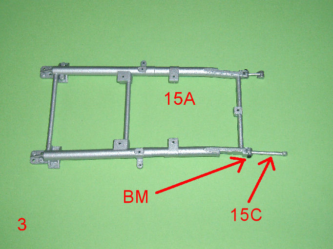

Pic 3: Fit the other tyre bracket 15C to the other side of the frame 15A and fix using 1 x BM screw.
Pic 4: Detail of fixing.

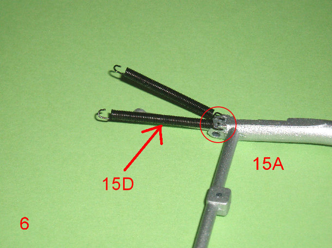

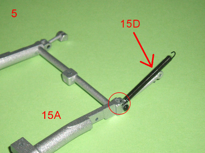

Pic 5: Fit one of the exhaust clamp springs 15D to the small hole in the frame 15A as shown.
Pic 6: Fit the other spring 15D to the hole on the other side of the frame as shown.
It is advisable not to fit these springs just yet and save them safely as they are a loose fit and there is a risk of losing them in future stages of the build.

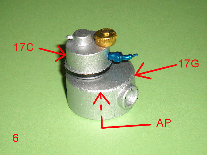

STAGE 17A:
Rear left chassis.
Pic 1: Retrieve the previous chassis assembly and fit the frame 17A as shown.
Pic 2: From the other side, fix the parts with 1 x AM screw.

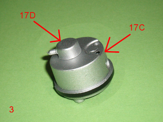

Pic 3: Fit the filter cap 17D to the filter body 17C.
Pic 4: Fit the gold filter cover 17E as shown.
Pic 5: Press-fit the blue connector 17F into the side of the filter body.
Pic 6: Fit the assembly into the filter centre section 17G and fix from below with 1 x AP screw.
Pic 7: Fit the filter base 17H as shown and fix using 2 x AP screws.

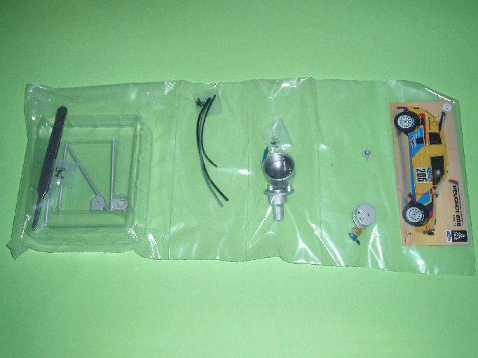

STAGE 17B:
Pic 8: Press-fit the blue connector 17I into the filter base.
Pic 9: Fit the assembly into the circular section on the frame 17A as shown and fix from underneath with 1 x UP screw.
Pic 10: Fit the tube 17J to the pin on the upper blue connector 17F.
Pic 11: Fit the tube 17K to the pin on the side of the filter cap 17D.
Pic 12: Fit the grey tube 17L to the pin on the lower blue connector 17I.
Pic 13: Stage complete.
Store all parts safely for now.

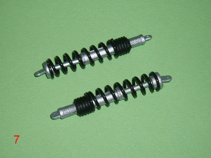

Pic 7: Make two shock absorbers.

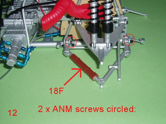

Pic 12: Fit the lower wishbone 18F in place as shown and fix using 2 x ANM screws.

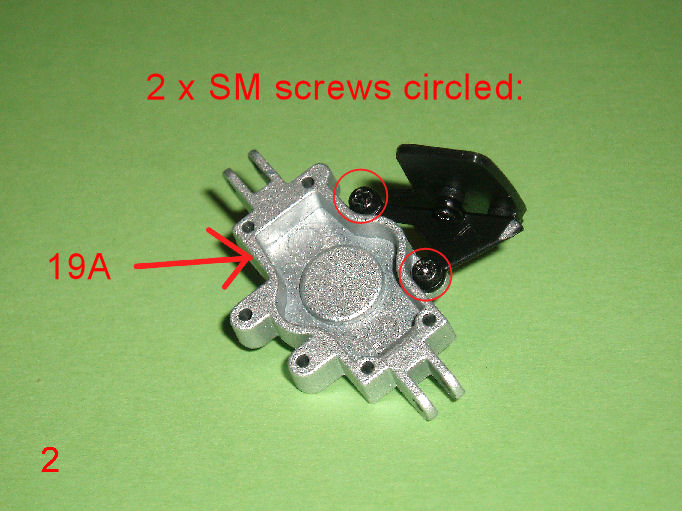

Pic 1: Fit the wheel guard and bracket 19I and 19H together as shown and fix using 2 x KP screws.
Pic 2: Fit the assembly to the hub sleeve and fix with 2 x SM screws.

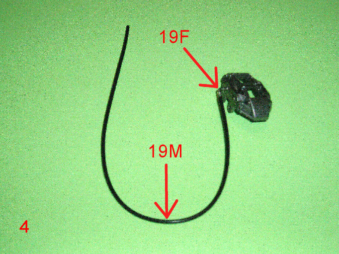

Pic 4: Fit the brake tube 19M to the adaptor 19F.
Pic 5: Fit the caliper to the hub sleeve as shown and fix with 2 x AM screws.

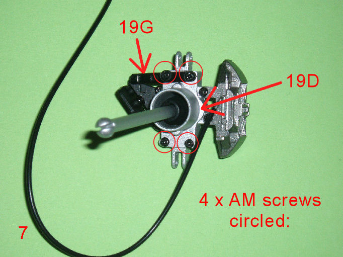

Pic 7: Fit the assembly into the hub sleeve and position the steering rod bracket 19G as shown.
Fix the parts together using 4 x AM screws.

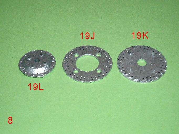

Pic 8: Locate the three brake disc parts 19J, 19K and 19L.

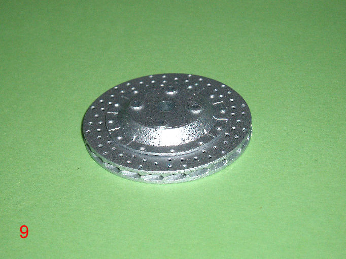

Pic 9: Press-fit the parts together.

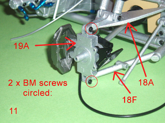

Make sure the ribbed face on 19J faces 19K.
Pic 10: Retrieve the engine/frame assembly and fit the hub and drive shaft in place as shown.
The drive shaft should locate in the black rubber boot 5L.
The caliper should be on the left.

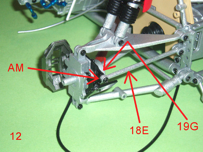

Pic 11: Secure the hub to the suspension arms as shown using 2 x BM screws.
Pic 12: Fit the end of the track rod 18E to the end of 19G and fix with 1 x AM screw.

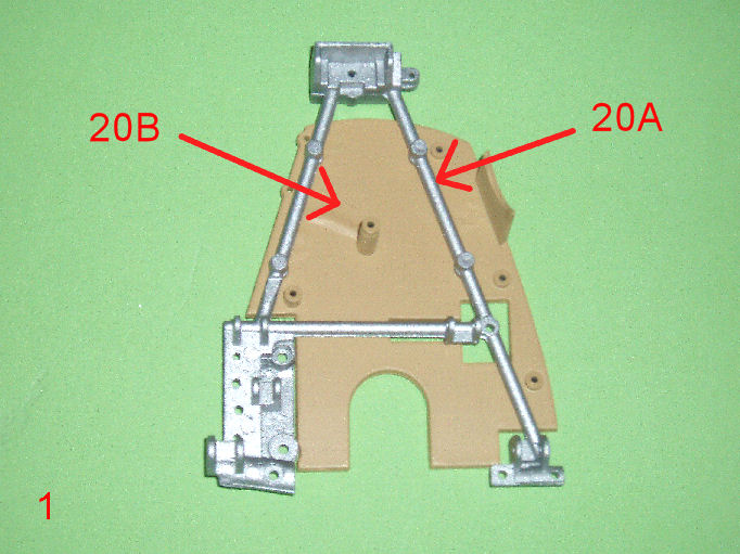

Pic 1: Fit the chassis parts 20A and 20B together as shown.
Pic 2: Fix the parts together from the other side with 4 x AM screws.

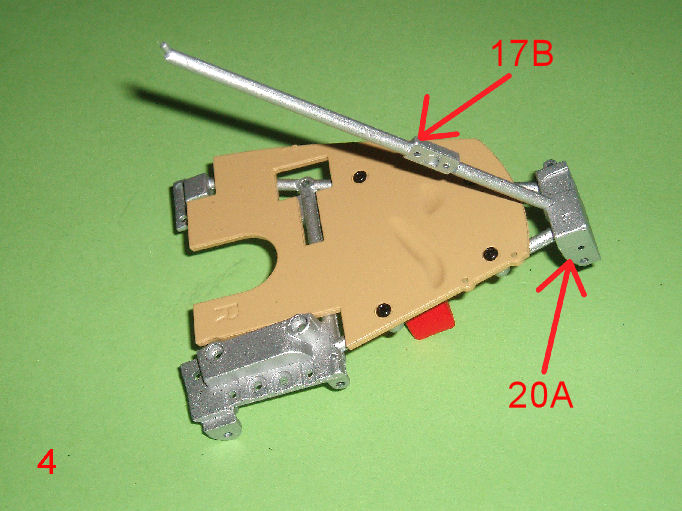

Pic 4: Retrieve the support strut saved from stage 17 and fit it in place on the frame 20A as shown.
Pic 5: Retrieve the engine/chassis assembly and fit the new assembled parts in place as shown.
The end of 17B should locate at the lower edge of the opposite frame.

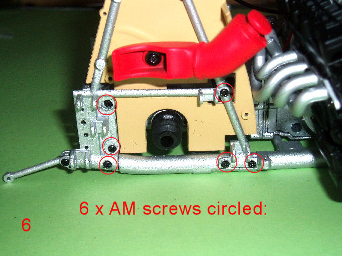

Pic 6: Fix the parts together from the outside using 6 x AM screws.
NOTE – The printed instructions incorrectly say five screws.
