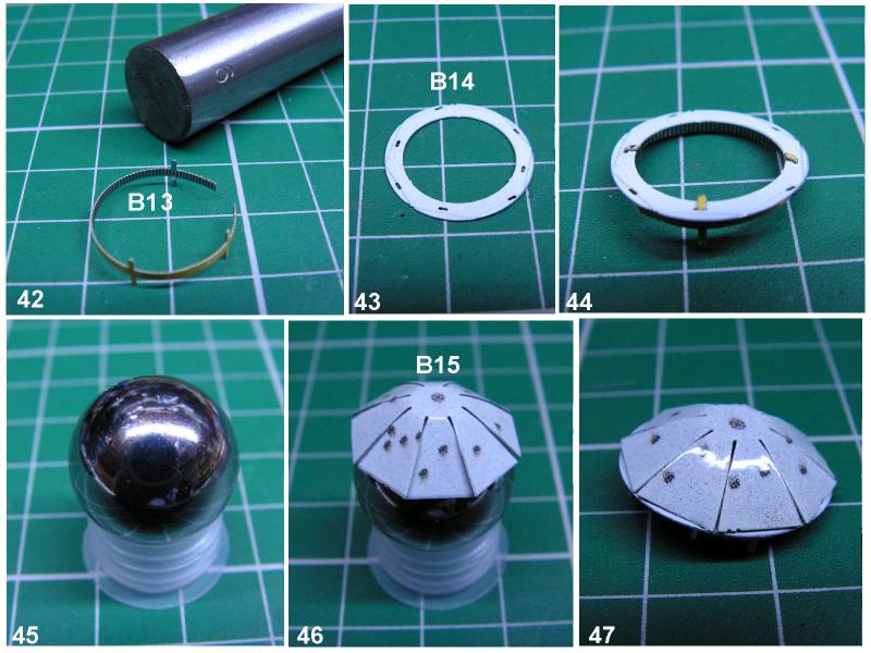

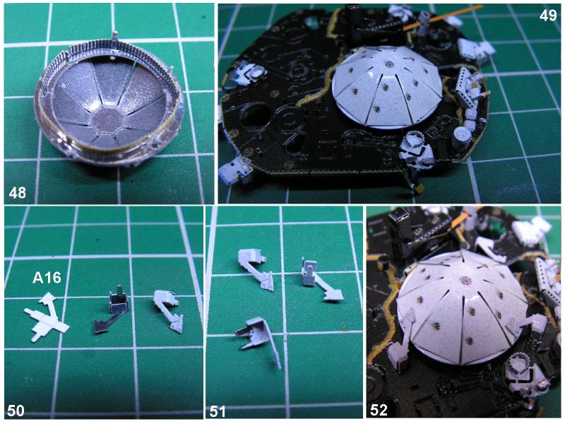

To begin the Thermal Shield section we start with part number B13 which is a long straight band with six little tabs sticking out. This has to be shaped into a ring as shown in Photo 42. The former, seen in the background is the solid steel handle of the 9mm leather punch (the cutting end is 9mm, the handle is about 12-15mm). Onto this resulting ring goes part B14, a washer with seven slots around the top. Three of those are used to attach the ring as seen in Photos 43 and 44. The actual shield part (B15) has to be formed into a shallow dome and to achieve this I sent off for a few stainless steel ball bearings of various sizes, (I only wish someone on ebay would sell sets of ball bearings from tiny to fairly big with just one of each instead of having to get so many of this and so many of that to get the selection!Cursing ) Any way, the one needed is shown in Photo 45 sat in a cradle made from a plastic bottle top. The dome is shown being formed in Photo 46, there are four tabs around the bottom and these fit into the four remaining slots in the base. They can only fit in one way so it’s important to make sure that the washer itself is fitted onto the correct three – it can go on wrong if you don’t double check – yes, experience talking!Blushing As seen in Photo 47, the edges of the dome are not curved as you might think – the top of the washer B14 is engraved with straight raised lines, which the dome then fits up against. You can just make them out in the preceding photos. The dome assembly is seen from below in Photo 48, the three remaining tabs sticking up are to secure the dome to the main deck which it has been in Photo 49. The last part of this section is to form and attach the three identical clamps which secured the dome to the deck during landing and which release their grip when the crane locks onto the dome to swing it over the side onto the seismometer experiment once it has been deployed. Photo 50 illustrates the three Part A16’s , the first flat packed as it comes off the fret, the second folded into a box shape and the third after I painted the reverse of the clamp and the inside of the box with Vallejo light grey – otherwise it’s noticeably ‘shiny’ in there!Blink
Photo 51 shows all three formed and painted ready to attach. Finally in Photo 52 the completed assembly is fixed onto the deck by those three last tabs. Interestingly, in a wonderful mix of old and new technology, the gold colour of the ring represents a flexible screen that hangs down around the dome to protect the seismometer inside – that screen is made of chainmail!BigGrin
In the next instalment we have two items that I was convinced were thrusters for control on the way down – um, no they aren’t!Laugh
Robin.

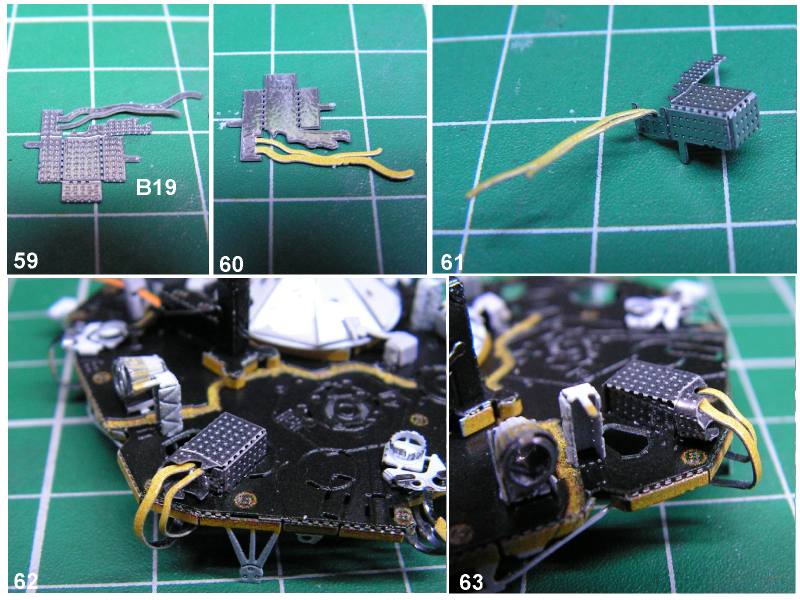

After B17 and B18, the next part was funnily enough B19! This I have no idea what it is, I couldn’t find any itemised pictures of Insight which labelled it so it’ll have to be the ‘Silver box with wires hanging out’ gubbins. Photos 59 and 60 illustrate the part from both sides. The wires are only coloured on one side but much later on when I was putting in the final ‘improvements’ I did repaint the yellow in Vallejo acrylic and painted both sides. Again this is just a simply folded box which is fixed to the deck by the two tabs on the bottom and the wires then curved around and under to vanish under the deck – they’re not actually fixed into anything down there. Photo 61 shows the box fixed in place as does Photo 62 from the other side. After I took the photos and had them on the screen it was only then that I noticed that one side of the box had accidently been squashed inwards (Photo 62) it was fairly simple to gently poke a thin sewing needle in through the holes along the side bend and tease the side back out again until it was levelled up.
In the next instalment we come to one of the iconic parts of the lander – the crane jib used to pick up the instruments and place them on the Martian surface (and a fiddly little thing it is too!)Blink
