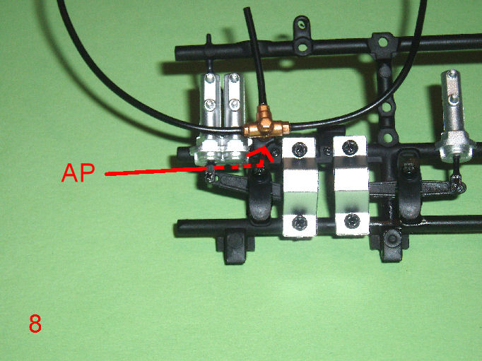

Pic 8: Fit the union to the frame next to the brake cylinders and fix from behind with 1 x AP screw.

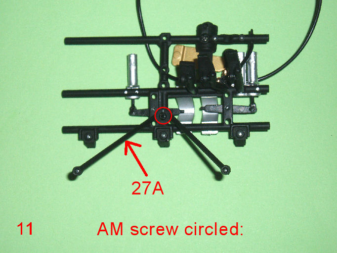

Pic 11: Fit the mount bracket 27A to the bottom of the frame and fix with 1 x AM screw.

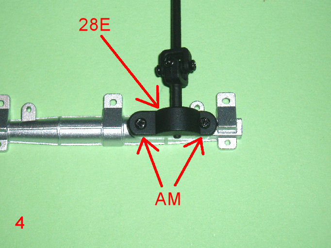

Pic 3: Fit the gear wheel on the steering rack into the location on the rack part 28B as shown.
Pic 4: Fit the clamp 28E over the gear and fix with 2 x AM screws.

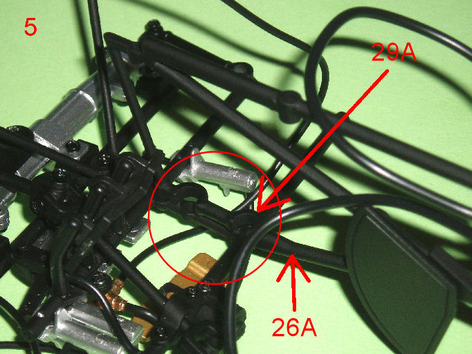

Pic 4: Retrieve the front frame assembled around 26A.
Fit the central frame 29A in place, at the centre of the 26A assembly as shown.
Pic 5: This shows a close up of how the parts fit together.
The two ‘U’ shaped sections on 29A should line up with the circular locations on 26A.
Pic 6: Holding the parts together, turn everything up the other way and fix the parts together with 1 x AM screw.
Pic 7: Shows a close up of the screw fixing.

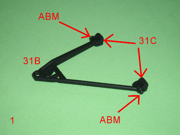

Pic 1: Fit the two arm brackets 31C to the left lower arm 31B taking note that with the arm 31B upside down as shown, the small steps on the brackets 31C are at the top. This is important.
Fix with 2 x ABM screws from the outside.

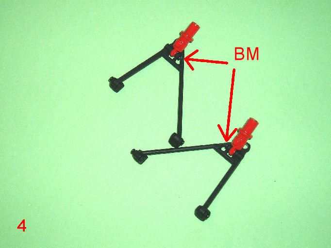

Pic 3: Assemble the two shock absorbers as shown using 2 x 31D and 2 x 31E.
Pic 4: Fit the shock absorbers to the suspension arms as shown with the adjuster knob facing inwards.
Fix using 1 x BM screw in each.
