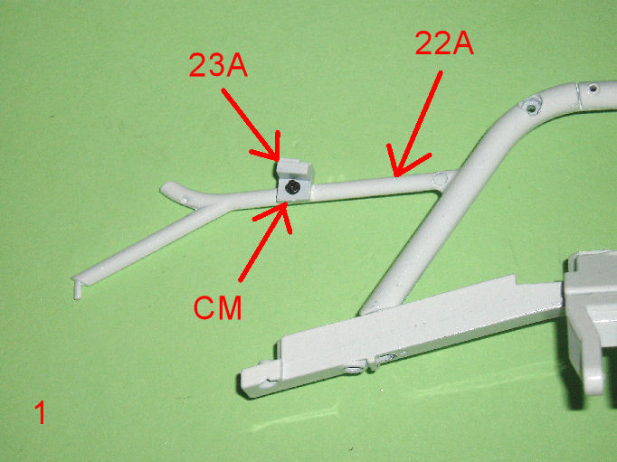

Pic 1: Retrieve the right frame assembly 22A from the previous stage and fit the radiator bracket 23A as shown.
Fix it with 1 x CM screw.

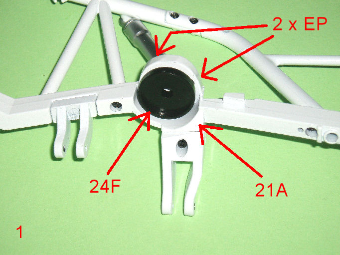

STAGE 24A:

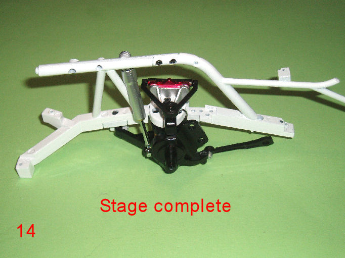

Right front suspension.
Pic 1: Retrieve the right frame 21A and fit the suspension top mount 24F into place.
Fix from the other side with 2 x EP screws.

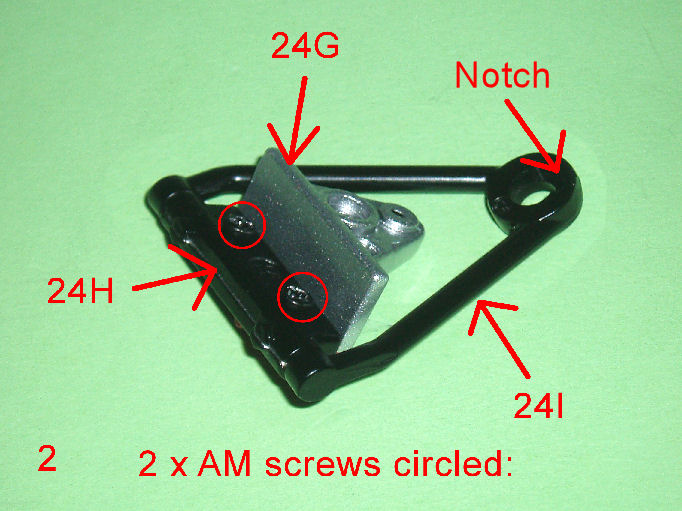

Pic 2: Assemble the upper control arm parts 24G, 24H and 24I as shown and fix with 2 x AM screws.
Pic 3: Fit the anti-roll bar parts 24B and 24C together and fix with 1 x ADM screw as shown.
Pic 4: Fit the spring 24E into the lower arm 24A.
Pic 5: Fit the arm 24A into the brackets 21B and 21C.
The spring locates in the upper top mount 24F.
Pic 6: Secure the two ends of the lower arm with 2 x ACM screws.
#5 Posted : 13 August 2025 14:11:49
Posts: 5,769
Points: 17,459
STAGE 24B:
Pic 7: Fit the upper arm assembly in place on the top mount 21A and fix through the hole in the centre using 1 x AM screw.

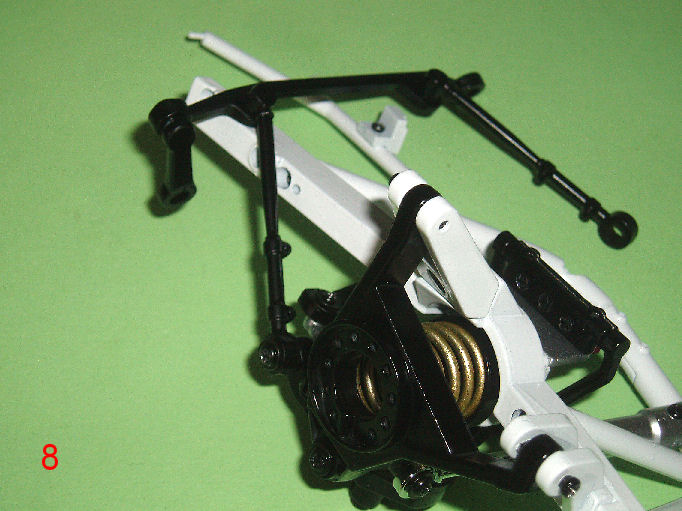

Pic 8: Fit the suspension tether 24D as shown.
Pic 9: Compress the spring and fit the tether over the top mount as shown and fix with 1 x FM screw.
Pic 10: Fit the lower shock absorber piston 23E into the upper part 23B and fix the lower piston to the suspension arm with 1 x FM screw.
Pic 11: Fit the anti-roll bar bracket assembly to the lower arm as shown and fix with 1 x ADM screw.

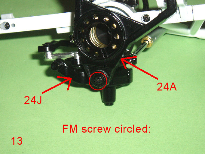

Pic 12: Fit the steering knuckle 24J into place as shown and fix to the upper link 24I with 1 x FM screw.
Pic 13: Turn the assembly over and fix the lower end of the knuckle 24J to the arm 24A using 1 x FM screw.
Pic 14: Shows the completed assembly.
Store all parts safely for now.

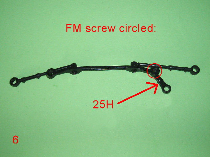

Pic 6: Fit the centre link to the assembly as shown and fix with 1 x FM screw.

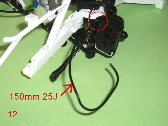

Pic 11: Cut the line 25J into 2 x 150mm parts.
Fit one of the lengths to the pin on the end of the caliper as shown.
Pic 12: Fit the other length of 25J onto the pin on the other caliper.
NOTE: The printed instructions suggest joining the two calipers together with one piece of tubing which is impossible as the 150mm tube is not long enough.
The instructions also make no use of the second 150mm pipe.

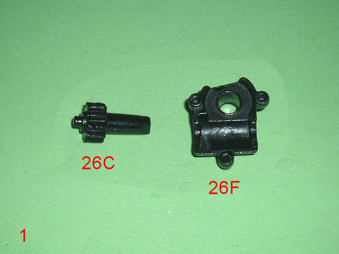

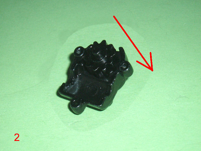

Pic 1: Locate the steering box parts 26C and 26F.
Pic 2: Fit them together by sliding the long shaft on 26C through the hole in 26F.

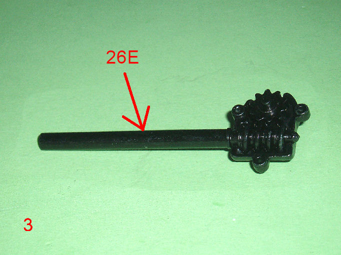

Pic 3: Fit the long steering arm 26E in place as shown.

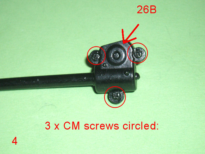

Pic 4: Fit the outer cover 26B to the assembly and fix with 3 x CM screws.

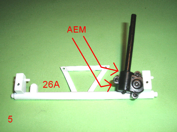

Pic 5: Fit the assembly as shown to the anti-roll bar 26A and fix from behind with 2 x AEM screws.

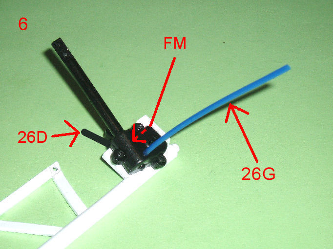

Pic 6: Screw the steering arm 26D to the rear of the steering box 26C using 1 x FM screw.
Press-fit the fluid hose 26G to the pin on the steering box 26B.

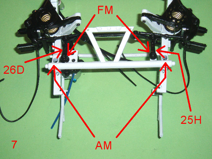

Pic 7: Fit the assembly between the two sub-frame sides as shown.
Secure using 2 x AM screws.

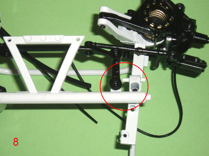

Make sure the links 25H and 26D are in line with the fixing points on the anti-roll bar 26A as shown and fix using 2 x FM screws.

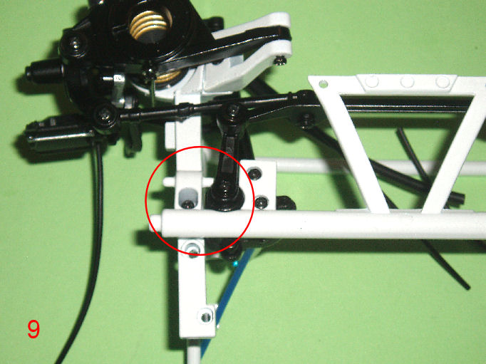

Pic 8: Detail of both fixings on one side.
Pic 9: Detail of both fixings on the other side.

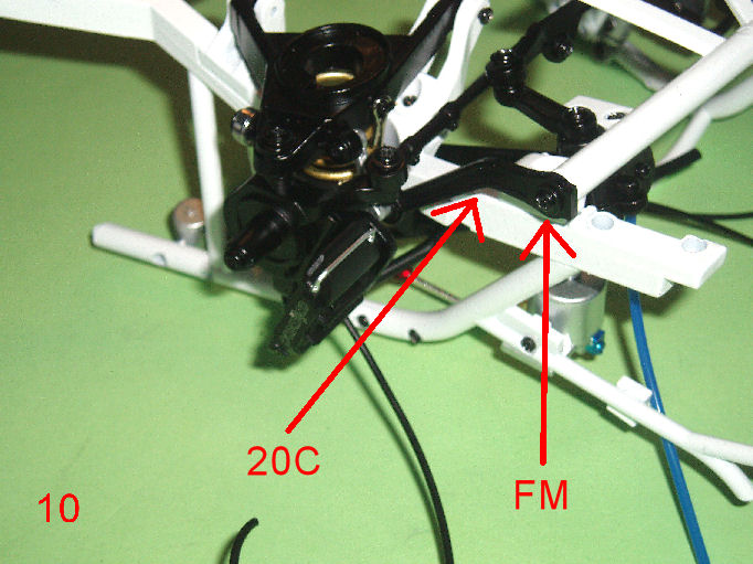

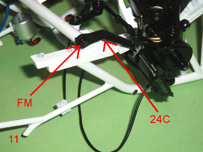

Pic 10: Fix the anti-roll bar arm 20C to the anti-roll bar 26A and fix with 1 x FM screw.
Pic 11: Fix the other anti-roll bar arm 24C to the anti-roll bar 26A and fix with 1 x FM screw.

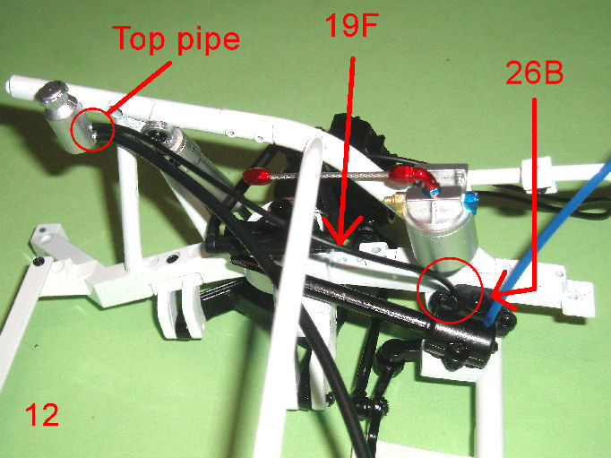

Pic 12: Connect the thin fluid pipe 19F to the pin on the steering box 26B.
